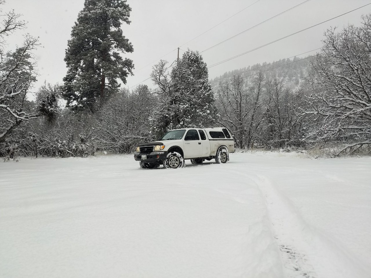

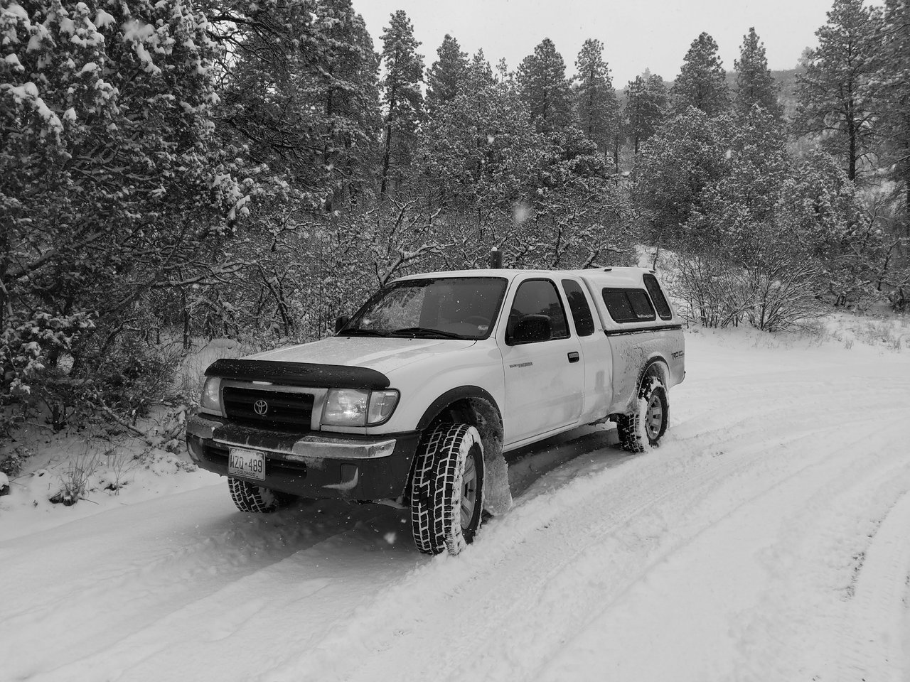

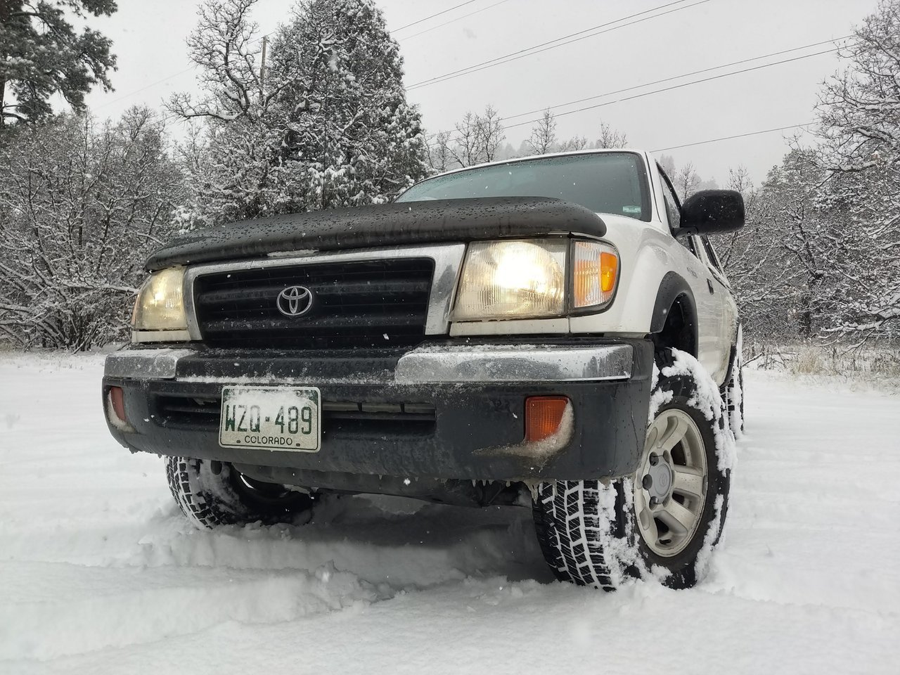

    Played around in the snow a little bit.
    These were taken after I slid into a ditch at 30 mph. Amazed that I didn't do any damage to the truck.

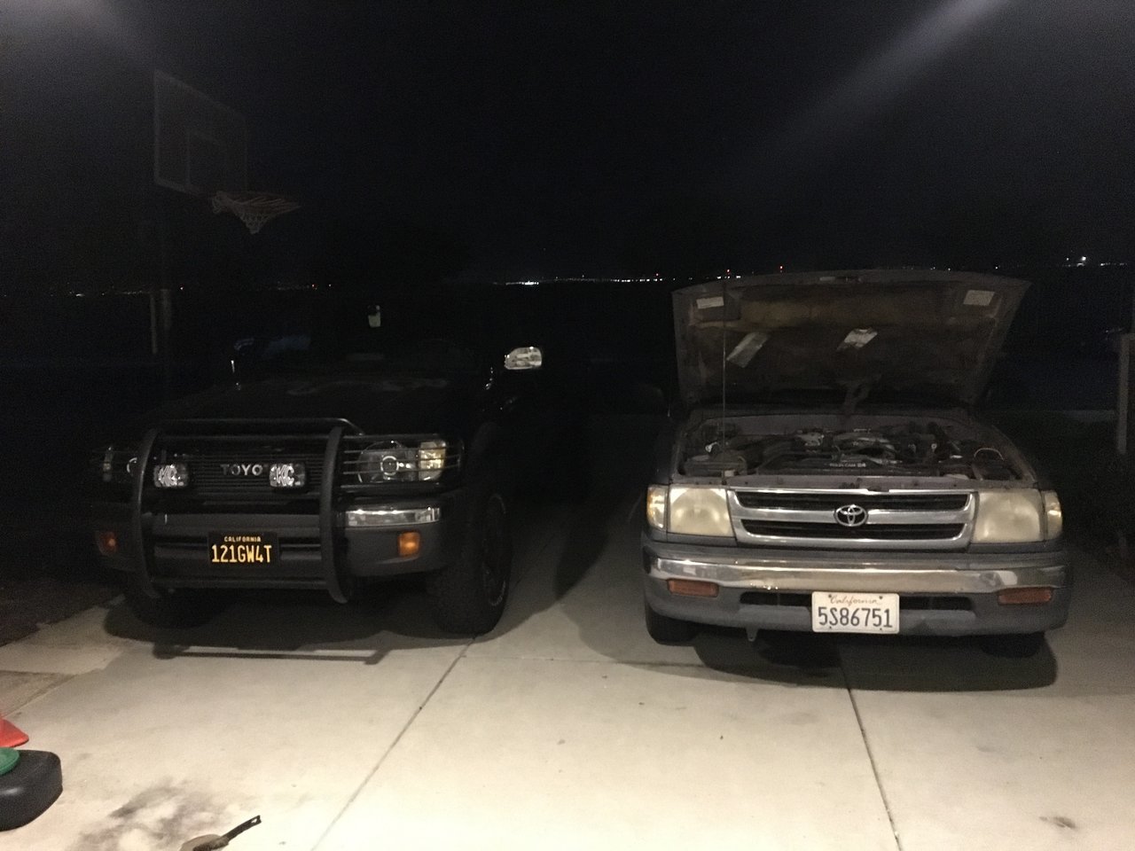

    What a stark difference. Mine started looking a lot like the crap-mobile on the right when I first got it.
    Would like to add these are both 1998's. Only difference between the cabs is the bumpers and the 5-lug frame.
    The other one also went 350,000 more miles than the other one.

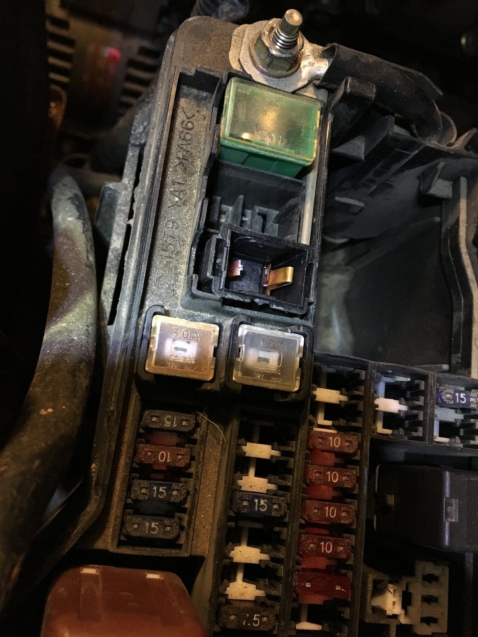

    Well I changed out the battery posts and cleaned the hell out of them. Tried a new battery and still have the same problem.
    Gonna try pulling fuses now. There's also this big ass broken positive cable that's just cut? No idea what it's for.

    Well I'll be damned... The 30A power fuse is blown.

    Bet that cut wire is what shorted it out, what fuse is that for?

    It has to be a main power fuse. It's rated for 30 Amps. I have no idea what that cut wire is for or what that fuse is for I'd have to check the manual really quick.

    Should say on the inside of the fuse box cover

    I misread. It's an 80 Amp fuse for the ALT which is Alternator I assume?
    Now how do I get that burned fuse out? I keep pulling on it but the plastic is so brittle it just shatters.
