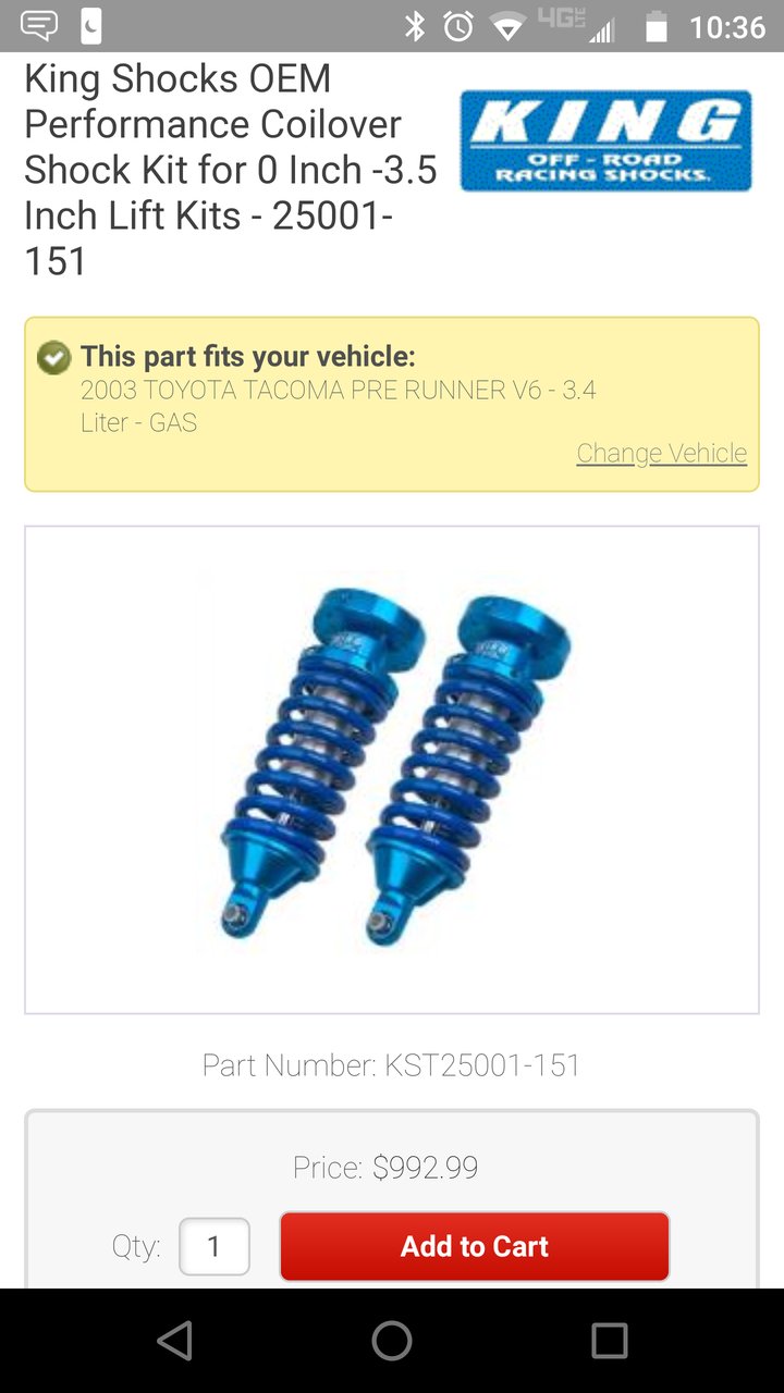

    are these different than MT?

    Yes

    get the extended droop version use with aftermarket uca's.
    unless you plan on haveing a winch and plate bumper you dont need the 700 pound coils

    So from my understanding there’s a little blocker (not the technical name) inside the shock, that blocker thing can be removed giving the shock more down travel making it an extended travel shock. I’m pretty sure the stock replacement shock and the extended travel shock are the same part number too. It should say something about extended travel in the name, it’s been awhile since I looked.
    I don’t think Kings are overkill for Forest roads, I have them, but they do come with some more fine print, like they should be rebuilt every 30ish thousand miles. Extended shocks need aftermarket UCA’s, but either way if you plan on lifting over like 2.25-2.5” you should get Ucas to keep all your alignment numbers in check, from my understanding.
    Tons of people rock the Ome stuff too and use their trucks on a lot rougher trails than me. It’s teally just depends on what you want to spend.

    Correct. Only difference between an oe travel king or other brand of coilover is a small nylon spacer.
