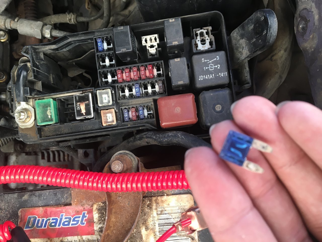

    I just pulled the EFI fuse and its burnt. Makes sense that the fuel injection system isn't work. Let me put a new fuse in.
    There's something in this truck making my fuses keep shorting.

    The Crapmobile is ALIVE!
    Turns out the EFI fuse was burned too. Makes sense - no fuel to the engine would cause it to well, not start.
