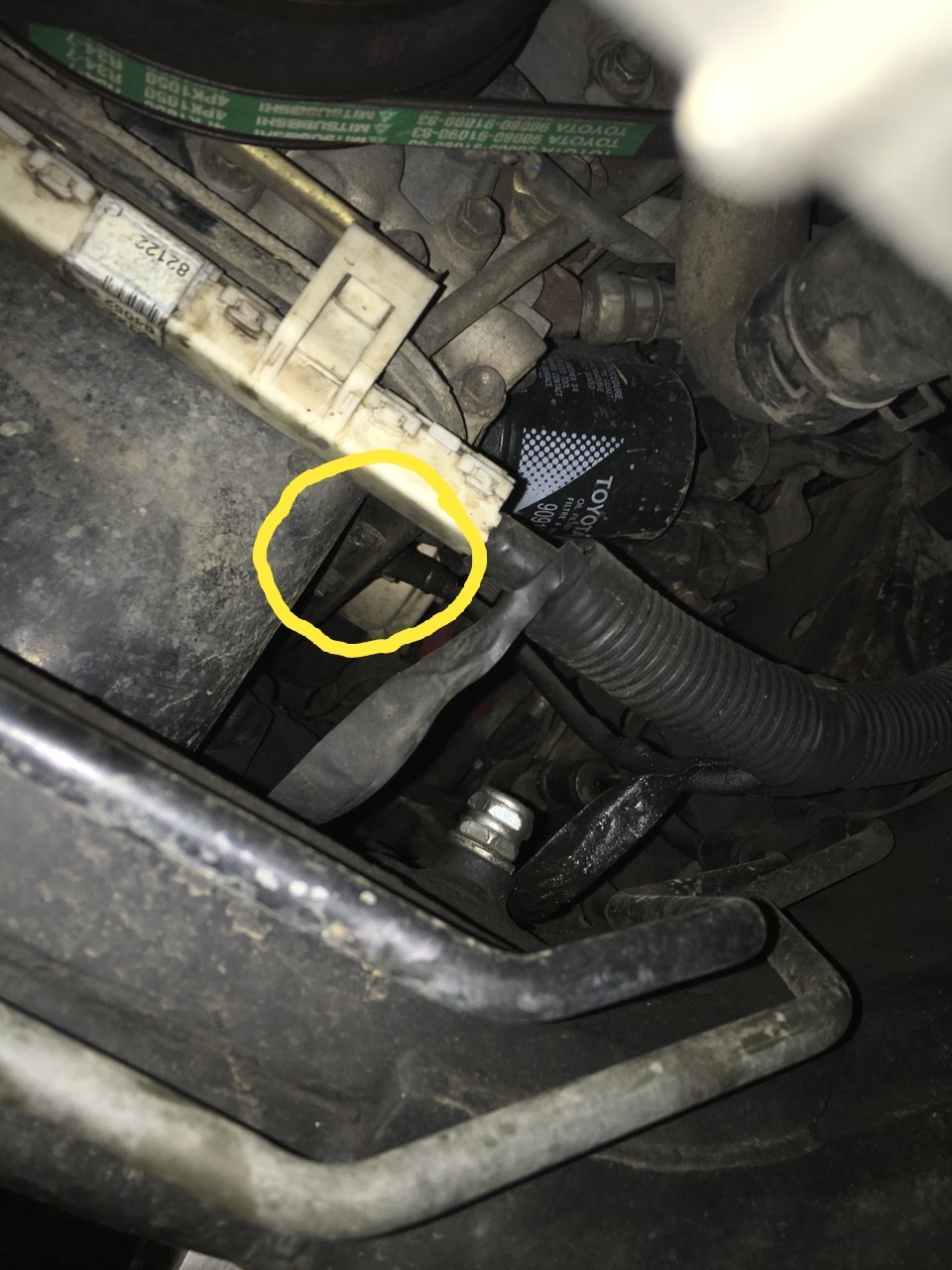

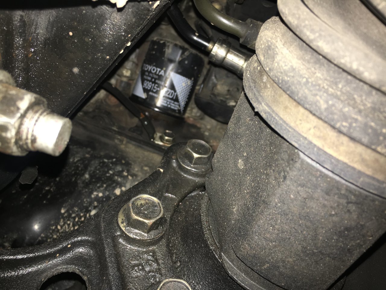

    Does it screw on somewhere? I can't seem to see it

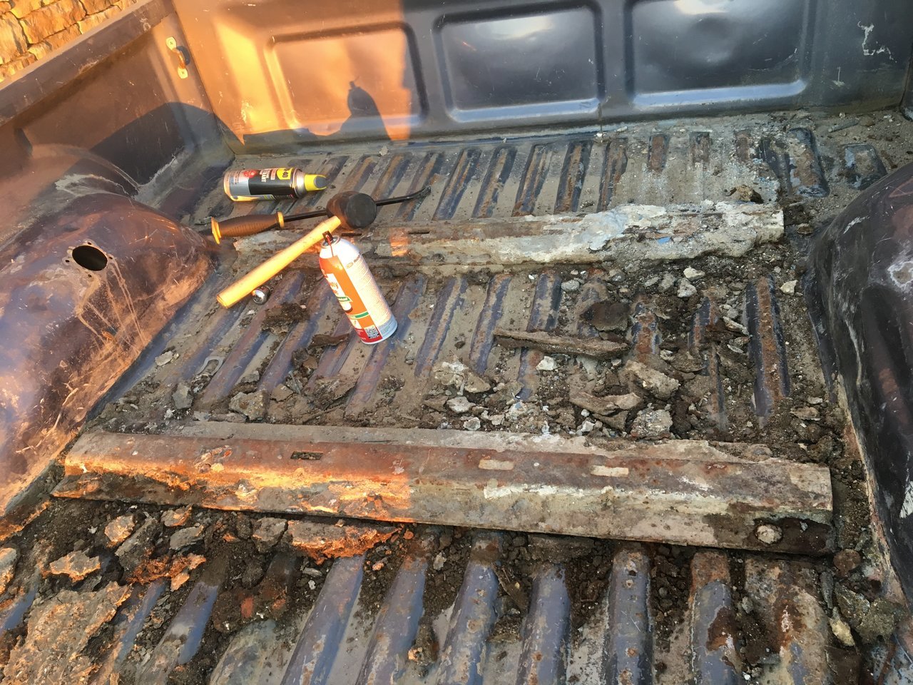

    Whoever had this truck from 1997-2015 and drove it 400,000 miles had it registered to a company. Probably why it has two heavy gauge steel cross members going under the bed to hold a fifth wheel.
    And whoever had it after that abused the hell out of it because there is cured concrete throughout the bed and a whole bunch of manure and garbage.

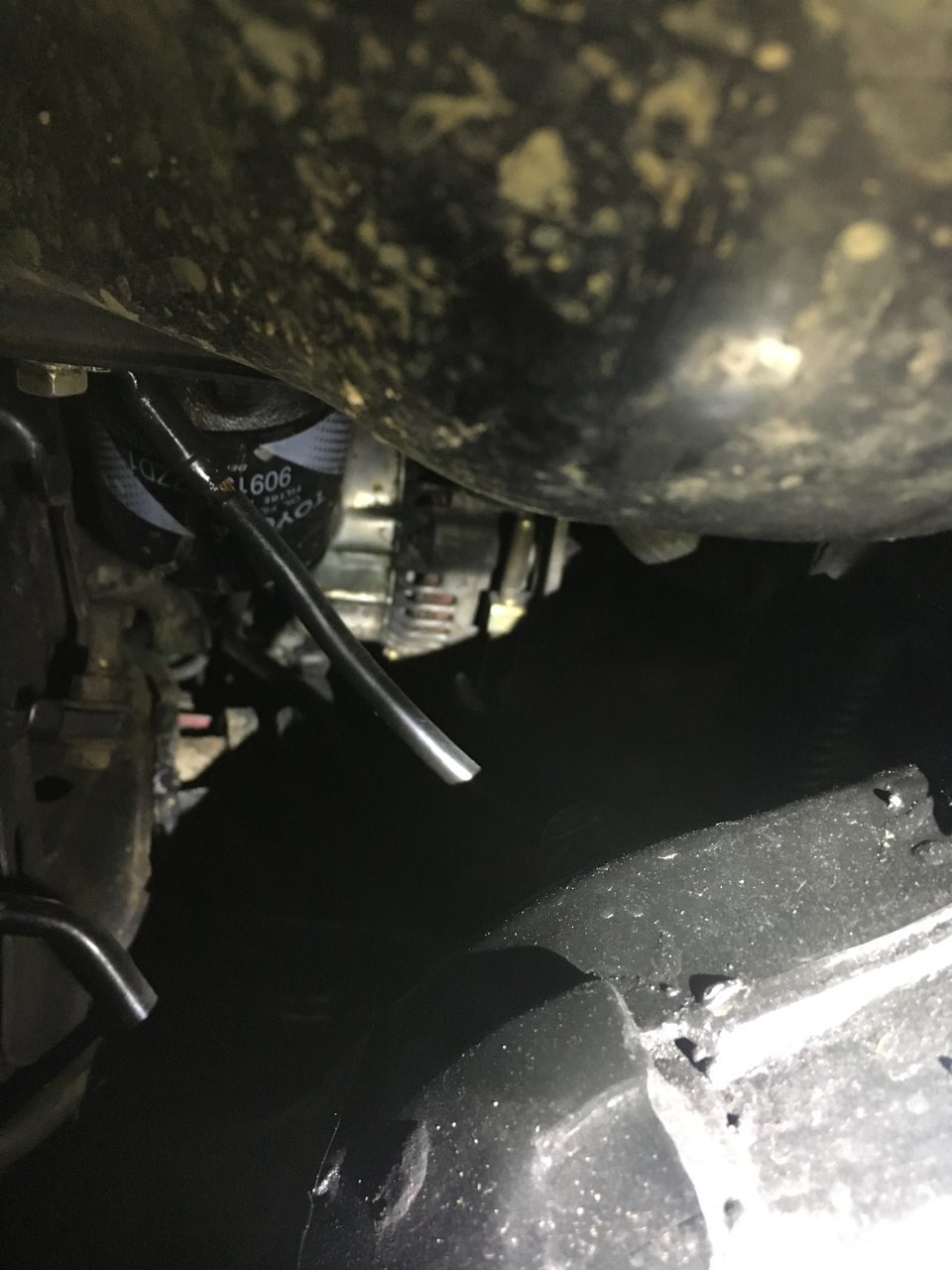

    Here’s soMe better pics
    7DA28644-CC08-4F0A-9EA4-0AAA9114BE4A.jpg EC6145D9-5931-496B-ADCD-1026D225962A.jpg CF59B9E4-FD38-4A3E-AEFC-116E1A0AC63D.jpg 8DB52A4B-64EB-4203-9116-9AD2C500FFF7.jpg

    Oh I see it! I'll have to go check the truck when I get home. Thanks!

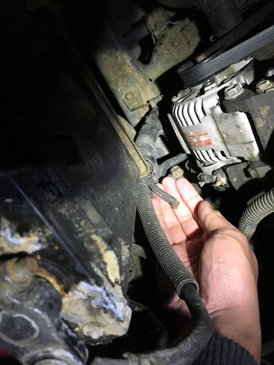

    Now what's the best way to reattach a wire to this - it's too thick to solder and crimp. I have no clue.

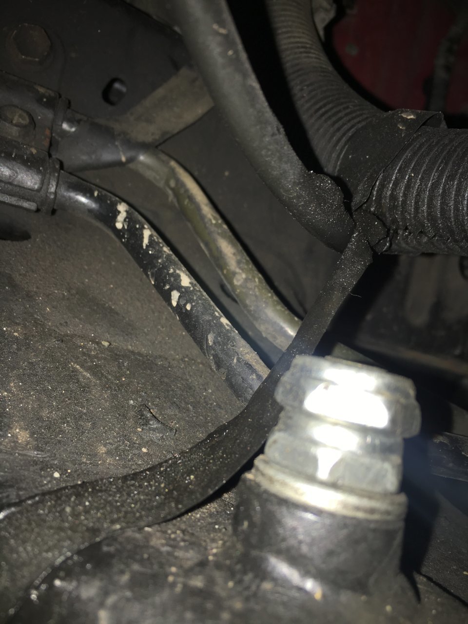

    I wouldn't reattach to that, too short it would pull apart and the open end means it has been corroded too. If you have a hydraulic crimper you can make a new cable with some 6ga or 4ga and copper lugs. If you measure I can crimp and send you one too.

    Mine is a 4x4 V6, so not sure if there is a difference, but here is what mine looks like...
    From @BartMaster1234 picture it looks like it is from the battery negative post....

    @BartMaster1234
    What is the negative terminal on the battery attached to?

    One wire goes deep into the engine which is the heavy gauge wire and one grounds on the fender.

    I have a weird feeling that ground Cable is causing everything to keep burning fuses.

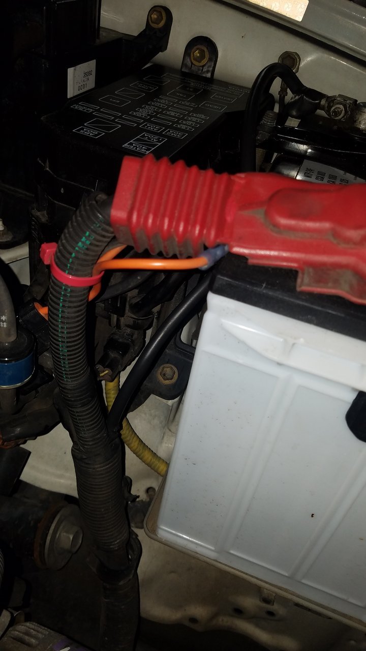

    If you look deeper into the positive Harness there will be a 'Y' in which one wire goes to the positive post and the other one is cut on my truck

    The one that goes "deep into the engine" should be the ground to the block where @buckmaster243 shows in his pics, below the oil filter. Trace the wire that comes off the negative and find out where it goes. It's possible that someone cut it and ran a new wire. The only other wire that I have that comes out of that loom in that location is the positive to the distribution/fuse box.
