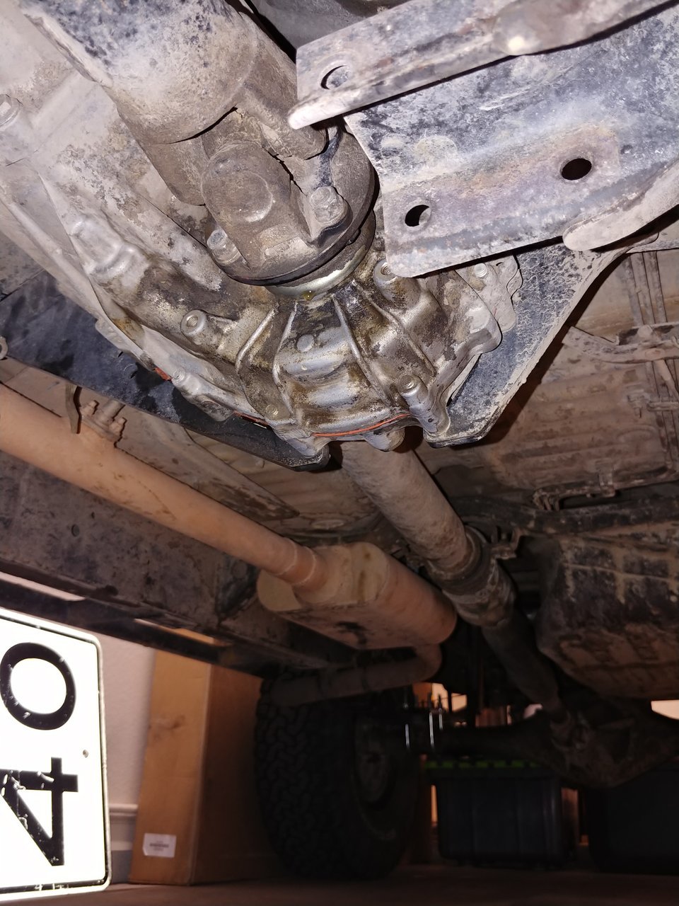

    #126307
    1,591
    Phoenix

    Does this seem like too much play? Sorry for the shitty video, had to hold the camera and a flashlight and wiggle the DS. https://youtu.be/4HyhUaaHxRA

    That looks like a shot carrier bearing. But you should also check the u joint right by the diff. That is were the seal blew out.
