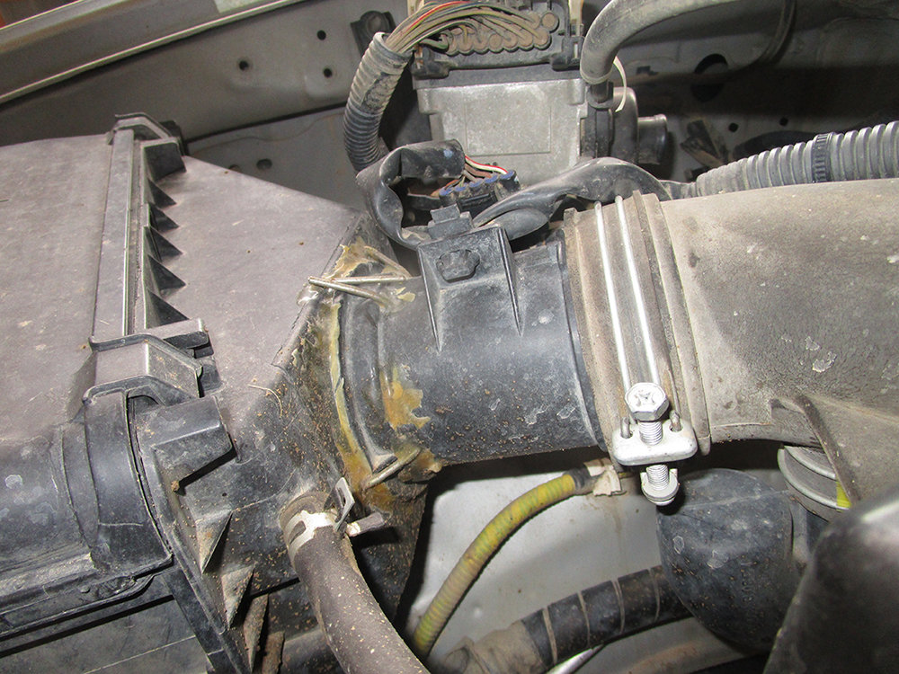

    The tube broke off my airbox. Probably too many rough roads. I priced a new one, and then decided to fix my old one instead. Here is a photo of it. Did the repair several years ago, still holding up.

    You guys are making me glad that my airbox has its tube bolted on haha..

    Yes epoxy, stuff labeled for use on plastic. I think If I was to do it again I would probably just used some calking, or silicone sealant. Wire holds it together the epoxy just makes it air tight. The wire is just coat hanger wire. I drilled holes in both parts and fed the wire through from the inside.

    I had mine for over a year now and no issues. Not lining up perfect I understand but they are rubber mounts for those bolts so a little bit or prying makes it work. They are a cheap plastic too. To each thier own. :thumbsup: hopefully I’ll be able to upgrade to a cylinder style air filter I’ve seen LT guys run. Still researching it tho.
