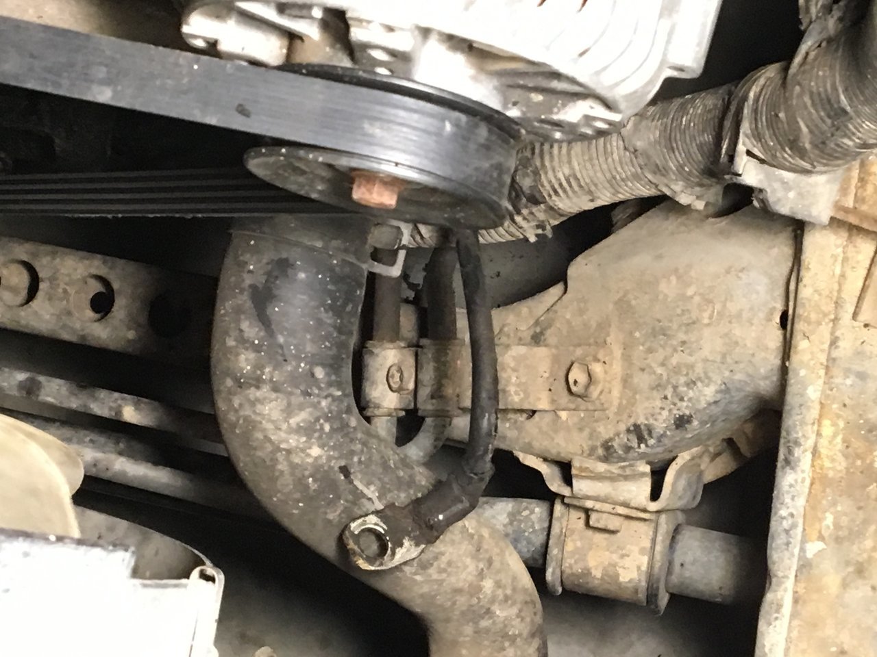

    So I found the rest of that ground Cable. It wasn't attached to anything after all.
