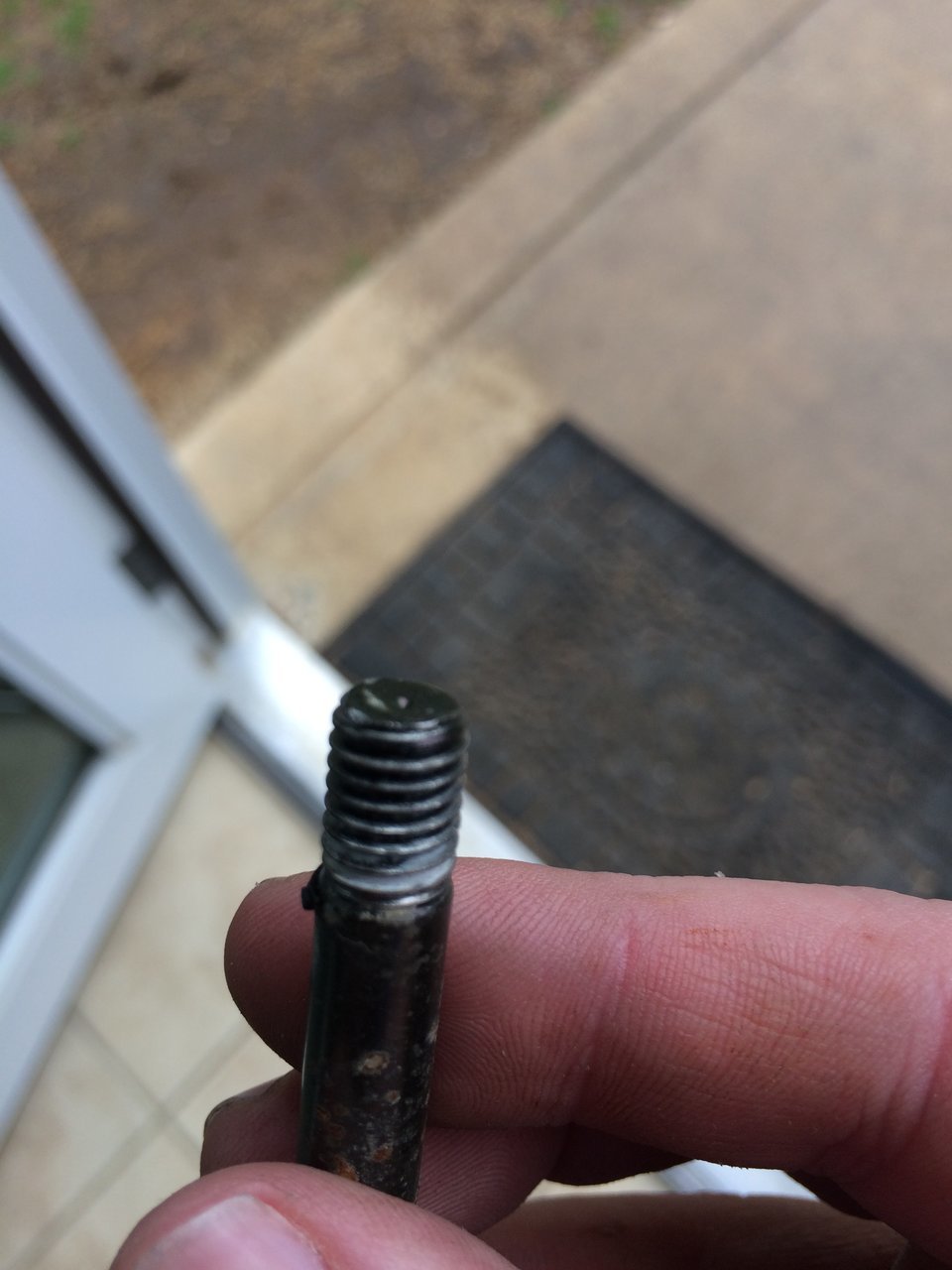

    Replacing the radiator today, figured I’d pull and check or replace the thermostat. First bolt I try can’t budge it. Worried I’ll break it but I’ll never have as much room to work with as I do at the moment.

    I knew I shouldn’t have done it.

    At least the stud didn't break off flush

    Did you lose all the threads or only a couple. It may still thread in and it isn't holding much so you'd be fine if it does.

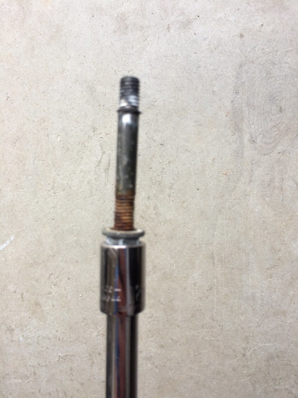

    I’ve got about 1/2” of threads:

    That should be fine, just holding the tstat housing. Don't over tighten it and use a wee bit of antisieze so it doesn't do that again. Use a paint pen to make sure it isn't backing out.

    Doesn't look snapped to me looks as if it threaded out. I bet it will go back in
    wilcam47 and SwampYota[QUOTED] like this.

    Thanks man. I didn’t even think about the paint pen idea. I’ll make sure to antiseize the three bolts. Haven’t gotten to third one. I think I’ll use some PB Blaster on it as @RedManRocket suggested so maybe I can go 2 for 3 on these.

    looks like a normal stud to me also..otherwise there would be a clean spiral break on the end...ask me how I know ;):anonymous:
    this is sheared ;)

    Eesh. That was my immediate thought when it broke loose all the sudden. It’s a sickening feeling.
