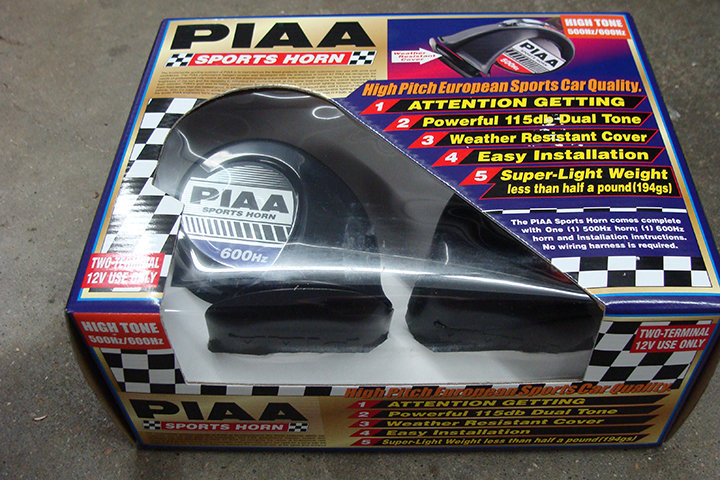

    I recently acquired an 01DC and I'm embarrassed to use the stock horn,
    sounds wimpy & apologetic.
    ... but I have a fix for that :D
    If anyone wants a stock 01 horn, pm me.

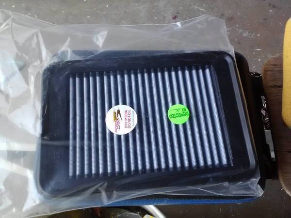

    Just got done installing an afe pro-dry s air filter. read about it in another thread and liked all the reviews it had so went out and got it.

    :cheers: Have been very happy with mine thus far.

    Can you clean and re use the that filter like the k&n?

    Yep, and no need to oil.

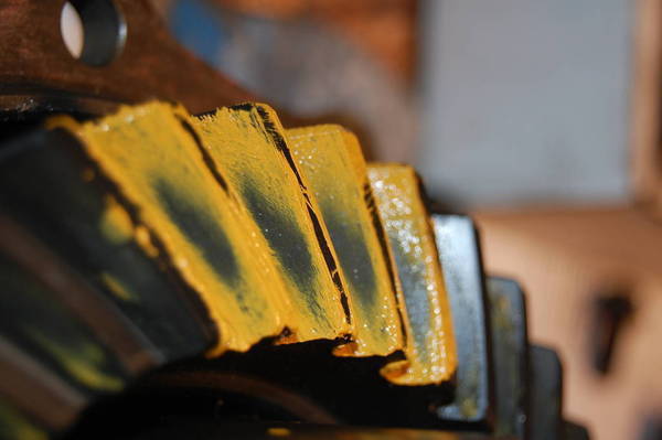

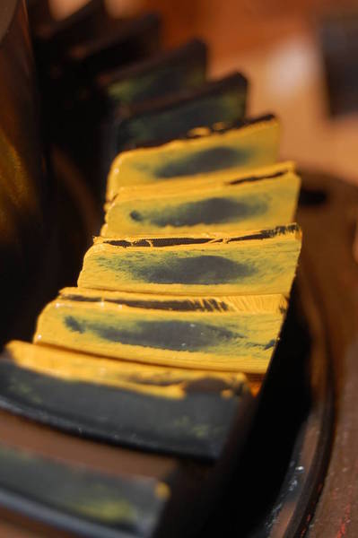

    Nearing completion on my 7.5 clamshell regear and ARB locker... What do you guys think of this pattern? I like a little deep for strength but is this too deep? Wondering if I should take out about .001" of shims behind the pinion head or just leave it. I think I'm just gonna leave it..

    Dude I think you're one of the only people on this site that know how to set up gears lol. I would post that over on TTORA if you haven't already just for some more opinions.

    x3. not bad for a galloping green dildo. That pattern looks dead on, according to other pictures I have seen about it and not my own experience. :thumbsup:

    Looks right to me, id leave it as is.
