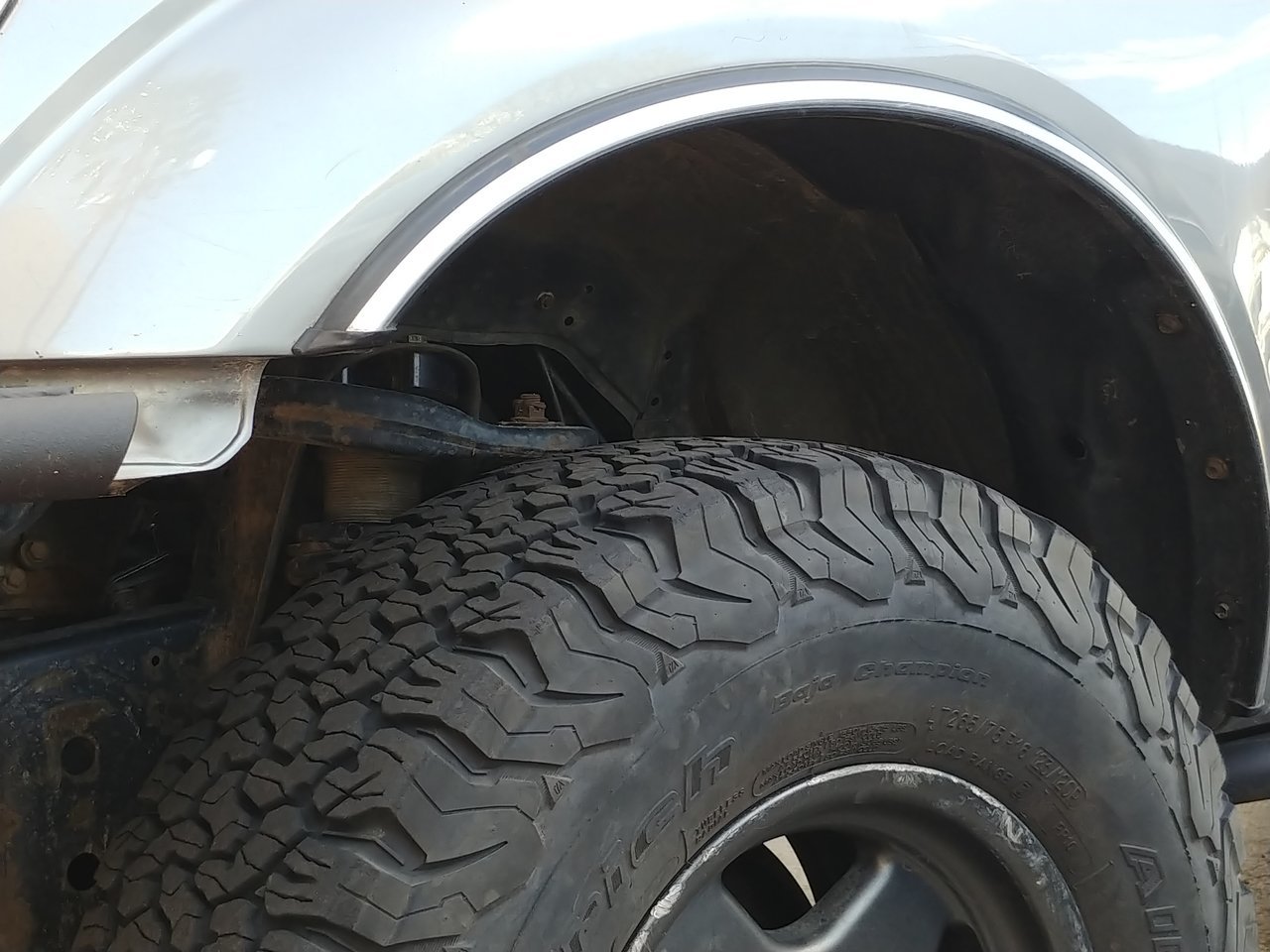

    Can you get a picture of your UCA at rest and at full droop with the Icons?, I'm trying to figure out if I need UCAs with sway-a-ways, no rush tho i'm still waiting on my rebuild kit for them :turtleride:

    Yeah, I've got to pull them out tonight to take em for a rebuild so I'll get a picture when it is jacked up. Uniball or SPC UCAs are still a good idea but you can get by without them for a while if you make sure nothing binds and you can still align it.

    Here it is at rest, not sure how much lift but I'd guess around 2.25".
    Where did you find SAW coilovers? Are they the new AFe ones, 2.0" or 2.5"?

    Not very much then. I'm guessing you needn't worry but easy enough to check them.
    2 24mm wrenches (or a socket and wrench) to lift the arm off the spindle. Then you can check for play in the uniball. My new ones were so tight, I could not move them by hand, Had to put something like to long bolt or an extension through the center to move the center ball. As I mentioned, the old ones were a different story. Very easy to move around. So loose they would rattle if I shook them. Hope this helps.
