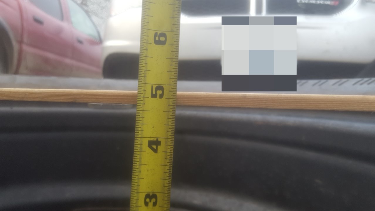

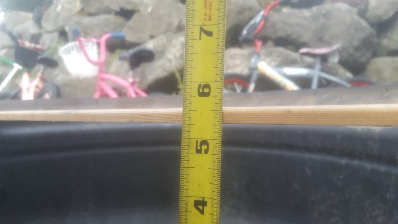

    04 to 05 have different back spacing. 1st gen vs 2nd gen

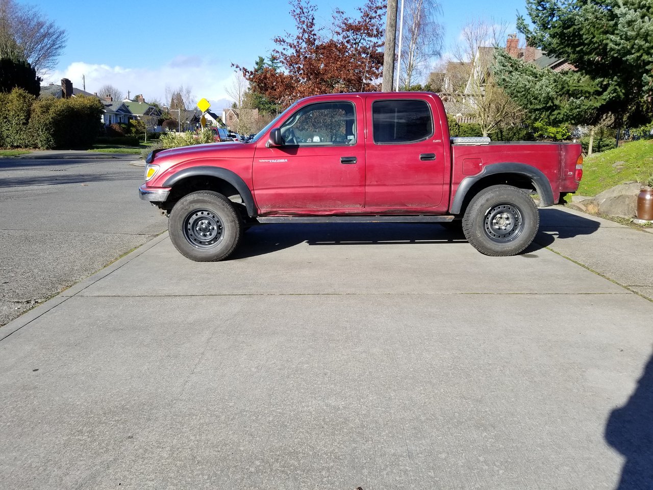

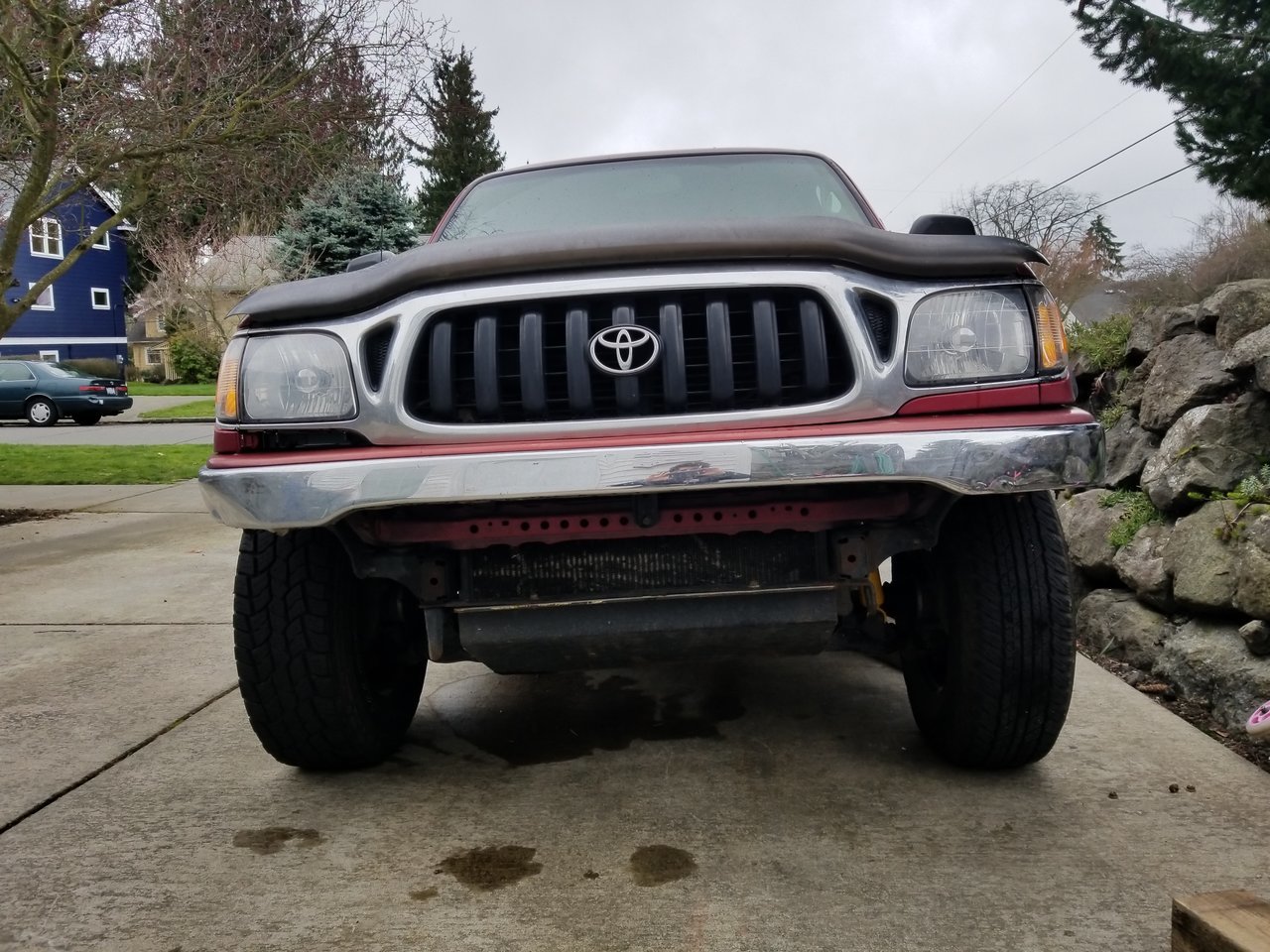

    Thanks Jon good to know.
    Finished slapping in some new shocks and springs on the front. Pretty sad the old front suspension was sagging 2 whole inches. It was a half inch from bump stops sitting still. It was super nice assembling them out of the truck.
    In the 1year and 4mo I have owned the truck, its racked up 33,847mi!!!
    Now Im dealing with what might be a clogged radiator, either way I will spring for a 2.4L aluminum radiator and new hoses.
    Now just waiting on new tires to come in.

    Yeah I realized the different back spacing. I am confused on your 1st gen spares comment. 96-99 my 04 has the smaller backspacing. My wheels were not all stamped the same. So I measured hub dia and backspacing, the 4 i got all match my 04 spare. NOT the 05 spare with 5.25 back spacing.
