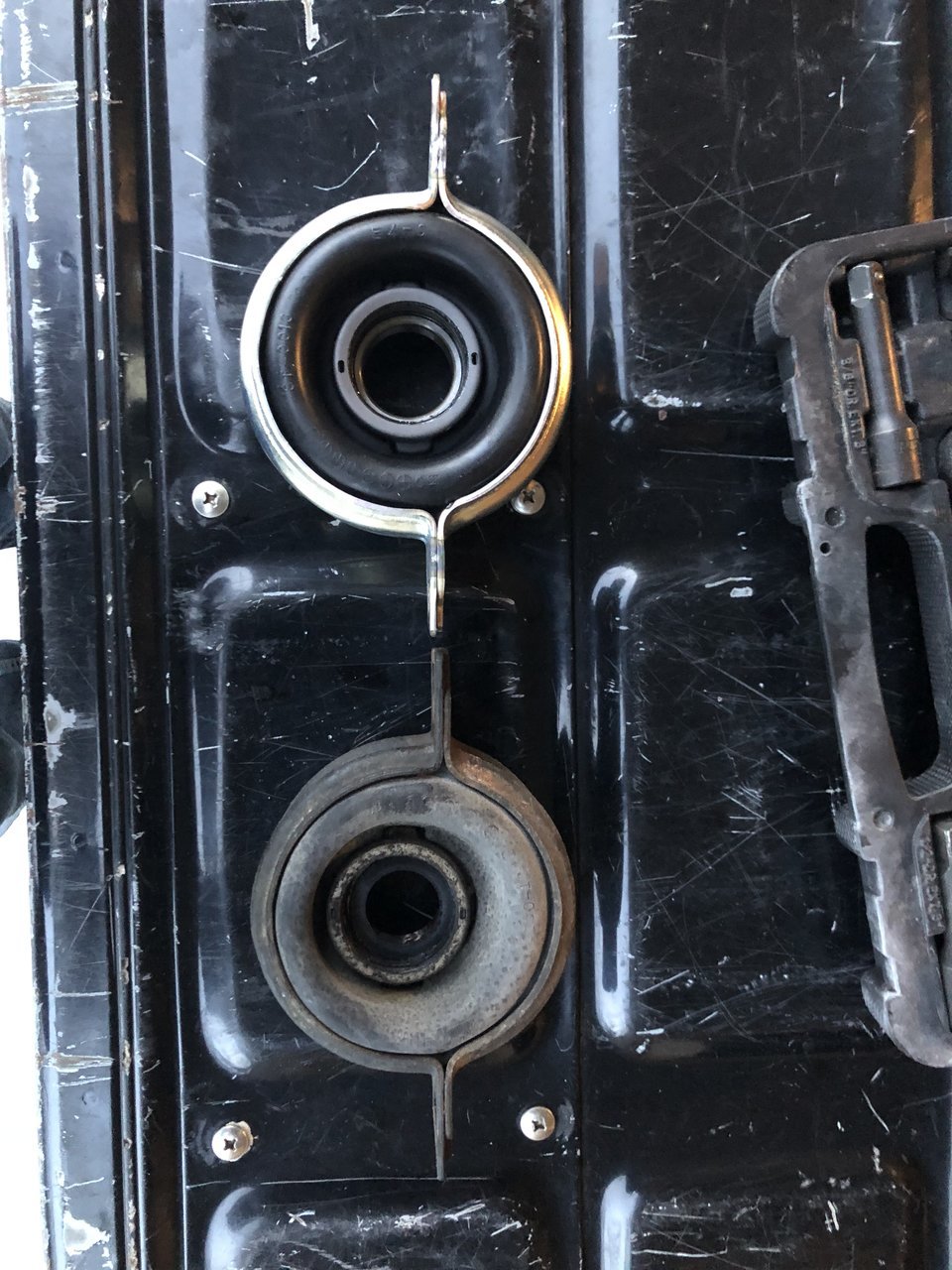

    Ouch. Replace both sides while you can. Bears, shoes, and seals.

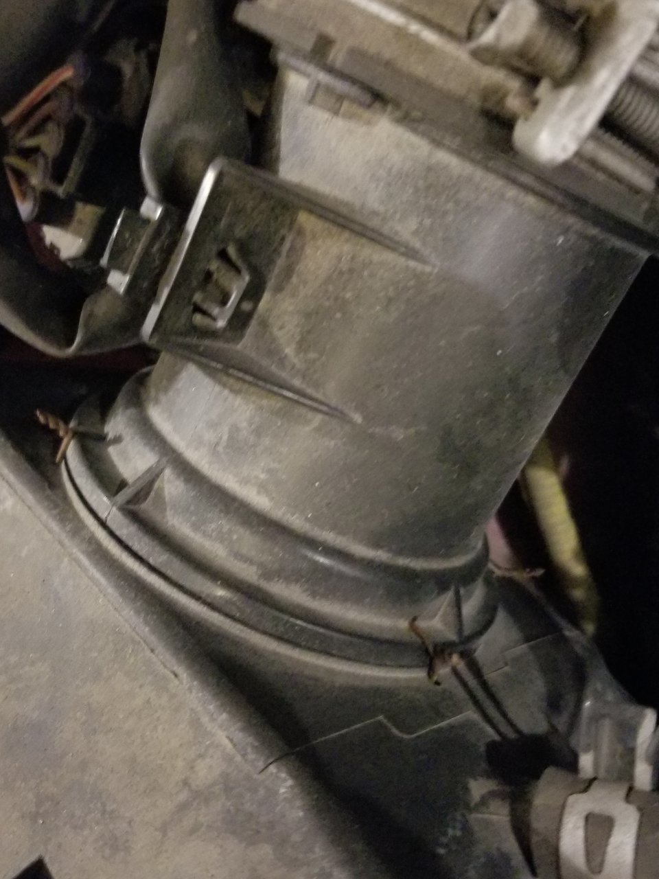

    I do believe I owe you some pictures. I've since added more cables and actually sealed it all up but you get the idea. This picture was taken a little over a year ago and i haven't had an issue since with it breaking off

    Did you check for all the extra long zip ties around your drive shafts???
    In all seriousness. Is it a tap "you can feel" or a click "you can hear". Dry rustes out joints will click as they move with the joint end slopping back and forth in the cap.

    Drain your rear diff completely. Look for chunks of metal.

    Click you can hear. I’m assuming it’s u-joints at this point.
    Diff was drained when I put the new seal in, no metal shavings or chunks were in there and it doesn’t sound like it’s coming from there.

    Pull the drive shaft and feel each joint for binding.

    I would still try and drop the CB a bit, it took 3- 3/8”” washers to fix mine. I guess you could describe the noise as a clicking, but both sides of mine got warm after driving a little. So maybe it’s not the same problem.
    Do you get vibrations when you go over 80 mph? Cause that’s when mine started to become reaaaally noticeable :anonymous:
    And the washers fixed it.

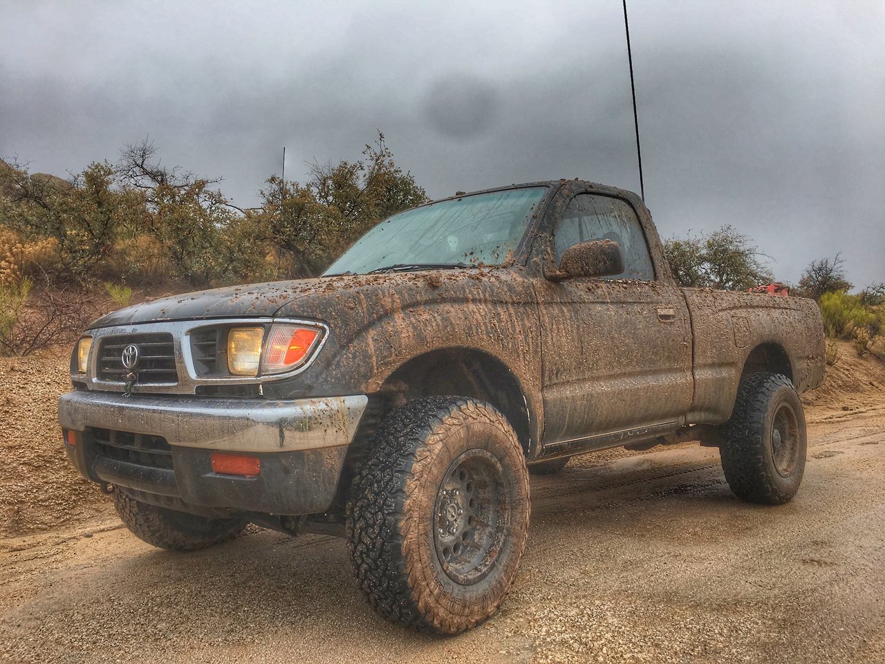

    Drove to the Powers Garden trailhead. Got her all muddy... what a grand site!
