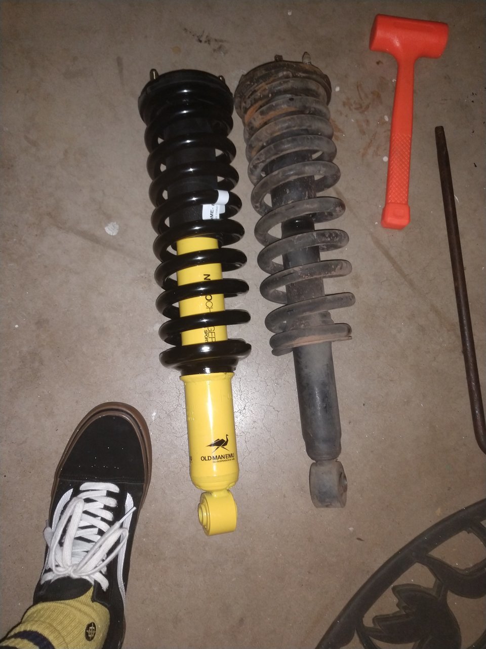

    So you did the bottom of the shock first and then the top? I know I'm supposed to compress with a jack but how compressed does the spring have to be??

    When I watched the video on youtube I thought this was the one they started with
    I'm trying to take these off, my OME shocks and coils are already assembled

    Then you only need to take the three nuts around the edge off.

    Ok so start with the 3 outside bolts, then the lower part of the shock that's connected to the LCA?

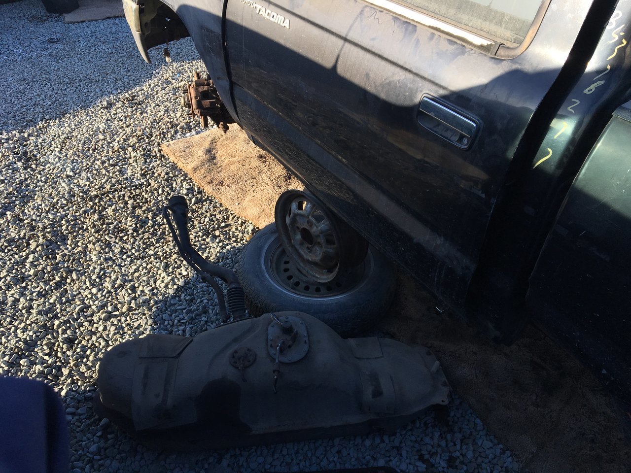

    Was deep into YotaTech, and found a DUALLY first gen. One of the weirdest things I've seen.
    Well not as weird as whoever put a fifth wheel hitch on my other '98. Who buys a compact truck to tow something so big it necessitates a fifth wheel hitch?
