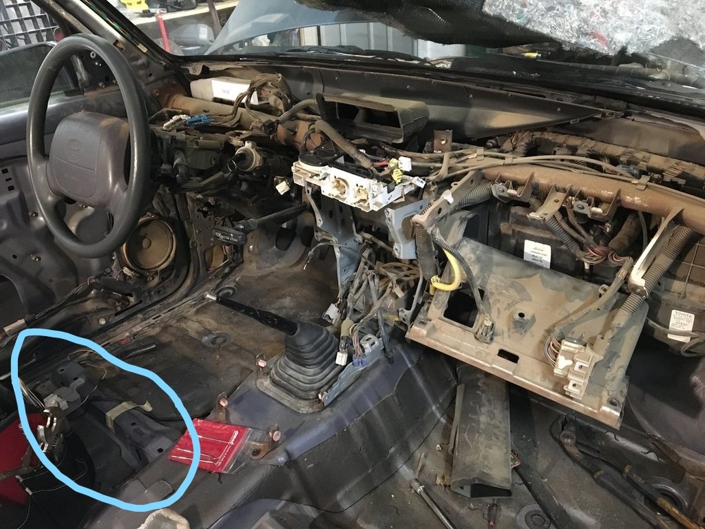

    Might I ask a favor? Can you look at this area and tell me if there is anything inside the cavity formed by that brace running across the floor pan? I have been thinking that if that "brace/reinforcement" was removed, I could drop my BMW seats that much lower, basically mounting their flat rails directly to the floor, which should lower them by a couple of inches. Right now I ride pretty tall. This might be a help to you when you start putting in your Lexus seats too!!

    Nothing is in there on my truck.

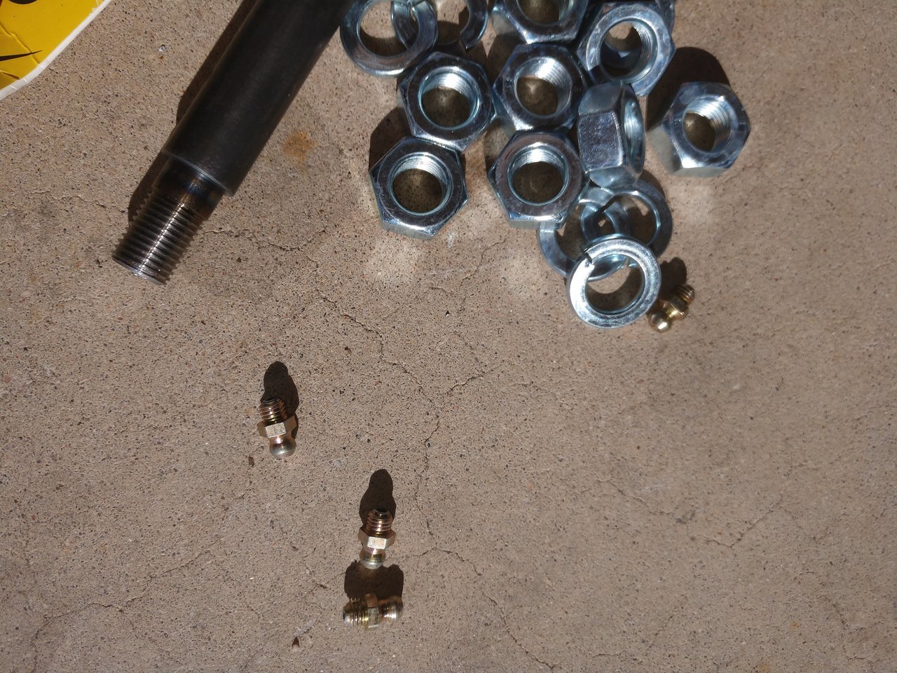

    What are the grease nipples function? Also How would I Grease the shackle pins btw I dont have a contraption to fill them IMG_20180223_103609368.jpg

    I believe those are Zerk fittings? You'll need a grease gun.

    get a grease gun. Super handy to be able to grease the bushings without removing the springs.
    The nipples screw in to the end of the bolts.
    When you pump grease in, loosen the bolts and then retorque them after greasing.

    alright picked up some Lucas Red N Tacky

    The bolt by the gas tank on the driver side is seized I think when I try to loosen the top leaf goes up and if I go in a tightening motion the top leaf goes down IMG_20180223_122339248.jpg

    Sawzall ftw. Mine was seized too. Dealer will have a new bolt, save the nut.
