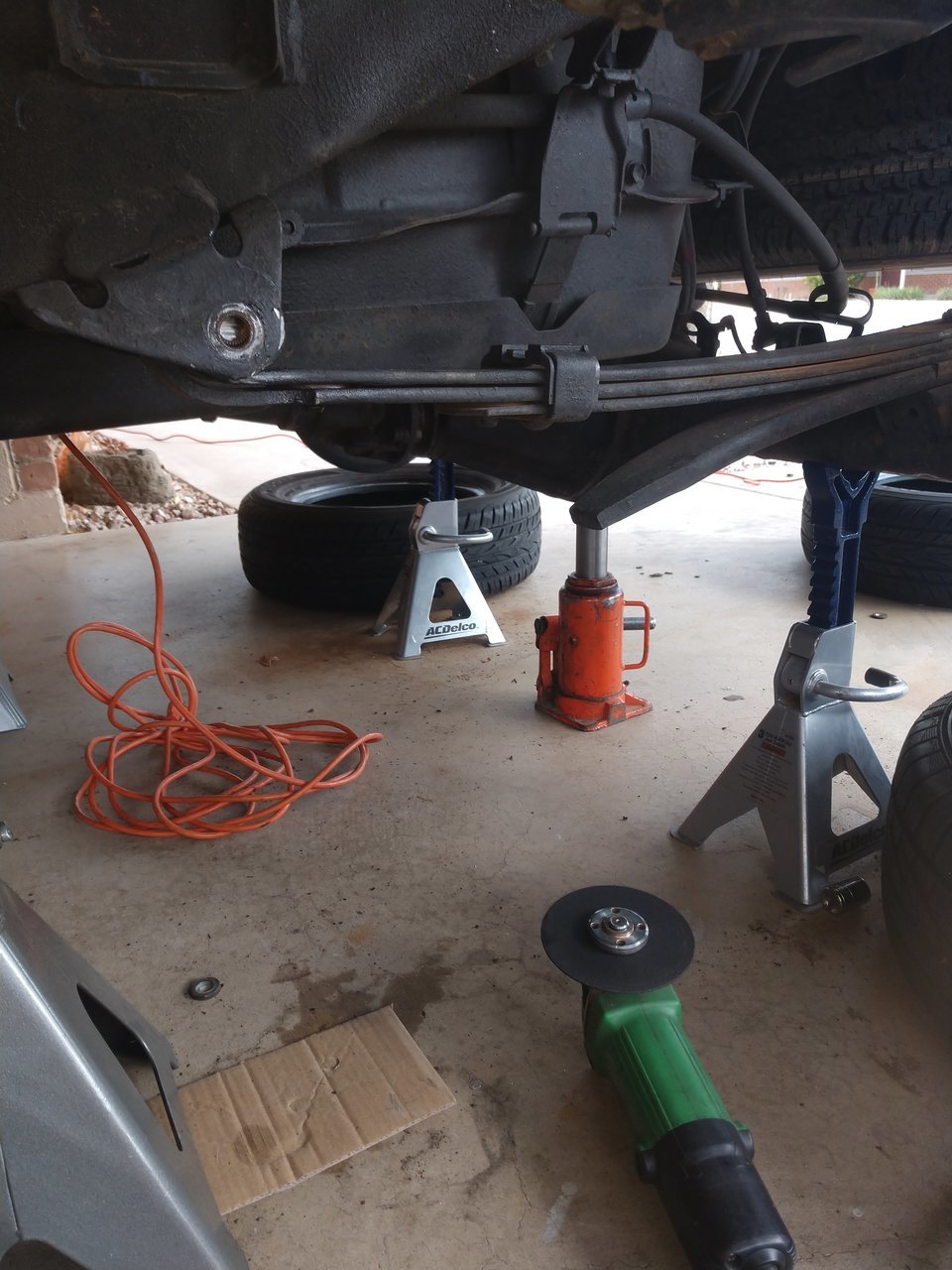

    I JUST replaced these with Daystars greaseable bolt and bushings. @Wheeler's Off-Road Inc
    What a F-ing pain in the ass these are.
    We went thru 5 sawzall blades for drivers side - watch the gas tank.

    Nvm Impact won't fix that. :rofl: I got lucky my original's didn't seize like that. My bushings did though in the back of the frame. Antiseize everything and replace anything you can with greasable stuff.

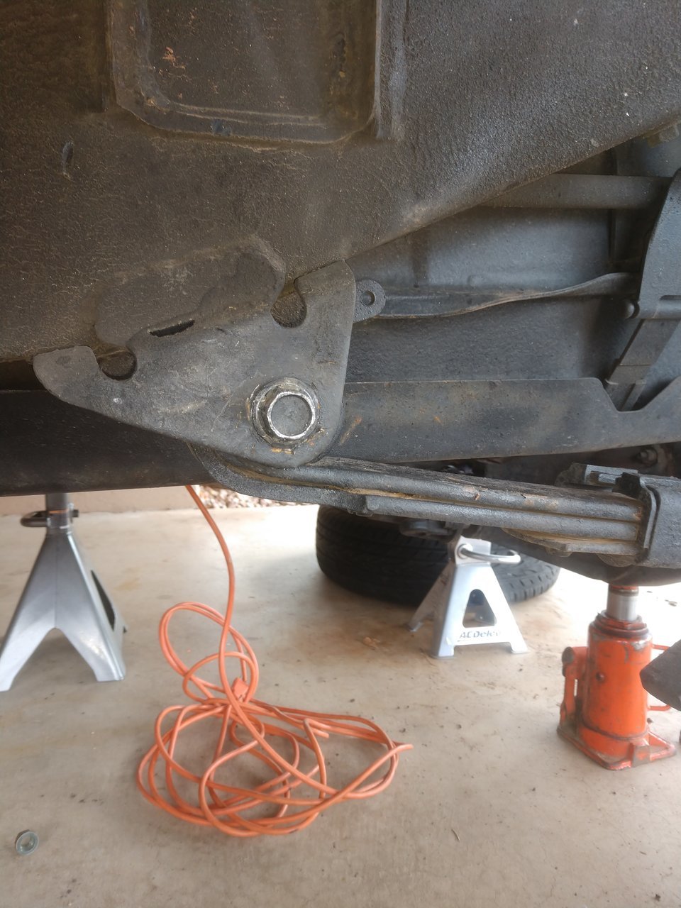

    I just used a big frigging wrench, mine came right off. The shackles are what kicked my ass, wound up having to hit them with a torch to get them out. You are using PB-Blaster or some other form of penetrating oil on these, right?

    Yeah just sprayed it down, going to go to my parents house and they might have a bigger wrench

    It's a 19mm, I suggest you grab a 19mm socket and three foot breaker bar, but if it is siezed even that won't help.

    I used a cut off wheel. WAY faster than a sawzall. However, more dangerous..

    Like others have said, Sawzall will do the trick, and carbide tipped blades made a world of difference for me when I went through essentially the same thing with the alignment cam bolts of the lower control arms.

    Both sides of mine were seized on my truck. I used a 4” or 4.5” cutoff wheel on a grinder and it worked well, but it’s pretty difficult to get to the inside of driver’s side bolt with the gas tank there. I ended up laying underneath the truck towards the passenger side and holding the grinder out in front and above me.

    Get your socket/breaker bar on the outside braced against the frame/body, then put the box end of a wrench on the nut on the inside, hook another wrench on that to extend it, then put some ass into it.

    I have a pipe wrench and an extension for it, if that doesn't worw then I have a cutoff wheel. Gotta get some Chick-fil-A real quick!

    I resulted to cutting mine out and buying newer extended u-bolts. Was worth the price over frustration of not having air tools myself.
