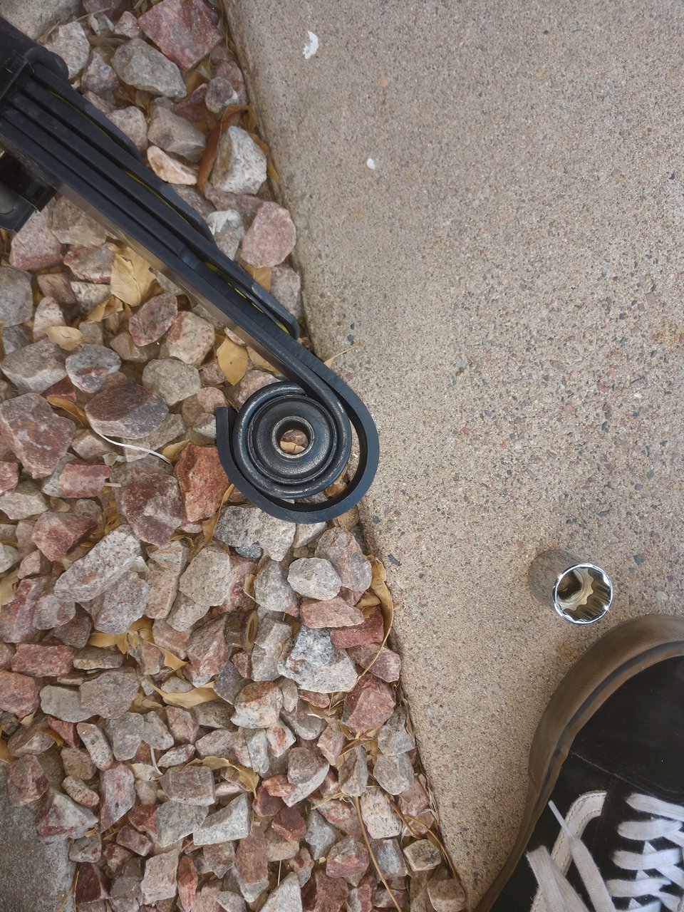

    Thanks for the help everybody I really appreciate it! I have 2 questions. How do I get this bushing out?IMG_20180223_165556568.jpg

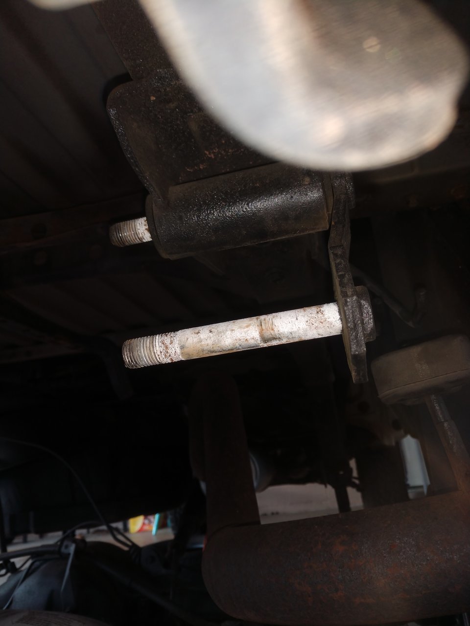

    And do these bolts come out or off? They're to the rear of the lead spring where the shackle goesIMG_20180223_165804023.jpg

    The bolts are attached to that hanger. Just hammer them out from the inside and be careful to not damage the threads.

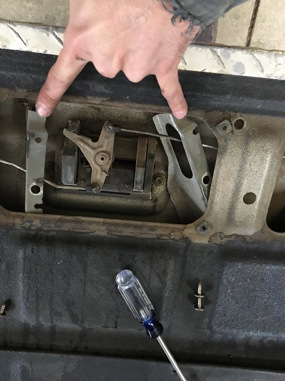

    Opened up the tailgate because the latch has been acting up and found these two brackets loose floating around.. where are they supposed to attach?

    Is it the shackle bolt or spring hanger?

    The front of the leaf spring bolt... might be a hanger idk

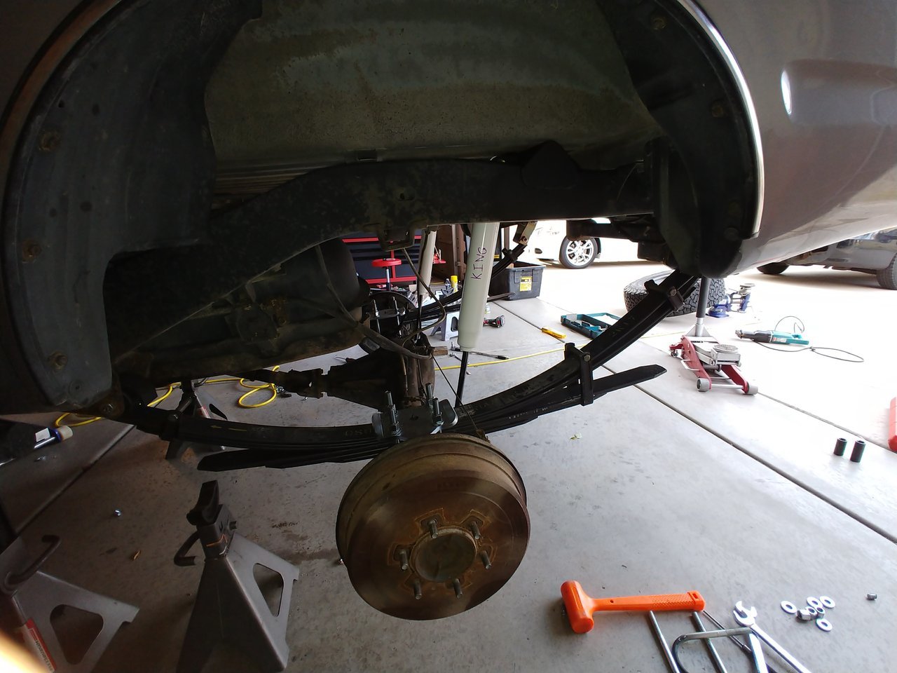

    So where do I put these 4 bushings at? Do the set of 2 go on the rear shackle? None go in the front?IMG_20180223_173348862.jpg*Added image

    Grade 8 will be fine
