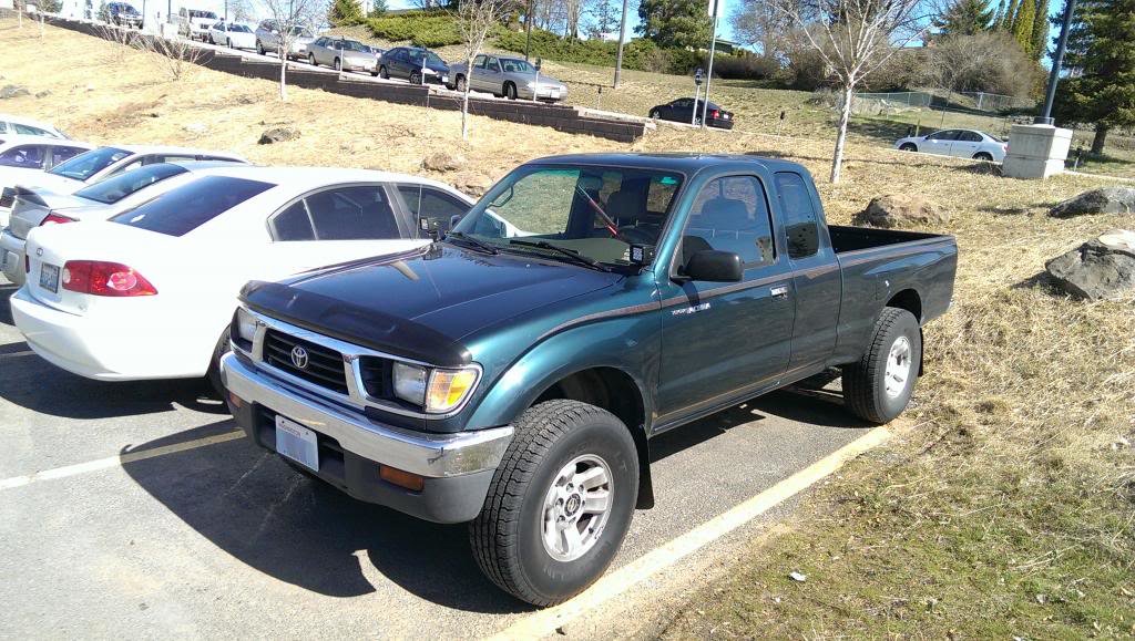

    Is this relatively high...
    That is stock in that picture, any weight would have sagged it below the concrete haha.
