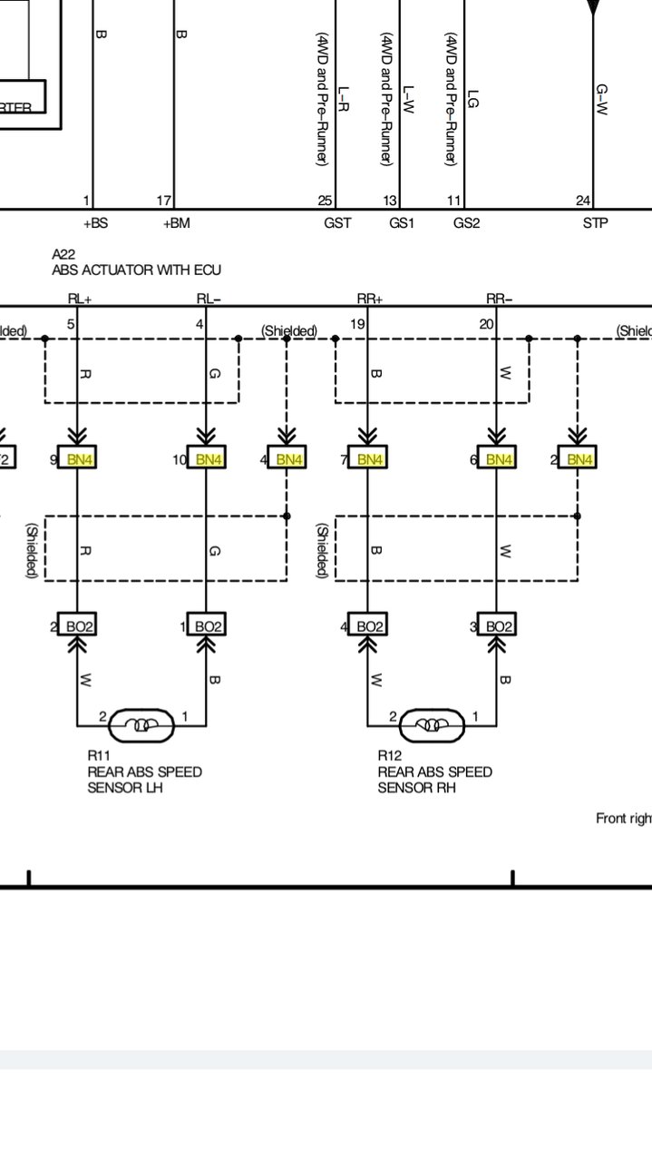

    Doesn't appear any of the ABS goes through BN4

    I believe BN4 changed to BN7 at some point, probably 01. It is most likely the same exact connector with a new name.
    Here is a shot of the overall wiring diagram from a 99.
