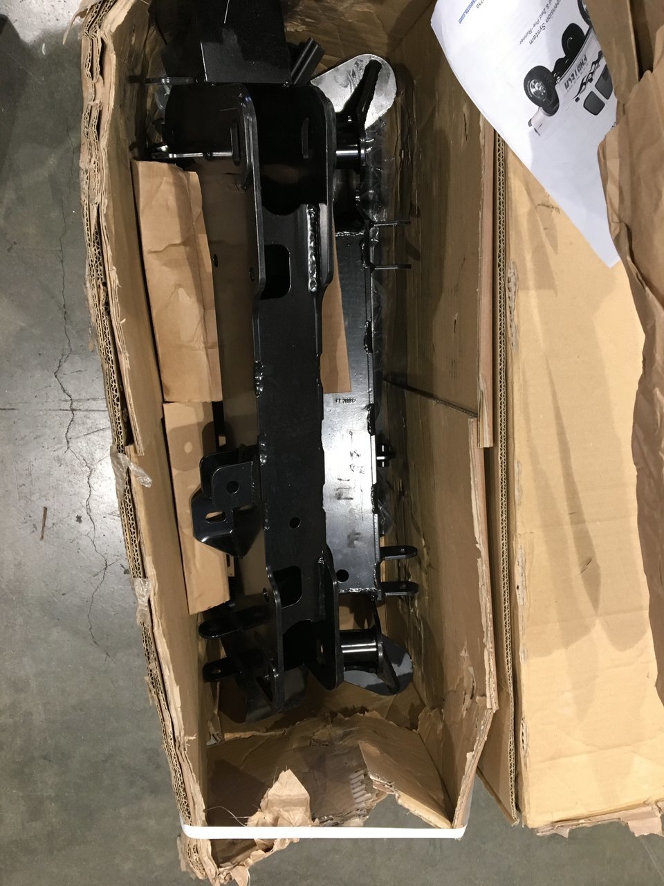

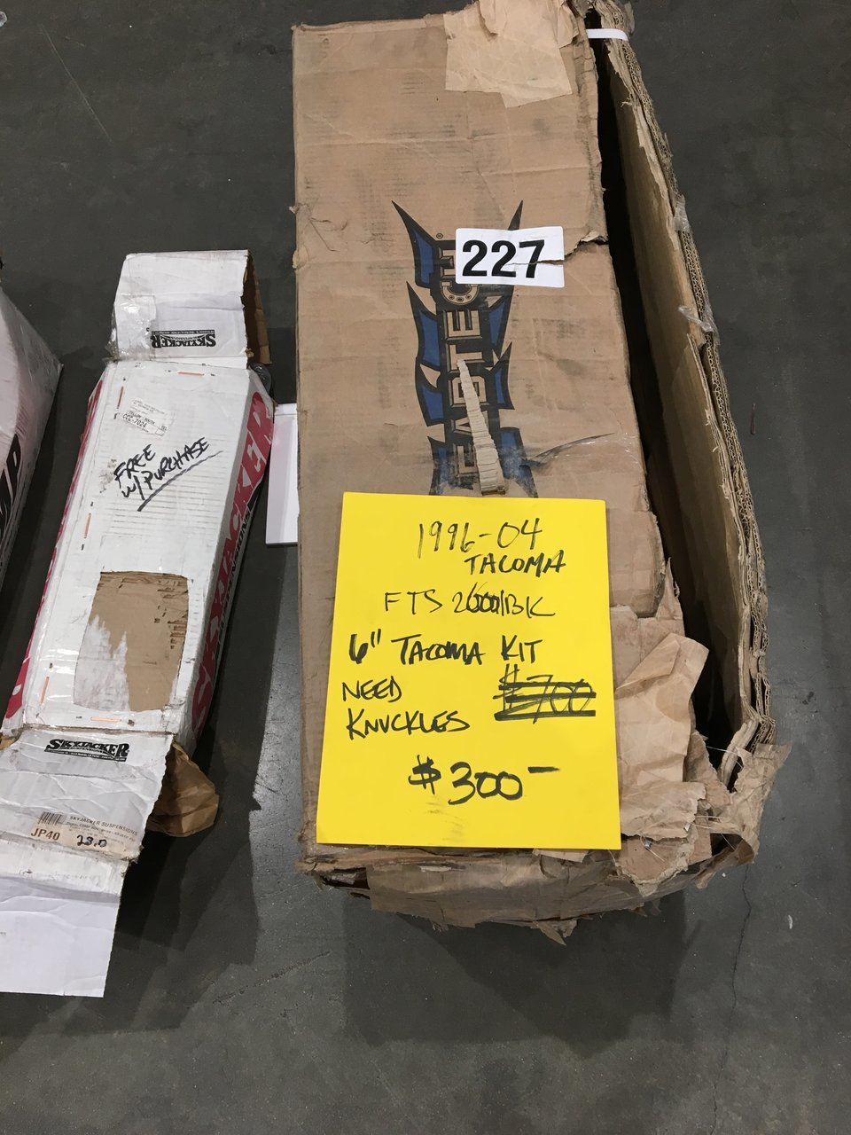

    6" FabTech Lift. Looks like it's a block lift though. $300

    there is no 6'' lift that isn't a drop bracket. or 4'' pro comp lift.

    It looks like there were brackets inside? The box said "missing knuckles"
  15. Feb 25, 2018 at 2:20 PM
    Blackdawg
    Blackdawg Dr. Frankenstein
    Dec 31, 2010
    #48500
    81,620
    Monte
    Wyoming/St. Louis
    The Trifecta of Taco's
    thats the drop bracket. You cut out the front diff crossmember and bolt that in. it lowers the front diff 4'' i think. The knuckles i bet its referring to are the spindle extensions as you are dropping the lower mounting point for the LCA. So you have to add a extension on top of the spindle to reach the UCA.
    So it's a " 6" " lift but you are actually not gaining any diff ground clearance as the front diff gets lowered. Not worth it.

    Oh that sounds stupid... no wonder it was in the clearance section. Couldn't find a good lift kit for my truck here everything was block lifts or 0" lifts.

    Needs spindles. $300 for a $2800 lift minus spindles isn't too bad.
