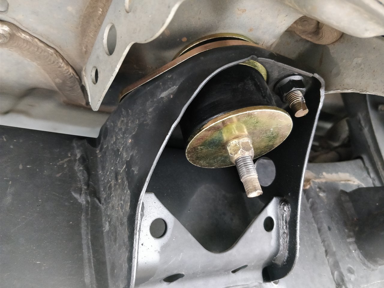

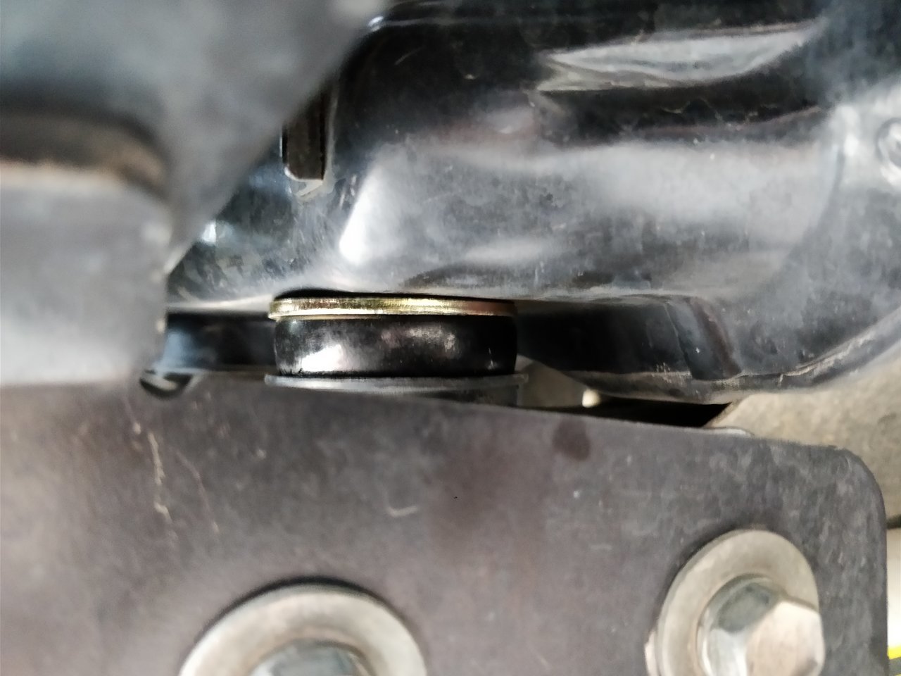

    Replaced old body mount bushings with energy suspension ones.

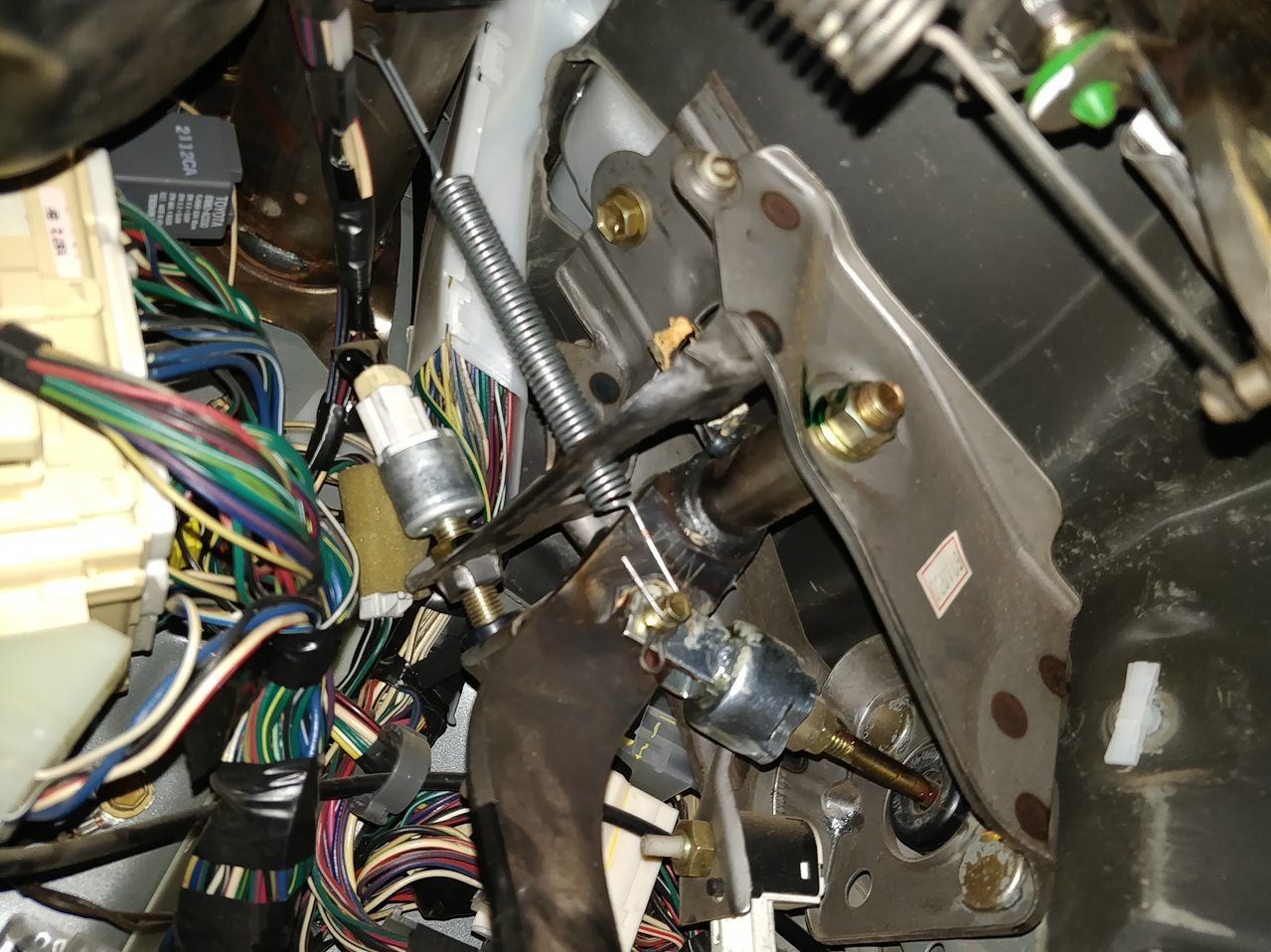

    Also did the linear spring mod for my clutch pedal so no more squeaking and now I don't have to help it up the last half inch.
    Also, does anyone have the issue where if you continue to press on the brake pedal it makes a popping noise, then releasing it it pops again? Trying to determine what that is from...

    What spring did you use?

    #70 spring from Ace hardware... I can't remember the exact thickness and length but if you have a Ace by you it's where all the free bolts and nuts are.

    Hmm, haven't noticed anything different in my braking... If feels almost as if the whole assembly is loose. The clutch also will occasionally "pop"... I just can't locate where it's coming from.

    Nice! For only about $2 I think it was well worth it. Hardest part was getting that huge spring out...

    body bushings make a difference?

    i probably should put new body mounts in. i dont want a body lift, so what thickness do i need?

    If someone installed them without me knowing I wouldn't have noticed a difference. I installed them because when it was rainy/cold every time I would go over a bump I would get a popping and shifting noise and I suspected the body mounts to be the issue.
    I got these ones. No body lift.
    https://www.amazon.com/gp/aw/d/B004ALKJ3I/ref=yo_ii_img?ie=UTF8&psc=1

    Not too difficult... I feared for my fingers the whole time... Make sure you put some 2x4's between the body and frame just in case.
    Took me about 4 hours total to do all 6 mounts.

    My clutch did that. Turn out that the bolt holding the bracket was loose and the bracket was making the noise. In my case I had to tighten that brass bolt up at the top of your picture (holding the bracket to the body)
