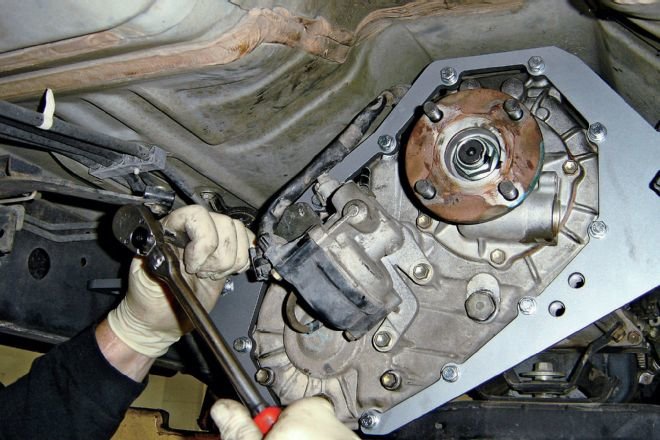

    Anyone know what the best way to determine if a Tcase will work with my 4x4 swap?
    I have a 2002 Prerunner, 6 cyl, auto
    I want to swap to 6 cyl, auto, non-ADD
    These 2 Tcases are available, but not sure either of them will work.
    Left is from a 2002 6 cyl, auto
    Right is from a 2000 6 cyl, manual
    @BartMaster1234 is giving me (what is probably the best advise) to wait and get the trans and tcase together... but these Tcases are avail for 60 bucks (for either)

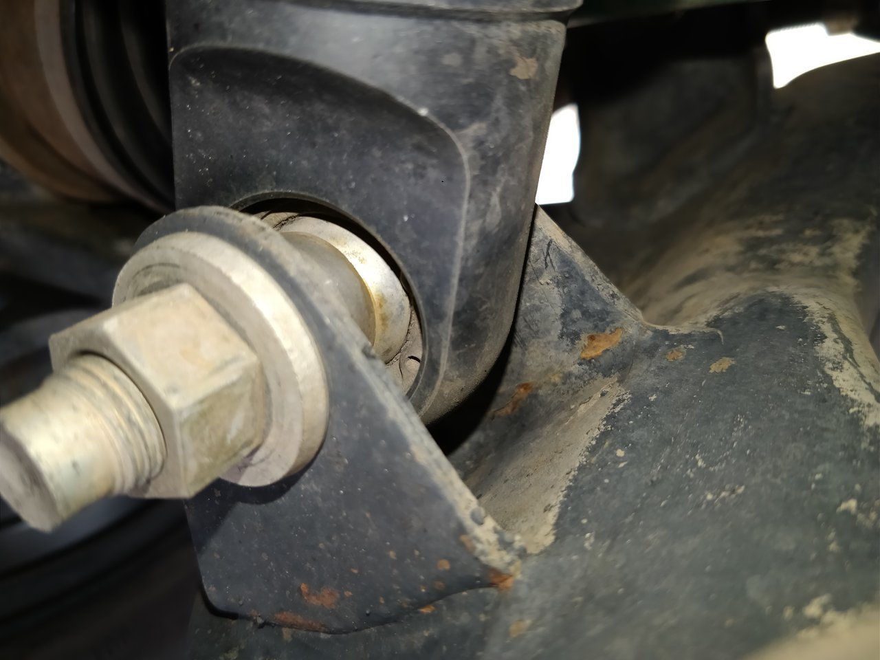

    I had the exact symptoms on my 2nd gen. It was worn out lca bushings. Taped my phone in the well and made a video like this one. FJ In the vid, but you get the idea. Worth checking.

    hopefully somebody can confirm, but I believe the manual won't work on the auto tans, and you are probably going to want the J shift which doesn't have the additional actuator on the back of it
    this is the back of my J-shift
    vs

    hmm have you looked at your shock lower uniballs?
    Yeah they will work. either one. Just depends on if you want a push button or a J shift.
    That said, I don't know(and also don't think) that it'll bolt up to your prerunner tranny if thats what you're asking.
    Manual tcase...is a j shift ;)

    I can see, in the pic the guy sent me, that the one he says came out of the 02 has that actuator.
    Now, as far as manual vs auto.(I'm asking here) I thought the reason they aren't interchangable was the spline count is different, but this guy is saying the spine count is the same on both Tcases.

    Interesting.. Ill have to look at that...
    Not sure what I would be looking for, they seems good. The popping almost seems to be coming from underneath me.

    No... I know it wont bolt up to my current transmission. What I'm trying to find out is if either will work as a non-ADD (all manual 4x4) with a A340F/4x4 trans with my 6 cyl

    the bolt pattern appears to be the same ask him if he can measure the input shaft length on both of them, one looks longer

    My lower uniball things on my shocks are ultra f*cked and don’t make a noise like your describing, so I wouldn’t worry about those being the problem.

    Ultra fucked, damn what did you do. It's hard to put ginormous play into spherical bearings haha. The ones on my Icon were loose (compared to new ones) but didn't make much noise, in fact the newer ones make more noise overall.

    They’re just old, the little ring thing that holds them in has popped out. Basically falling apart it seems like.
