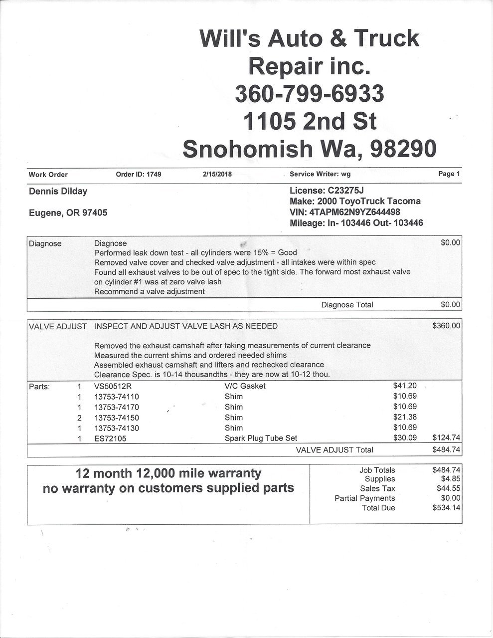

    Not today, but recently: my truck purrs now after a long series of moves that started with gas additives, then intake additive, then plugs and wires. Turns out that all the early moves were good moves and needed, but it was adjusting the valves that took care of the "rough idle" and the codes P0300 and P0100...
    It costs money but I knew up front that this was a restoration project - and compared to what people pay for the newer trucks that I would not own, it isn't even much money:)

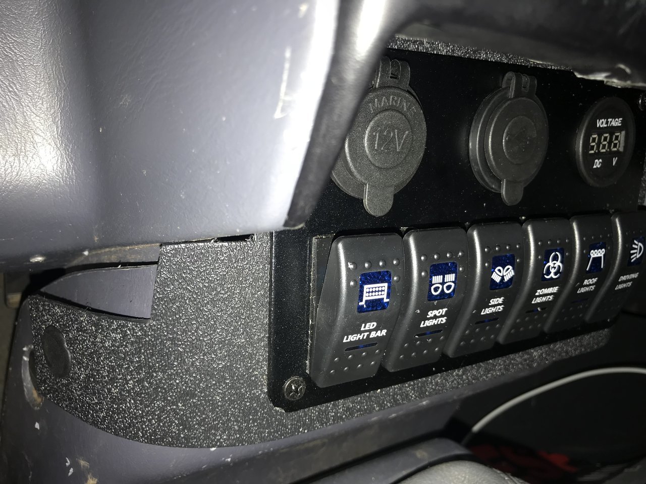

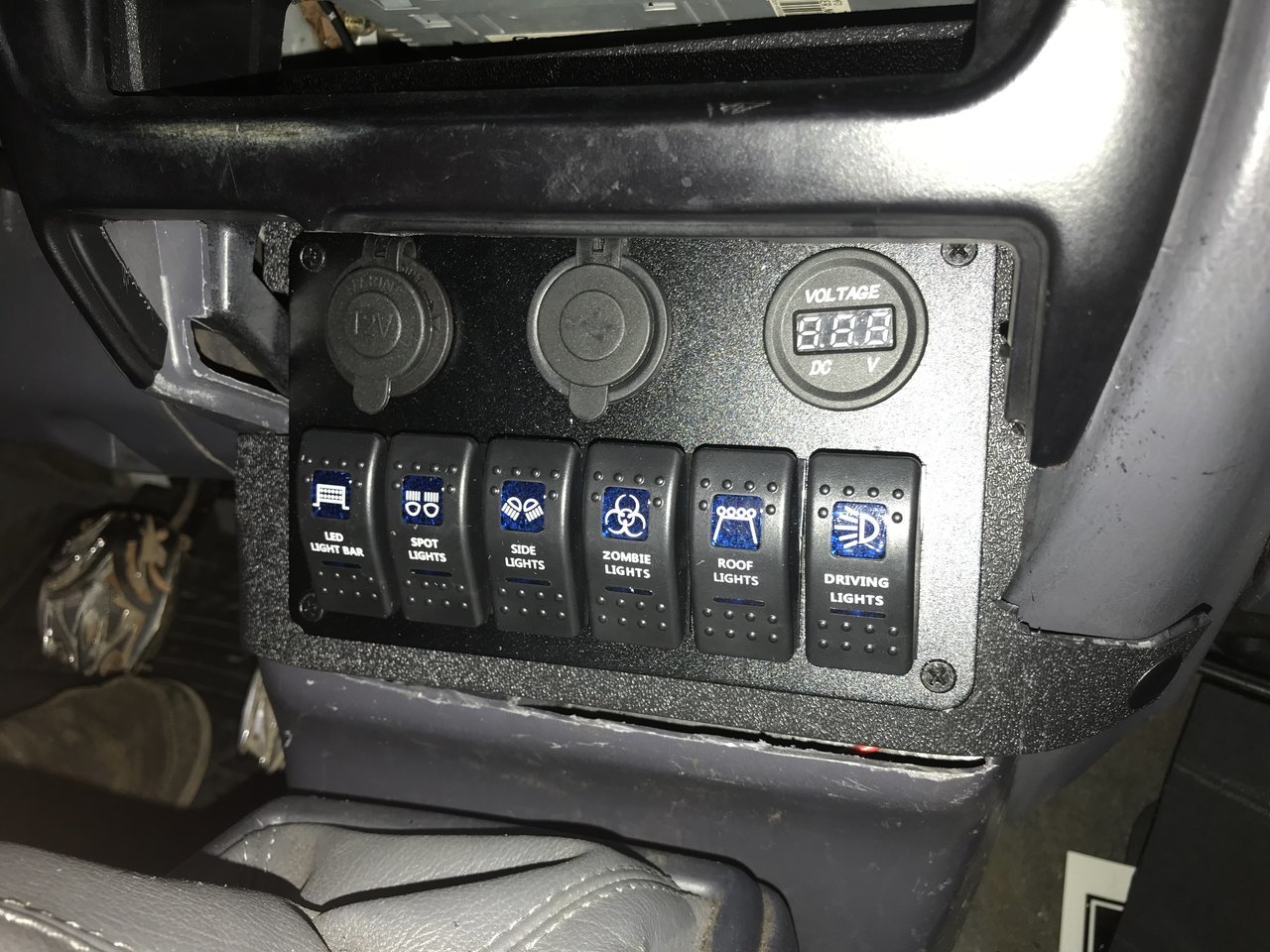

    Cut all that crap out of there and installed a switch panel with chargers and volt gauge! Boy was that a pain in my butt!!! But done except for adding lights on outside maybe next mod day will have some by then!
    Going to cover that gap up on the bottom with some door trim!
