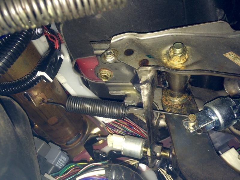

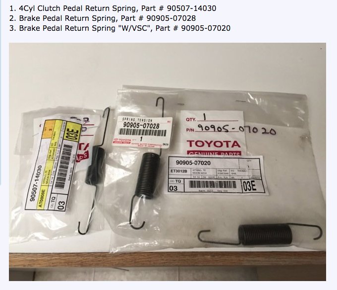

    Carefully remove the torsion spring and bushings, etc that are in place (there's a lot of energy in that facker).
    Get the appropriate linear spring (I ordered a Brake Return Spring from Toyota, PN 90905-07028) and connect it to the clutch pedal on one end and to the tab along the body of the cab.
    Done.

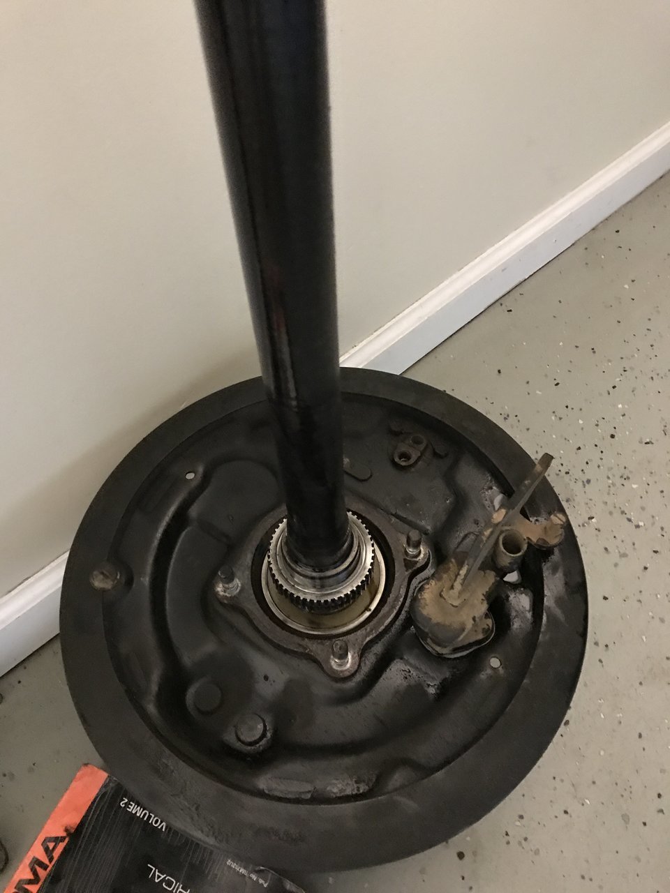

    Alright dudes it’s been almost 2 years since I last did my rear oil seal. Other one went out and has gotten worse and worse so I decided to tackle it. But I forgot what to do next, I got the axle out and I know what to do after this next step. Any help :D
    I thought it was removing a snap ring but it’s super tight to get the tool in there
