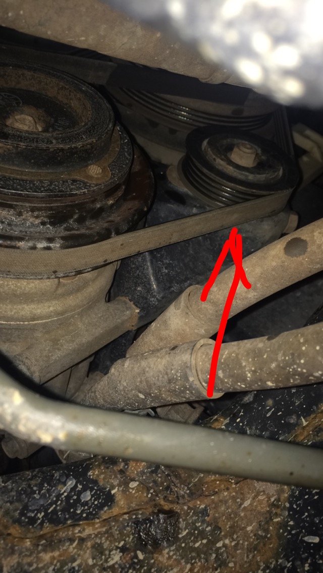

  2. Feb 28, 2018 at 7:19 PM
    Squeaky Penguin
    Squeaky Penguin Nothing Ventured, Nothing Gained
    Apr 5, 2012
    #76340
    10,096
    Brett
    Steamboat Springs, Colorado
    '01 4WD, SR5, TRD & '13 TRDOR AC
    Lots of dust and custom dents, Check Build
    1.
    If it takes you more than 15 minutes you're doing it wrong.
    Loosen the nut that holds the pulley on. Then loosen the bolt that tensions the belt. A ratcheting box end wrench is perfect here. IIRC it's a twelve. Remove the nut, remove the pulley, then put it back together.

  9. Feb 28, 2018 at 7:38 PM
    Squeaky Penguin
    Apr 5, 2012
    #76340
    10,096
    Brett
    That pulley sits low on the engine and is the first to fail. I'm surprised you've never changed it before with all the time you spend offroad. My last one made it like a year. Never had any issues with the accessory belts besides that pulley, which I've changed like 4 times.

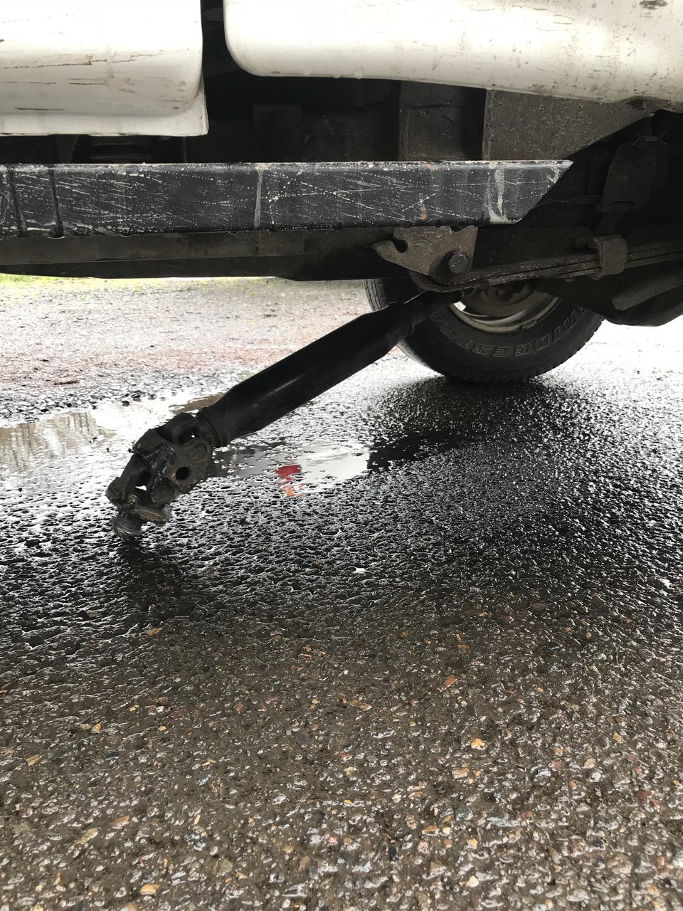

  14. Feb 28, 2018 at 7:53 PM
    flenniken7
    flenniken7 Wishin' I was Fishin'
    Feb 23, 2015
    #149446
    690
    Jason
    OKC
    2000 4x4 tacoma 1996 Z71 DD 248K, 2012 tahoe
    5100's 285' to come 4" lift 33's on hoe
    CV joint at the front of the shaft. When i had my bronco that was lifted and had an extreme angle i was eating drive shafts and it was always the CV going out. on the last one the Cv was going out and it sounded like a helicopter and it ended up sheering the aluminum transfer case housing

  17. Feb 28, 2018 at 8:03 PM
    Unner
    Unner Well-Known Member
    Dec 14, 2014
    #144292
    658
    Huntsville, AL
    01 4Runner 4x4, 08 4Runner 4x4
    2001 4Runner, Lifted, Armored, 33s 2008 4Runner Stock
    https://www.yotatech.com/forums/f2/2001-4runner-screeching-noise-need-help-287110/
    There's a couple pictures in this link. I already had it pulled up because I need the part number. Mine squeaks on first start when wet and squeals a little when wet too. I bet my problem is this pulley too. I think it's the original at 246k miles, and those weren't all the easiest of miles...
  18. Feb 28, 2018 at 8:08 PM
    Speedytech7
    Feb 20, 2014
    #123587
    58,514
    FCQM+VG Cheney, Washington
    It's less Tacoma and more mod
    It doesn't self tension, have to tension all the belts yourself.

  20. Feb 28, 2018 at 8:16 PM
    JKO1998
    JKO1998 Well-Known Member
    Jun 2, 2015
    #156578
    53,121
    Utah
    It is pulley right? Looking I from the passenger side, sorry for the dirty truck/ crappy snatch chat picture.
    Or is it the one to the left?
