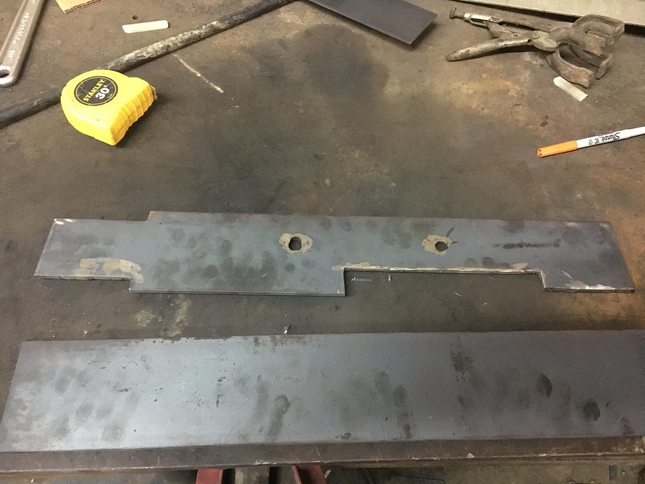

    @Speedytech7 if you’re going to mount it up that high straight with the frame, you’ll have to taper the frame plate to fit under the back lip of the bed.
    Can see it here

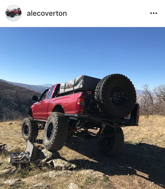

    When I get further along with my truck, have some money, and hopefully some more know how I wanna make a bumper like this guys:
    Replace the tailgate with a swing out

    That's literally what he has. Then he just fabbed a tube bumper

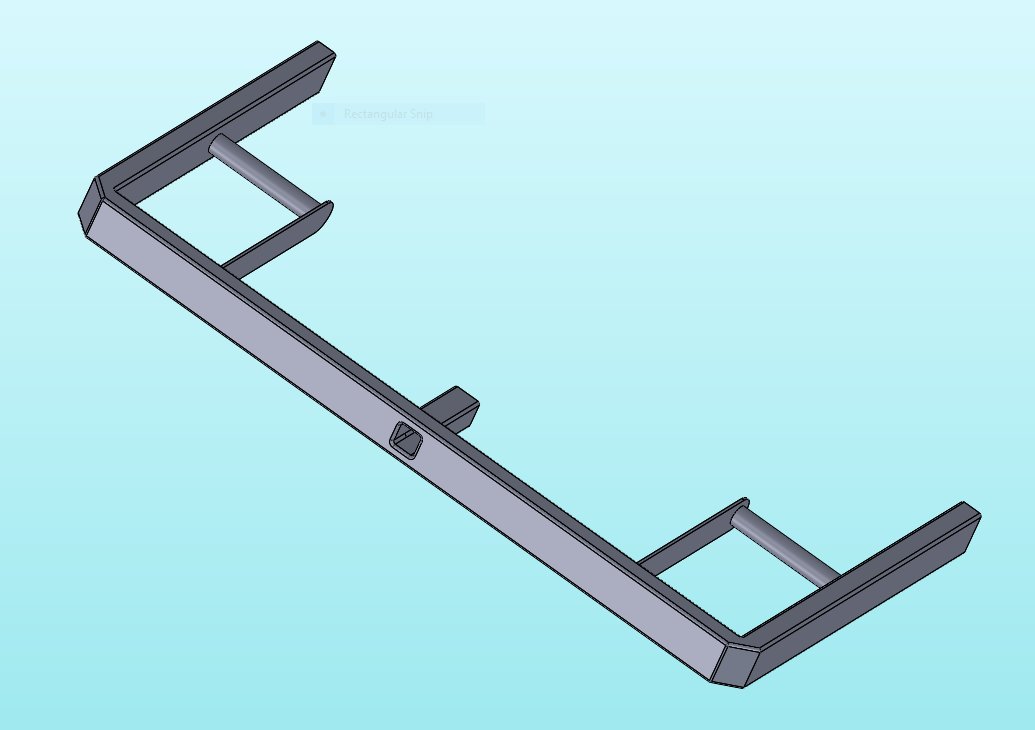

    It's less Tacoma and more mod
    I like your design a lot, cut up a bit on the sides like you have it is really good looking. Trying to chop all the low hanging fruit off. Just curious how you went about designing the frame plate portion, hard to get a feel for where everything should be ya know?

    Ooooh, I wouldn’t think making the swing out part would be the difficult.

    Is this the top view?
    Yeah, you'd have to imagine it on a truck, I'm not talented enough to design the Tacoma rear end in solid works haha

    my frame plates are 4” x 1/4” plate. So I started with a 4” rectangle of cardboard. Started marking and trimming from there until I had the design perfect. Traced it out on the steel plate and cut it out with the plasma.
    Be happy to get you any pics/measurements you need.

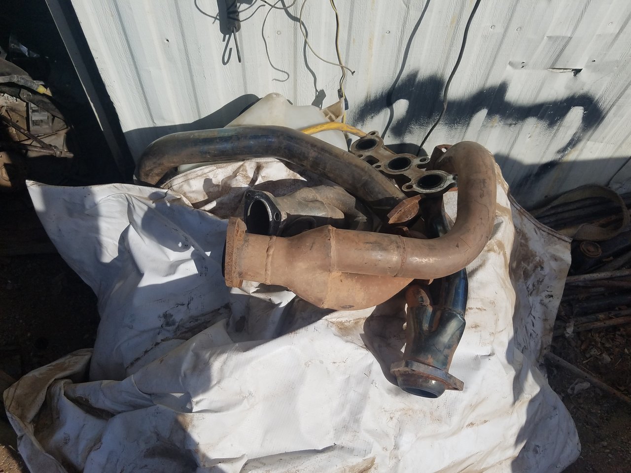

    Anyone know what brand of headers these are. They're 3.4v6 for sure but don't look like TRDs.20180301_152228.jpgnot the best pic but there short tube headers.
  20. Mar 1, 2018 at 3:08 PM
    flenniken7
    flenniken7 Wishin' I was Fishin'
    Feb 23, 2015
    #149446
    690
    Jason
    OKC
    2000 4x4 tacoma 1996 Z71 DD 248K, 2012 tahoe
    5100's 285' to come 4" lift 33's on hoe
    no but i will take them if you don't want em'
