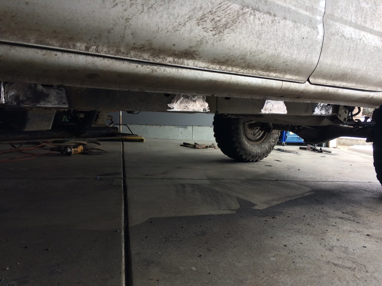

    Know any body shops with a frame jig? They would have the tie downs and hydraulic rams for that job. You could get dangerous and creative with pulleys and a winch too, but hydraulics tends to store less dangerous kinetic energy. Upside of the frame jig is it can fix your thrust angle too. I bet you can get that some space back by replacing your body mount bushings.

    Well no matter what you're gonna weaken the frame and sliders by forcing them back into position, work hardening is a bitch. But I bet you could line yourself up on the edge of a loading bay and have a winched friend in the lower section start pulling. It's gonna be a numbers game unfortunately so anchoring yourself might be (probably is) required and making a fulcrum with something strong (jack stands might not be enough) would likely be required.

    I see what you mean, i think you have elastic and plastic deformation flipped BTW. You get plastic deformation after elastic deformation, you don't want plastic deformation.

    I was thinking a vertical handy man jack between your slider and something cement or heavy thick steel of some sort (if that makes sense), but Zanes idea sounded a lot better, practical and less scary... so I deleted it.

    Make him cut it off clean and re mount it. A welder is only as good as the fitup. Thus why a fabricator learned fitup instead of just being a welder.

    Its a roll of the dice in my opinion. I would cut them and re weld at the proper angle. Stick them in a press to get the desired shape. If you try and fix them on they could wrinkle cause the tubing wall is all ready thined out from bend 1. or just tweak it at all the wrong "weak" spots puting jogs and dog legs in every where else.
    Not saying i havent been there, can you cinch anchor a hy lift base to concrete and shackle the bar to the stub in reverse drawing it down. Or maybe flip the stub over giving it a surface. Maybe driving 2 tires on a 8ft hard wood 4x4 bolted to the jack would be enough. You can use a hy lift to spread or retract. Aka poor mans winch.

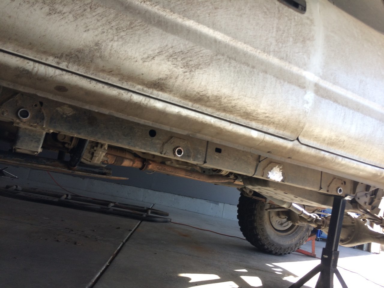

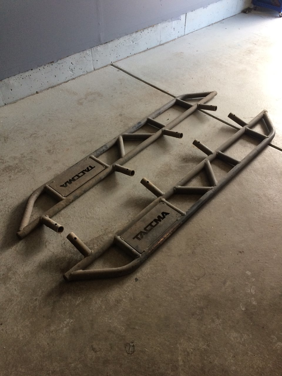

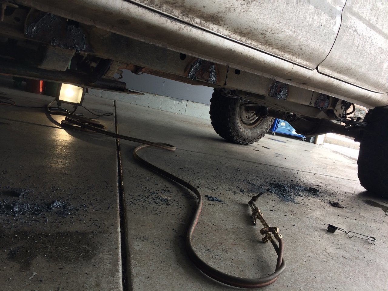

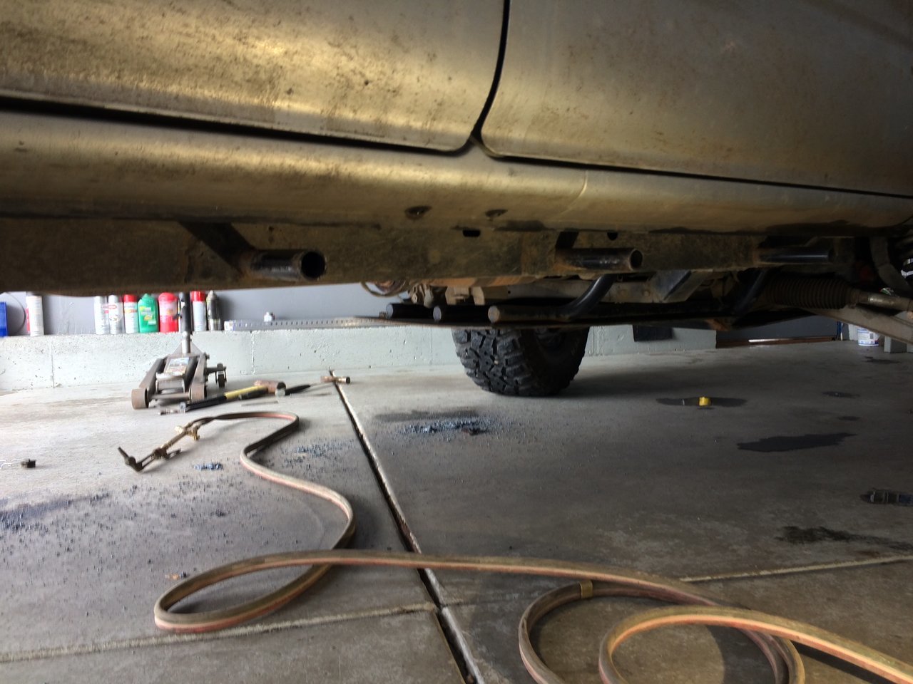

    Ouch. Dam. Dude needs a good kick in the balls. Now on to fixing it.
    You could either cut off the sliders and move them or chop them. Moving them is your best route. Chopping them will look like shit and the tube will act like a spring if you cut them and youll never get them lined up again with out clamping the shit out of them.
    Got a torch? If your good with a torch. You can burn the welds off and not cut the frame. I just cut mine off. It's the easiest way to do it. Then grind off the excess.
    Or you can also grind off the welds but your going to hate life and go through a lot of wheels.
    You can turn a blind eye and run it the way it is. All up to you. Good luck.
    Here are some pics.

    I thought about it but he welded them on for free so not much I could really say

    If I had a torch id cut them off. I'm thinking just cutting the end about a inch and putting a new end cap on them

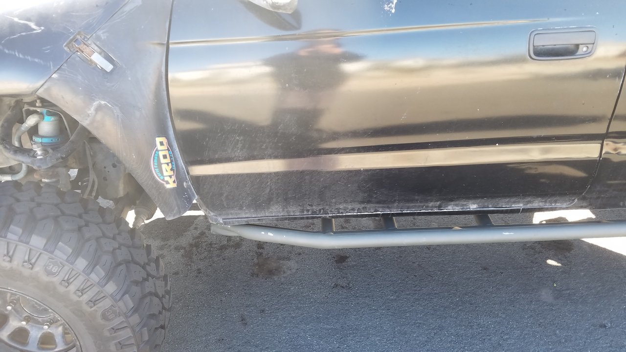

    I bought mine used and the driver side is tweaked if only i had a way to bend the passanger side in then it wouldn't be a issue with them being to far forward20180304_090232.jpg

    Definatly can't run them like this just went up to the gas station and when I turned in the tire rubbed

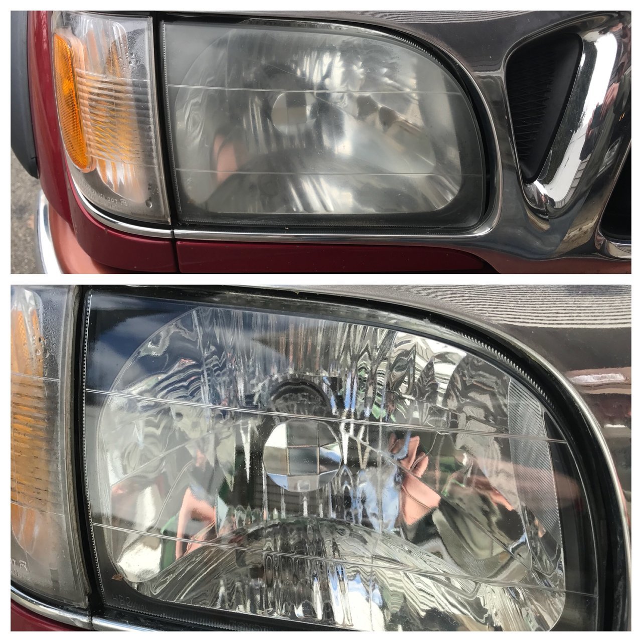

    Defogged my headlights. Much better now. Next to replace the leaky corner housings
