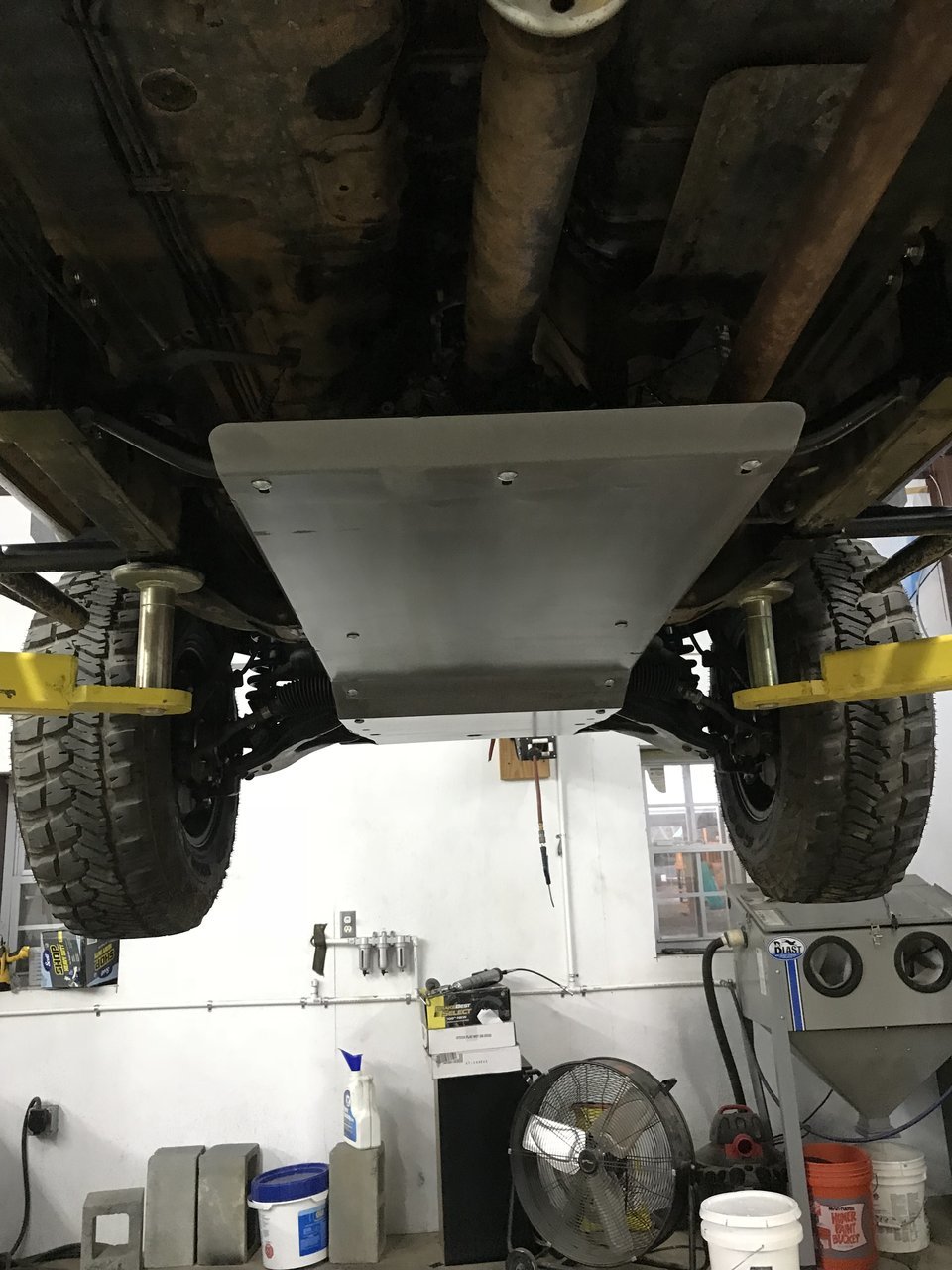

    No roller fairlead for steel cable? Any reason why?
    I have the e-locker motor guard and I don't think I've ever seen it get a scratch. Gas tank skid would be worth it IMO. The LCA and Diff skids are meh, if you are worried about bashing your diff, I would just weld some more metal to the bottom, especially around the diff plug ring. Almost had mine back itself out on me from rubbing on rocks. Had to tack it shut. Still need to address that.
    In the same boat with the skid. Mine is smushed in and so is the tank. But it took 4 years and one incident for it to happen. That said, still wish I did it before the incident.

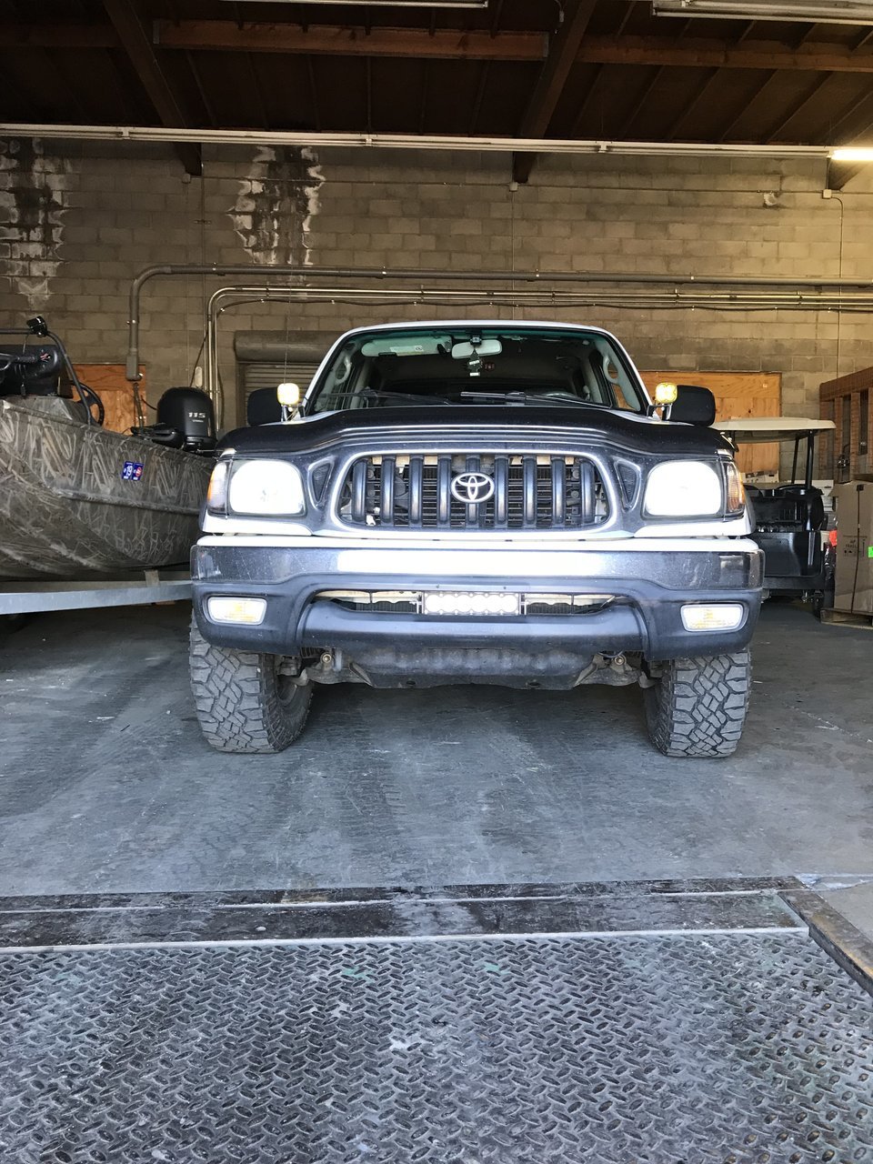

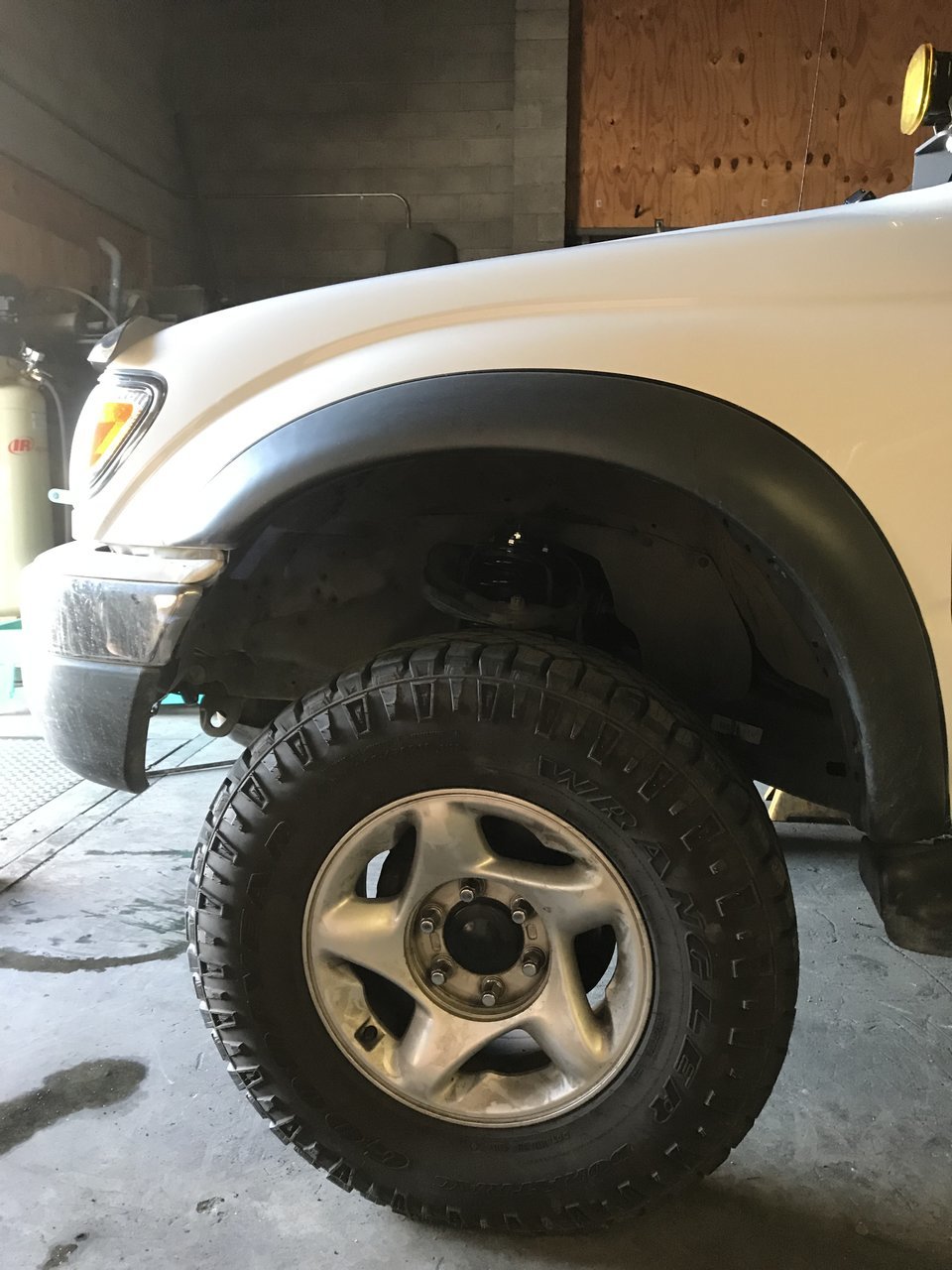

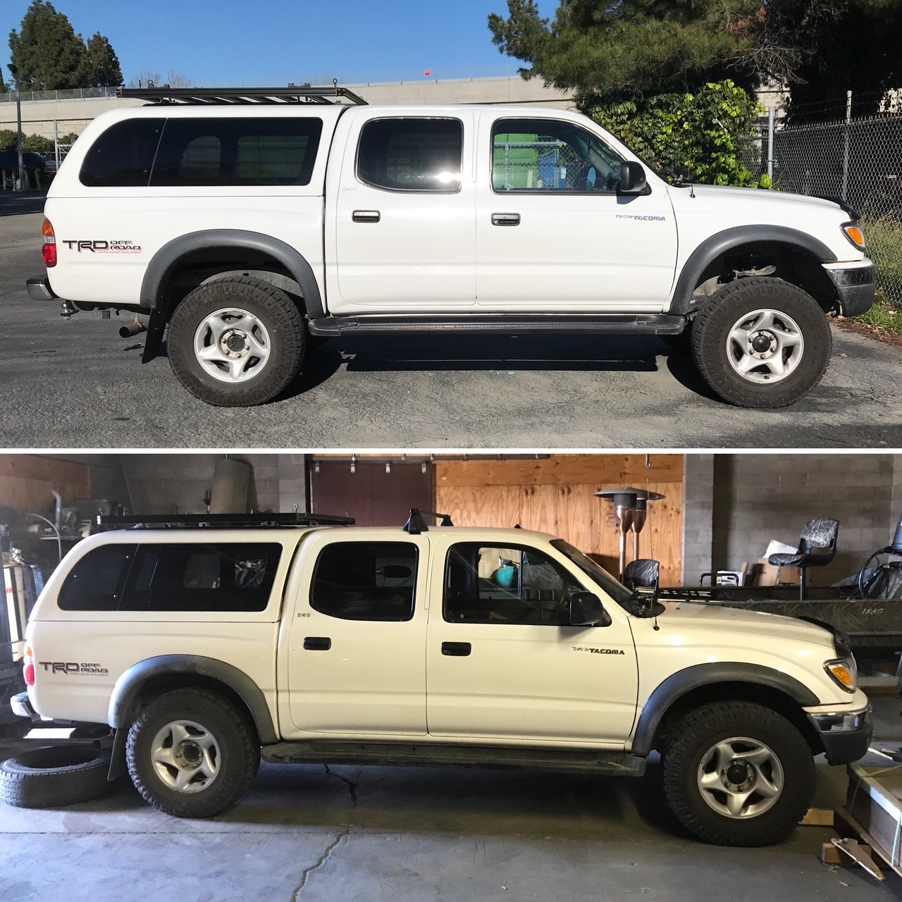

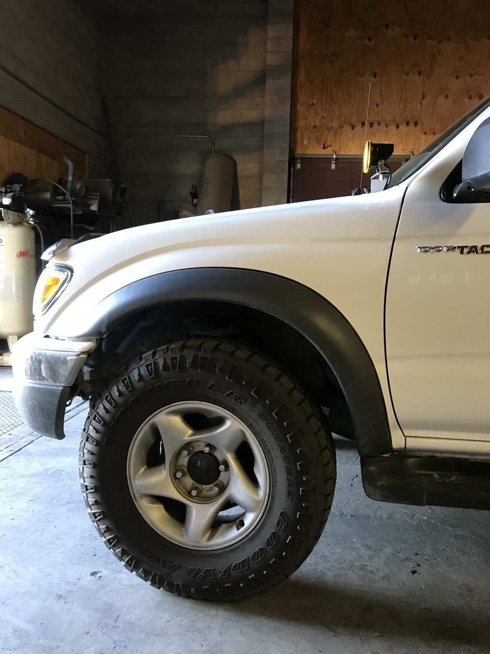

    I finished installing my OME lift.
    I installed the back last week and was driving around like a stink bug while I waited for the front components to arrive.
    DDD04F56-1C1E-4460-8353-26975FAC3206.jpg IMG_3552.jpg IMG_3555.jpg IMG_3553.jpg IMG_3556.jpg

    Looks good! A little hard to see but in the front "after" pic, your outer CV boots look like the fins are pretty crunched up against one another...if so then the inners are probably just as bad or worse. Might want to look into a diff drop/tilt kit to help it out some, or before long you'll have a busted boot and a ton of grease everywhere (ask me how I know). Honestly though my diff drop didn't really do much to help mine. I had to lower the preload on my coilovers which made the biggest difference. Can you post a couple close up pics of the inner/outer boots?
    Also, spraying the boots with silicone spray every so often is supposed to help prolong their life, so I've heard.

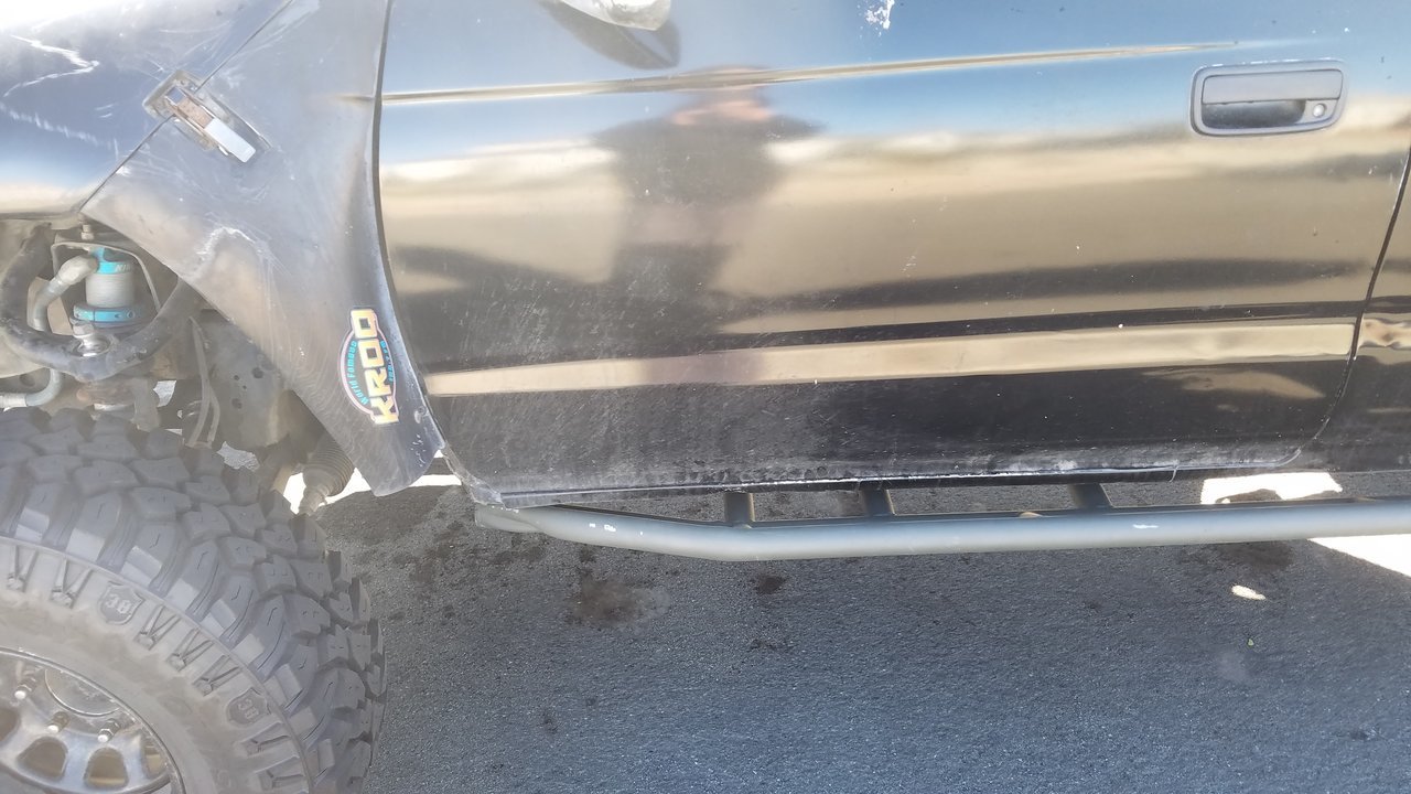

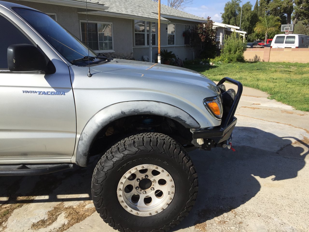

    They are going to look different the drivers side is bent and pushed in. He welded them in the same position 20180304_090232.jpg
    He welded it to the same spot as the drivers side which lines up better since it's bent. He didn't pay attention to the tire just put it in the same spot as the drivers side and welded it on. He can weld but is in no means a fabricator

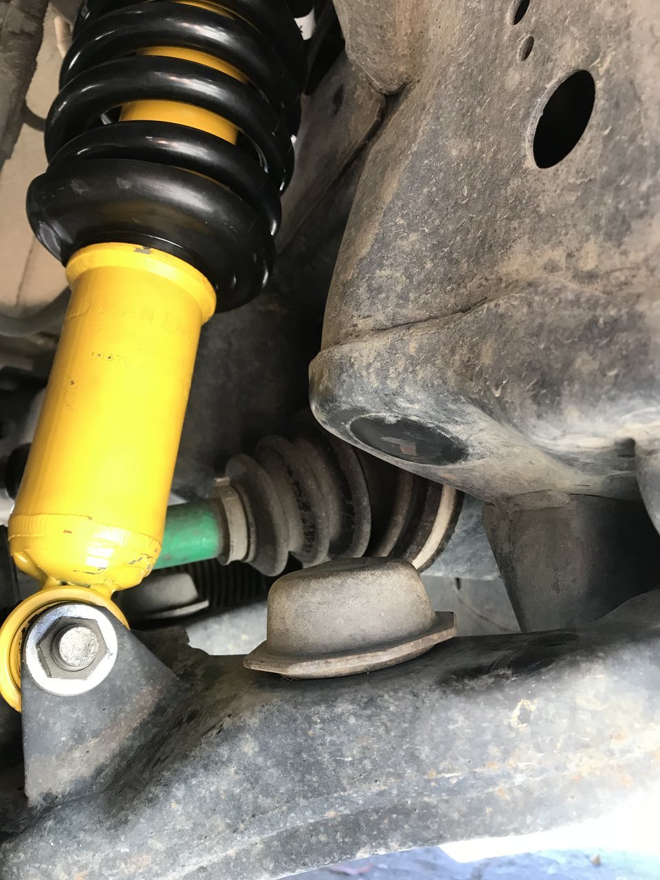

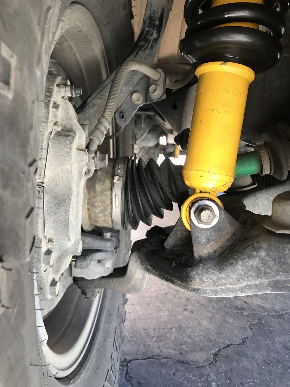

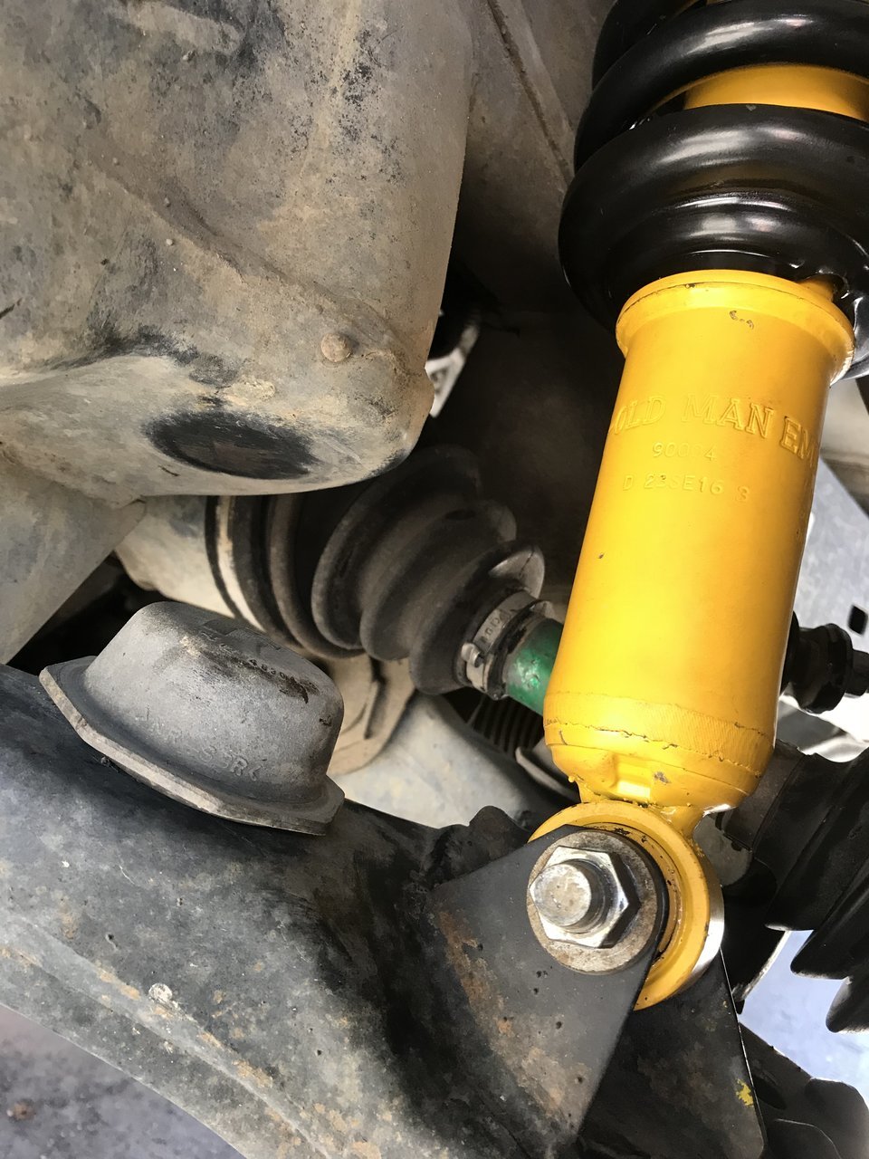

    Thanks for the heads up! Here are the pics. The kits are cheep and do not look to hard to install so let me know if you think it is necessary.
    Driver:
    Passanger:

    Actually those angles don't look terrible, maybe a bit better than mine were when one of my boots split open. My inners were the worst, the two most inner fins were rubbing pretty good and eventually split after maybe 3 months. I'd say just keep a close eye on it for awhile, if you can see some signs of wear then it might be good to try a drop.

    Ill be sure to hit 'em with lube and keep an eye on them. Thanks again for tip!
