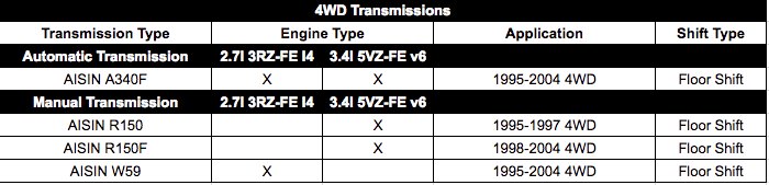

    Does anyone know what year Toyota stopped offering the 5VZ-FE in 5-lugs? My guess was 1998 when the PreRunner came out, but my 1998 5-Lug has the 5VZ.
    Did any trucks prior to the PreRunner being introduced in 1998 have the 3RZ or was it strictly 2RZ or 5VZ?

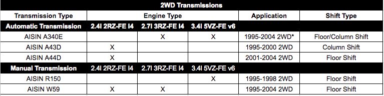

    Can anyone cross-check my transmission table? I've double checked it but I could have made a mistake somewhere.
    *1995-1997 5-Lug 5VZ, 1998-2004 PreRunner 3RZ/5VZ
