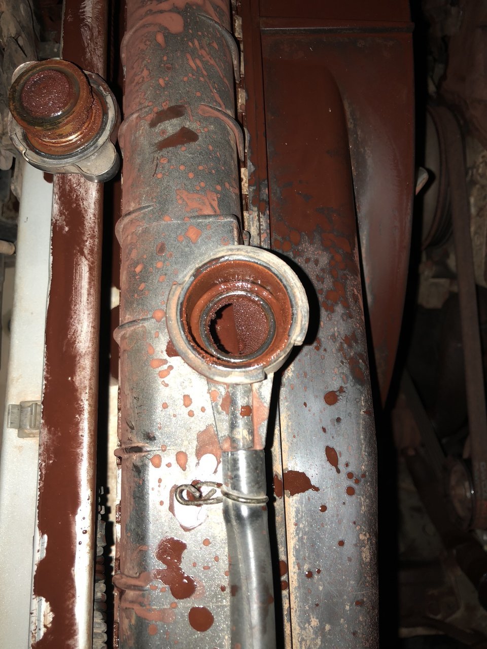

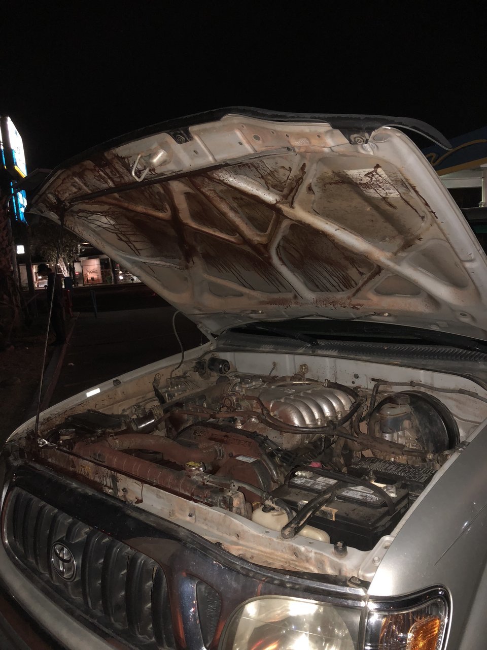

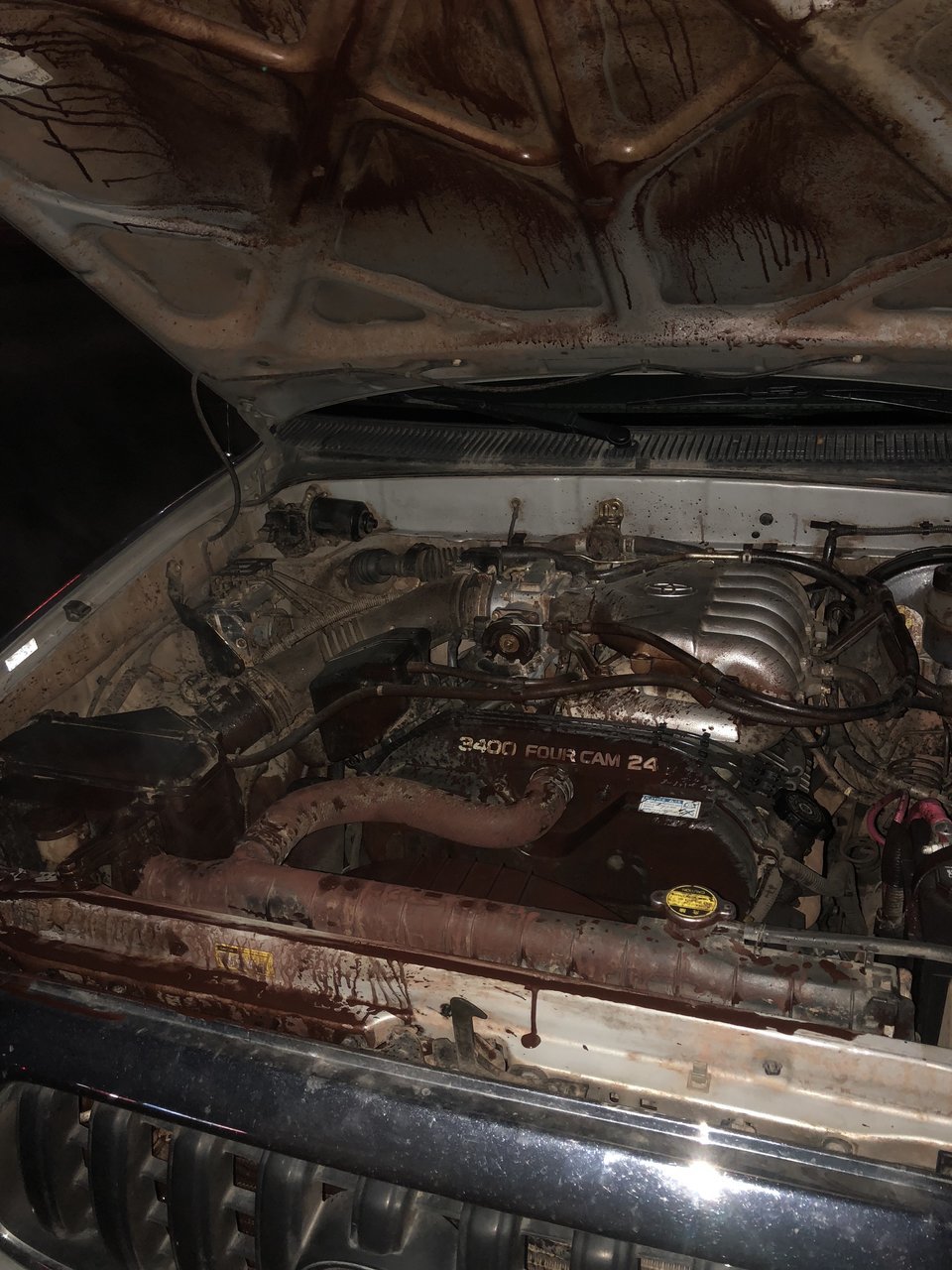

    I was driving home from Costco in PV the other night. Something started smelling horrible and I noticed the engine temp skyrocketed. Pulled over with steam coming out from under the hood and found this nightmarish scene. I thought I had blown a gasket because it looked and smelled so much like oil. Ended up checking the radiator and saw it was the same gnarly substance. Filled the radiator with water and tried to drive home, but a few miles down the road the temp started to spike and steam was coming out again. This time we found where the steam was coming out. Glued some plastic over it and amazingly it held until I could drive to a friends house in north Phoenix where I could work on it the next morning.

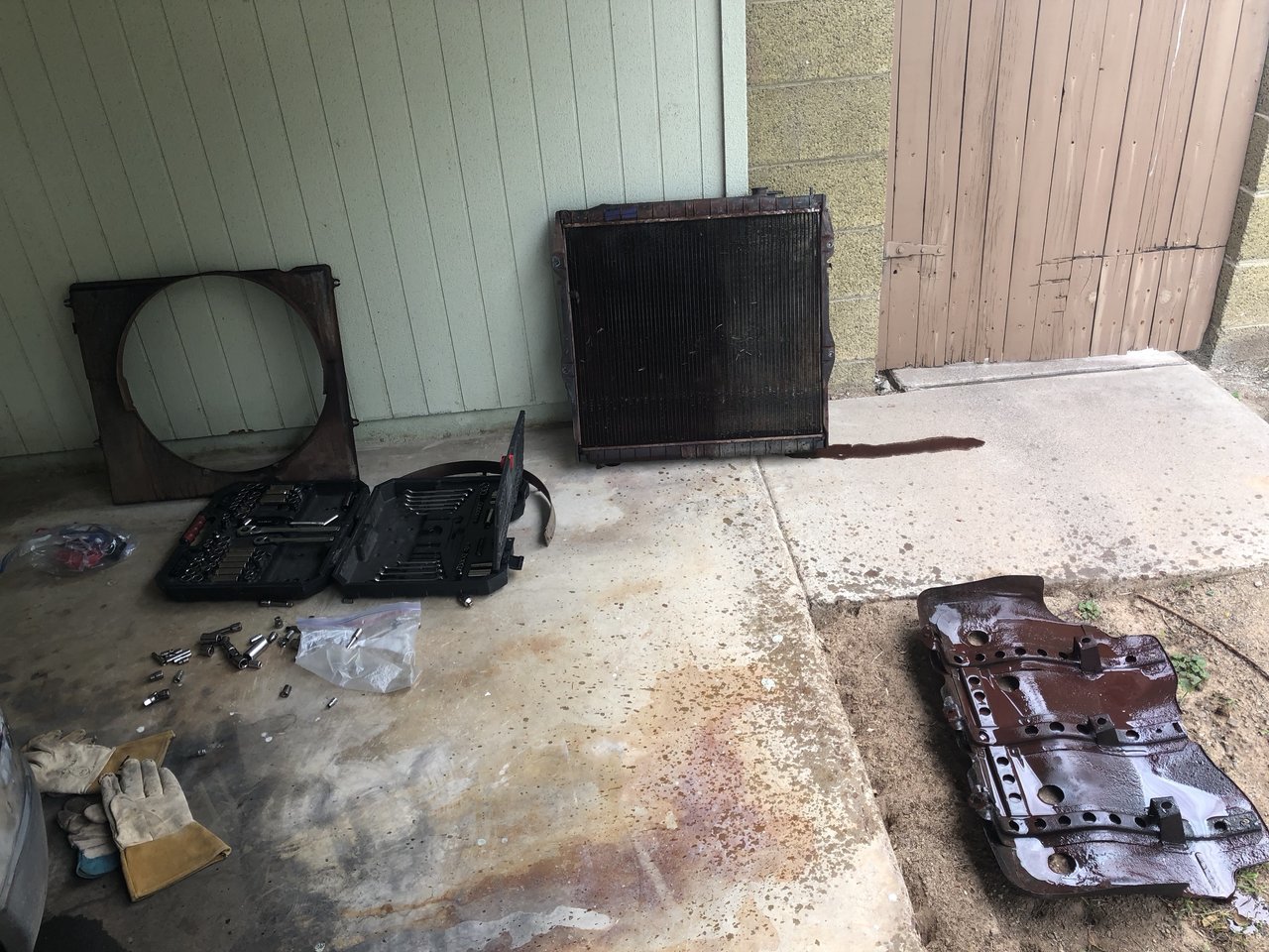

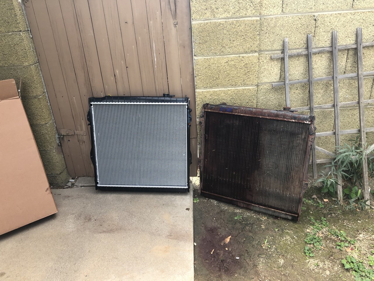

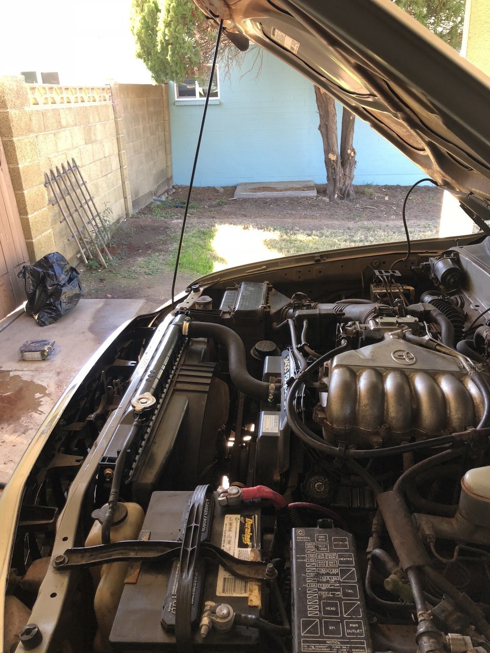

    The next morning I woke up early, pulled out the old radiator, measured it, and bought a new one from autozone ($180ish), along with a new thermometer and hoses. I also ended up tossing the original hose clamps because those things are such a pain to work with. We used a hose to blast out the garbage that was still in the engine block that must have built up in the cooling system over the years.
    Needless to say I'll be paying more attention to my radiator moving forward.
    Edit: My temps also improved (shocking, I know)! Typically the engine would hold steady at 220* with the needle just above the halfway point. Now it tops out at 190*

    Jesus Christ... that can't be coolant. That looks like straight up motor oil. You sure you don't have a head gasket leak?

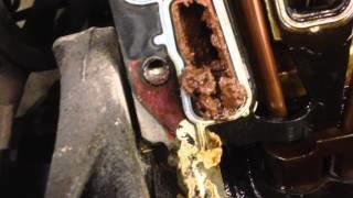

    Reminds me of Dexcool
    El Taco Diablo and MacGyvR like this.
  10. Mar 10, 2018 at 3:46 PM
    BartMaster1234
    Aug 21, 2016
    #195197
    45,881
    Tyler
    Pittsburgh, Pennsylvania
    Flux Capacitor
    Dexcool gets that dark? Wow.
    MacGyvR likes this.
  11. Mar 10, 2018 at 3:47 PM
    Blue92
    Blue92 Well-Known Member
    Aug 26, 2017
    #228071
    16,481
    Daniel
    North Carolina
    2018 Sport
    Let it mix with air and you get a chocolate pudding like substance. Killed a lot of GM cars
  12. Mar 10, 2018 at 3:48 PM
    BartMaster1234
    Aug 21, 2016
    #195197
    45,881
    Tyler
    Flux Capacitor
    I'm used to seeing oil mixed with coolant and it ends up looking like that. Didn't know air did that.

    Maybe I'm paranoid, but I'd flush that shit again in a few weeks

    Air and dexcool dont mix well. Its the only type of coolant that does that. GM's finest engineering. mqdefault.jpg
  16. Mar 10, 2018 at 3:57 PM
    Itchyfeet
    Itchyfeet Well-Known Member
    Apr 1, 2016
    #183054
    9,116
    A number of Dexcool issues were owner generated. GM owners are not a bright bunch
    Blue92[QUOTED] likes this.

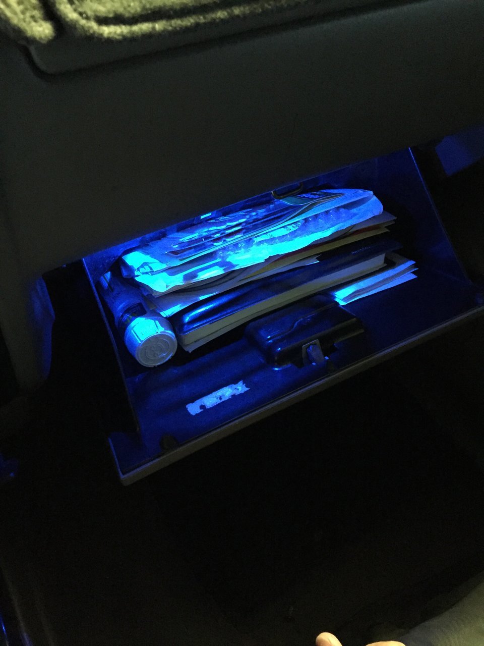

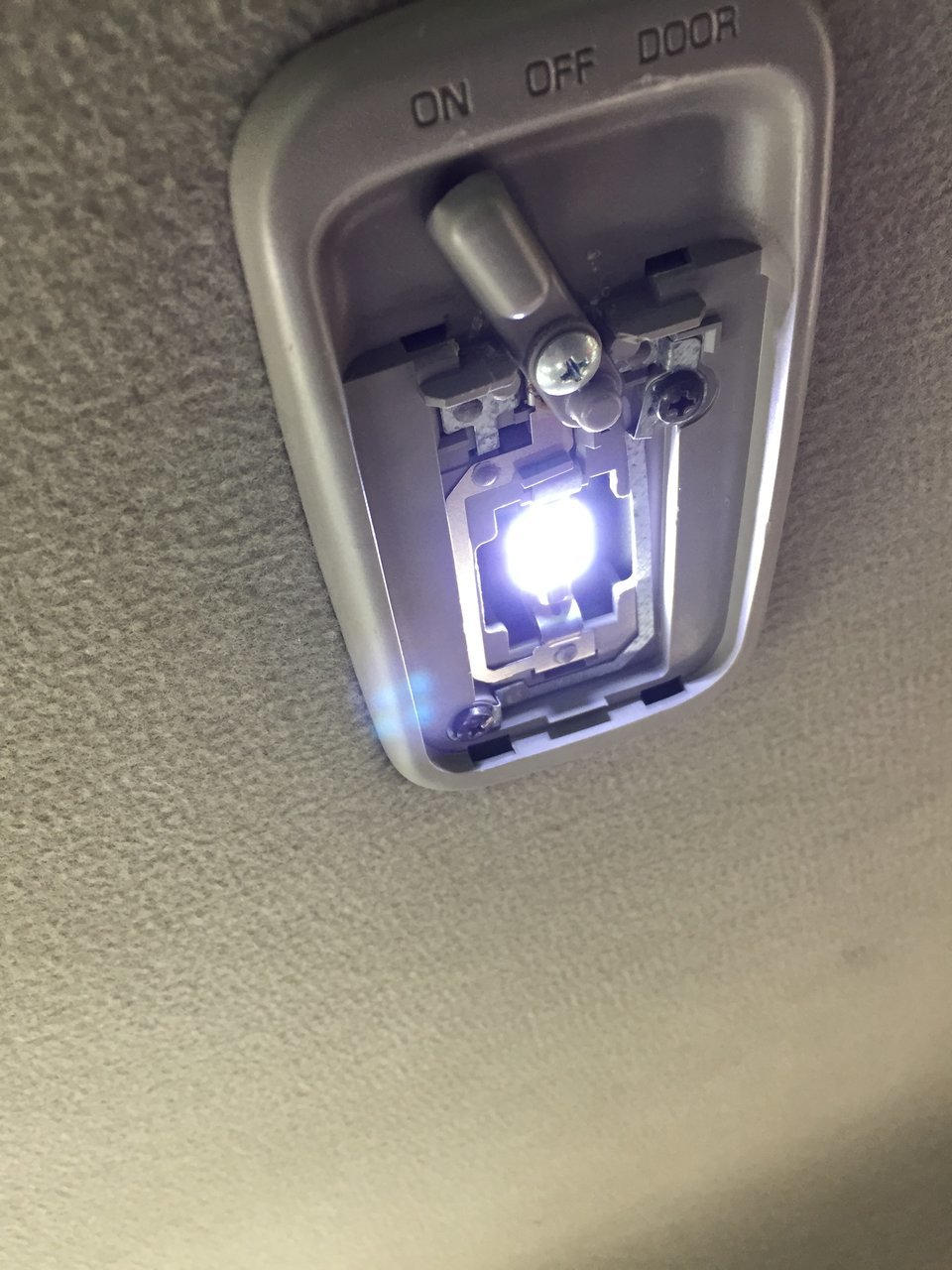

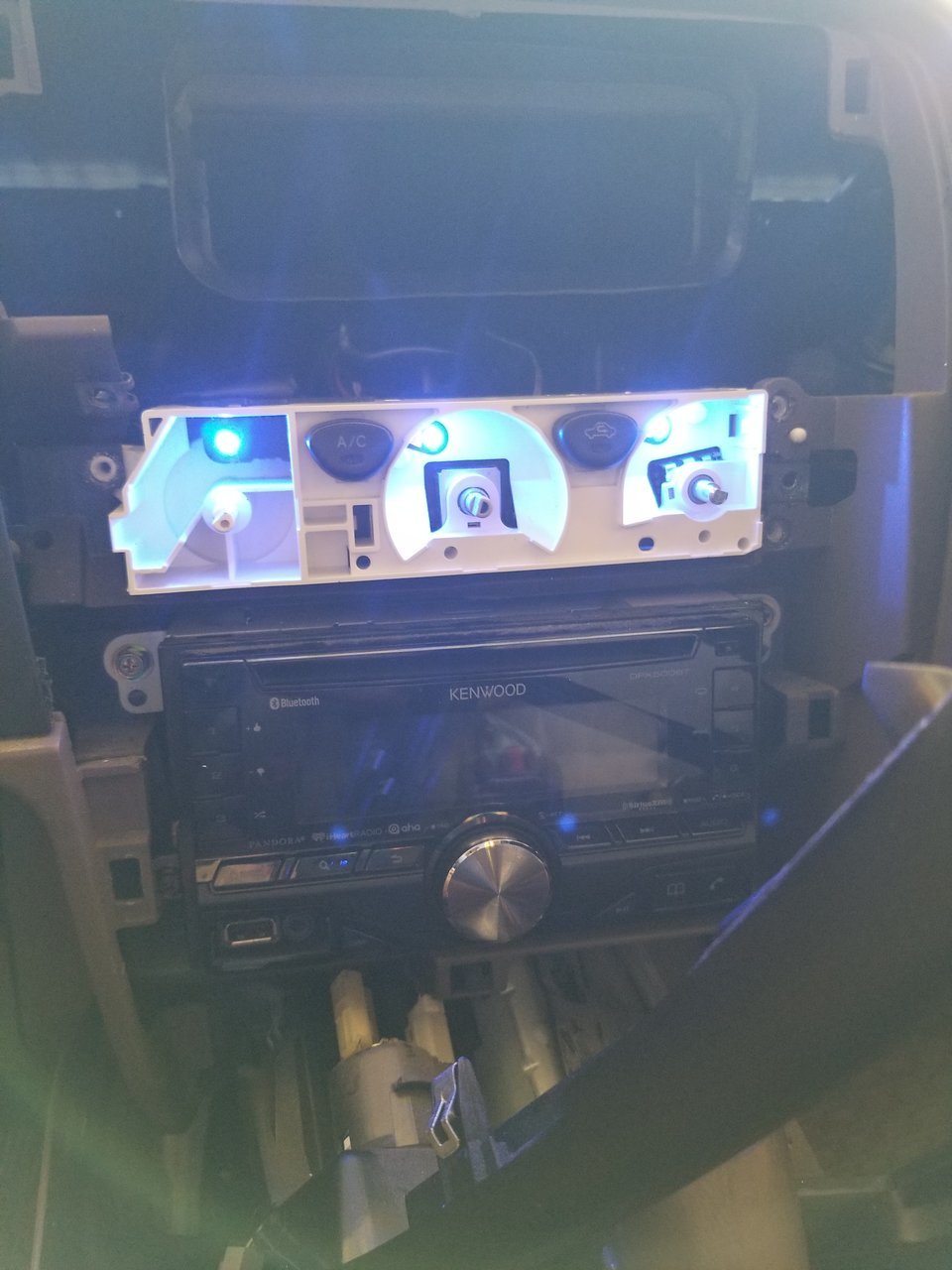

    I changed out the glove box & ashtray to LED's too.

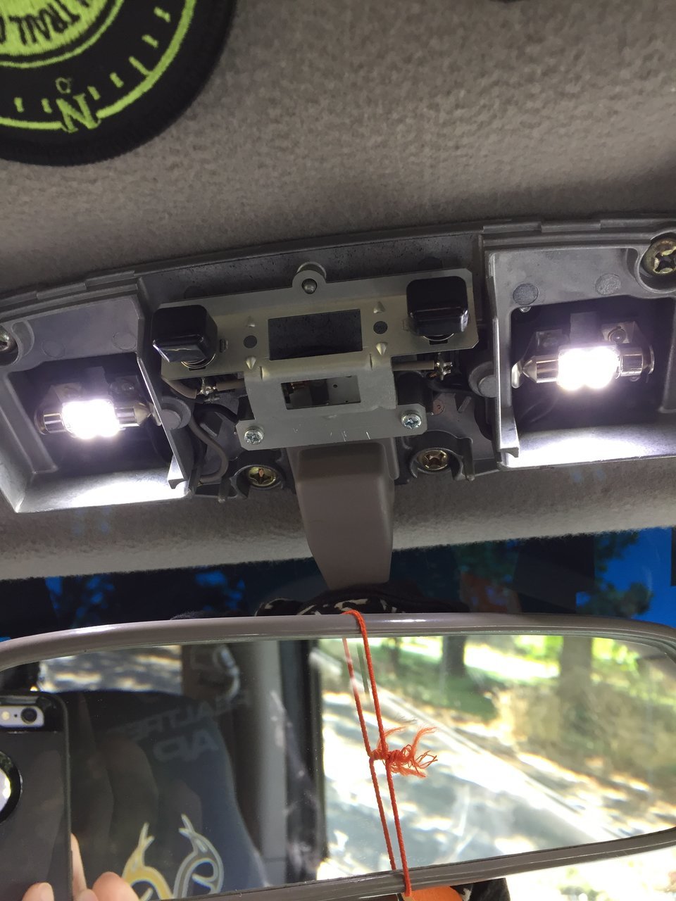

    That sucks about the dome light. I changed the dome & map lights too.

    Mine looked like that when my truck had a cracked head, that shit is not good. That truck needs service.
