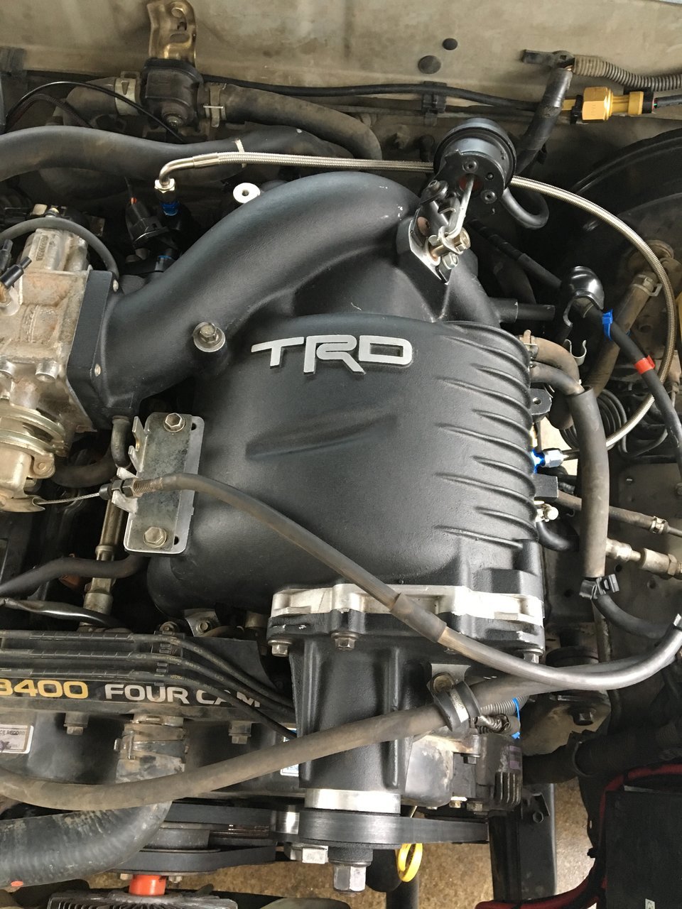

    Just checked the wiring and everything checks out. The piggyback urd box buzzes and makes noise when in boost and it runs like garbage. The instructions say that the restrictor t is installed wrong if this happens but how the hell can it be wrong? The air flow is clear and everything is in line and it runs like trash under boost @Blackdawg driving normal it’s perfect and no cel’s

    sounds like my issues. Could be a boost leak somewhere.

    URD had a bad batch of the restrictor T fittings a couple years ago, I ended up with one and had the same thing happening - injector controller was buzzing and boost was not hitting very hard. I called gadget and they sent me a new T fitting in a couple days.
    If you remove the fitting and try to blow through one end while blocking off the other end, and nothing is coming out of the restricted end, you've got a bad fitting.
