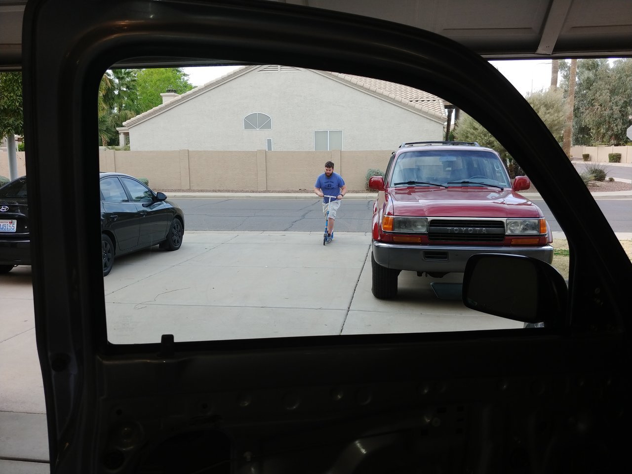

    Stockish
    Man in 2 months your gonna wish that you would have left it on.
    The az sun is brutal !

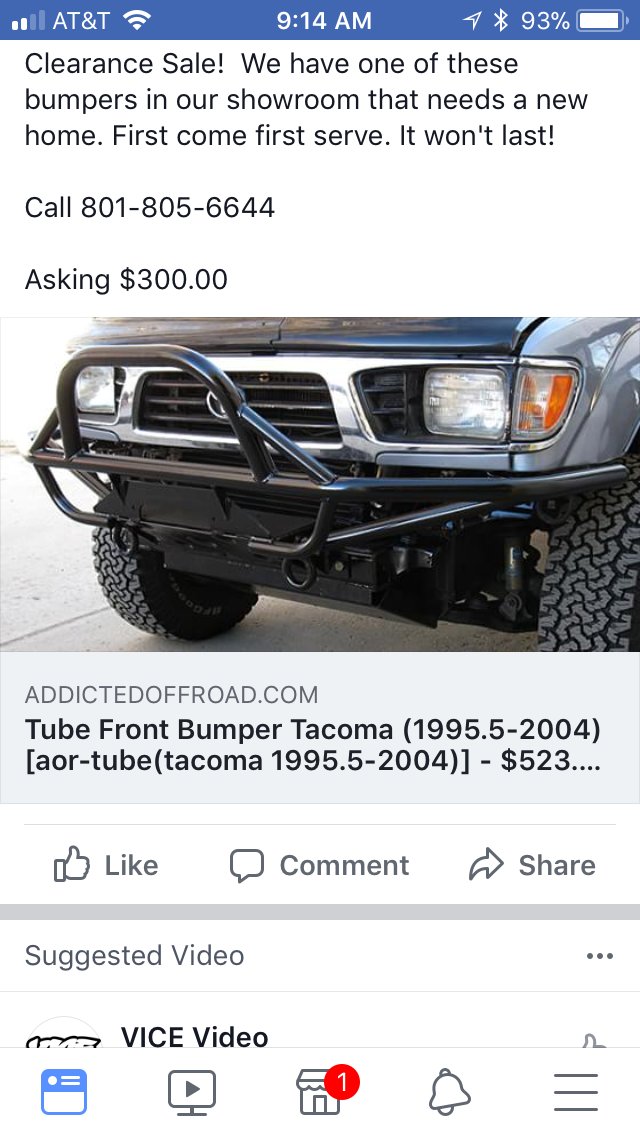

    Tempting
    Or if anyone’s interested, somewhere in Utah
