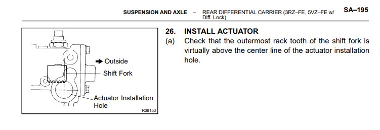

    Did you do that because you engaged the actuator? You shouldn't need to manually push the gear inside unless you are removing the third. If you pulled the actuator, you should put the actuator back with that gear inside in the same position. My best guess is the actuator gear and the gear inside are not even engaging.

    Found something finally. So it looks like it has to be in the lock position.

    Put in the lock position, mounted the actuator, turn key off, turn key on. RR lock light turns off so its unlock. GREAT. Try to lock, move passenger side wheel, move driver side wheel. Nothing.

    This is an e-locker axle you are installing right? But you did not remove the third, correct?
    If that's the case, this is likely what your issue is. This is what locked looks like:
    The teeth are covering almost the entire hole. You said you pushed it all the way to the right, which is the proper thing to do but to a point. Like the FSM says, those gears need to be visually centered in the hole, so basically seeing a little of it in the top right. Chances are if you barely see any or don't see any of the gear at all, the actuator has nothing to grab.

    Thing is it was able to 'unlock' when I put my key in. I know this because I had left the key in and went to reassemble by following the image I posted (locked position). Once I removed my key and put it back to 2nd ignition I heard the motor spinning to unlock so it had to have caught the teeth.

    Yeah but if your button was set to the unlocked position, and then you put the actuator back in the locked position, I would assume then that your actuator now pushed the bar too far over, and now when you actuate the locker button, it would need to go double the distance it would normally need to turn to actuate? Again just a theory, I know the actuator spins based on the internal contacts on the rings in the actuator itself. Someone please chime in if I'm retarded haha
