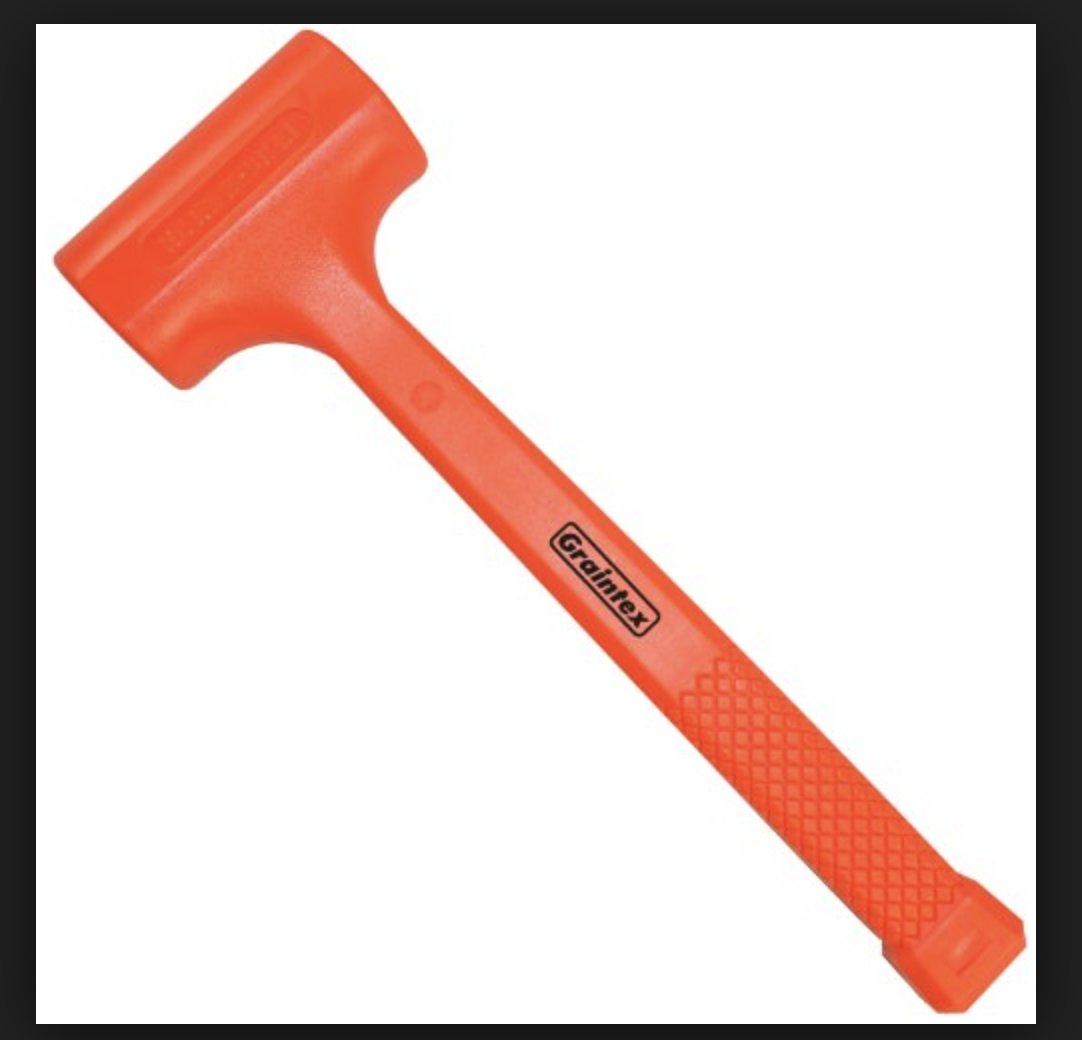

    How do I get this cv to slide the rest of the way into the diff?

    Gotta hit it with a big hammer/mallet

    Like the hub side?

    yeah that's what we had to do with mine when doing my CV swap on the trail. Used one of these to smack it into the diff once we got it in as far as we could by hand.
    I wouldn't go crazy and hit it super hard, give it a few soft tries and gradually increase until it's enough to pop it in.

    got it done, somehow managed to crack my phone screen in the process but the cvs in....

    Next time angle the C-Clip so that the gap is facing down. Throw some grease so it doesn't move and it'll ease the process
