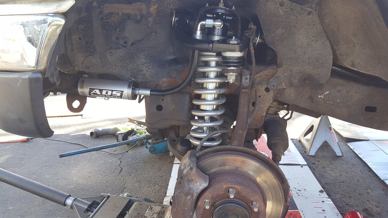

    Got the front all done. is it cool I just cut the u bolts off the rear? I'm not reusing them.

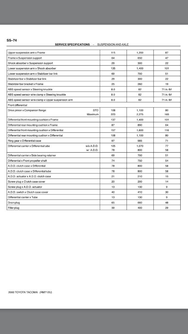

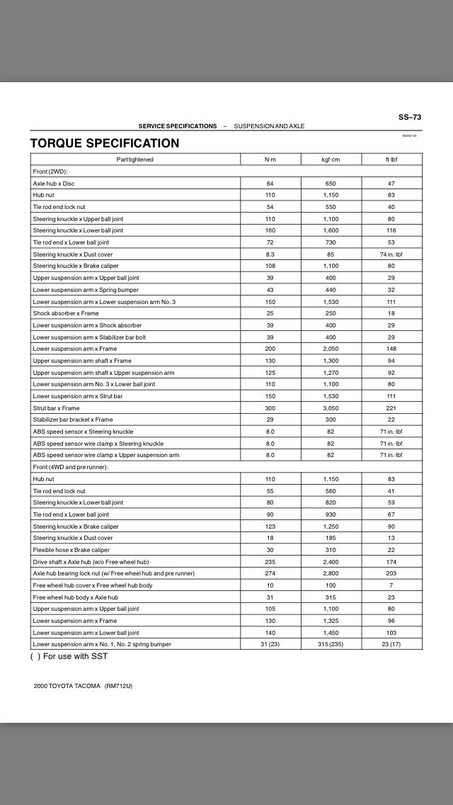

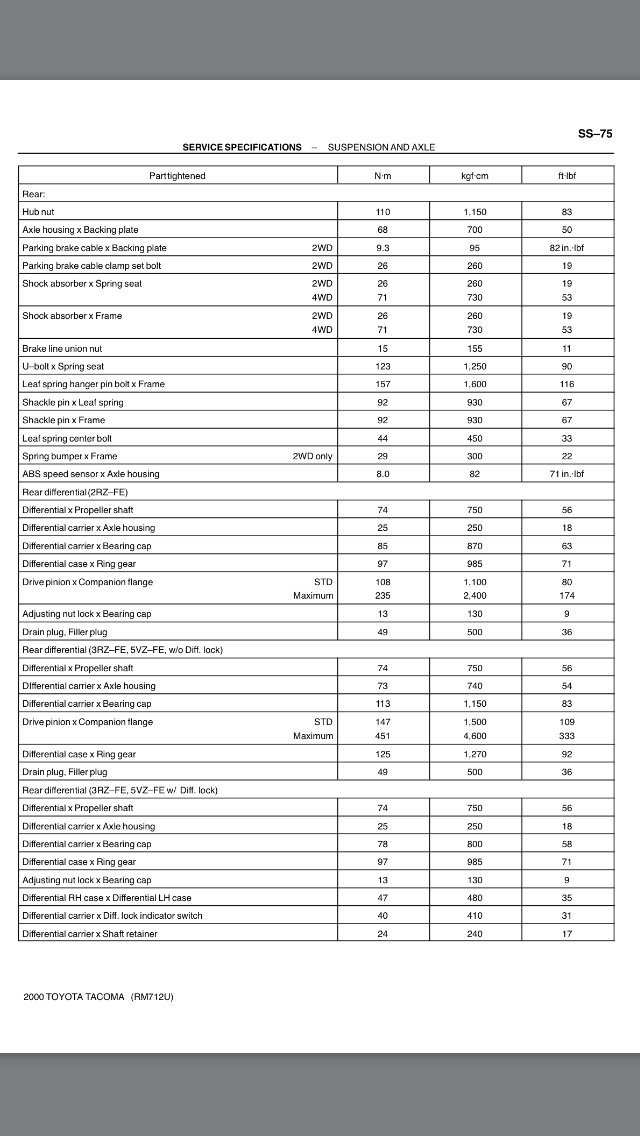

    How is this done? Link to a site or video? I've searched and can't find anything.
  10. Mar 18, 2018 at 12:37 PM
    1st4x4
    1st4x4 Well-Known Member
    Jul 7, 2014
    #133487
    1,309
    sam
    Torrance
    98 tacoma 5 speed 4x4
    tundra front clip, tundra brakes, cab cage, camburg long travel, archive garage rear shock relocate
    So I'm finding tons of different torque numbers on the b9lts for our 3rd member. I'm going to be swapping one out soon what are the torque specs for the 3rd member? Axle backing plate?

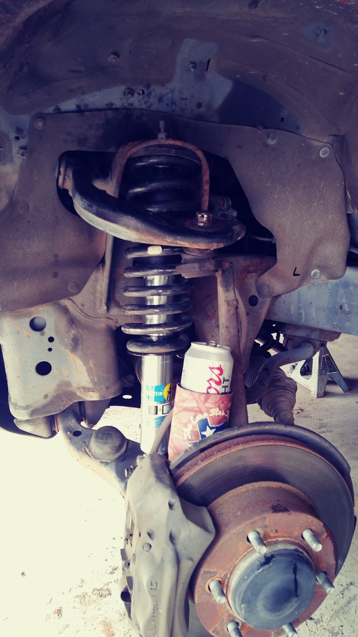

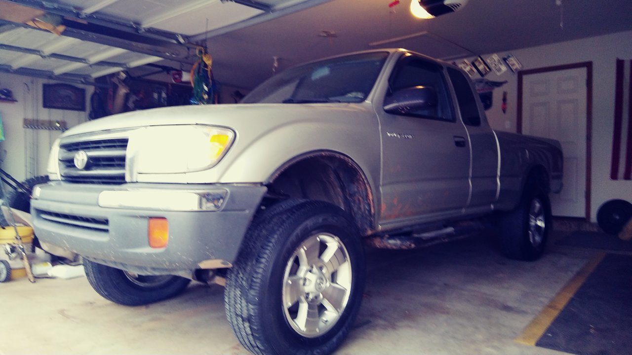

    5100s and new to me wheels

    Never mind found my own answer as long as it' the same on a 98 which I guess it is

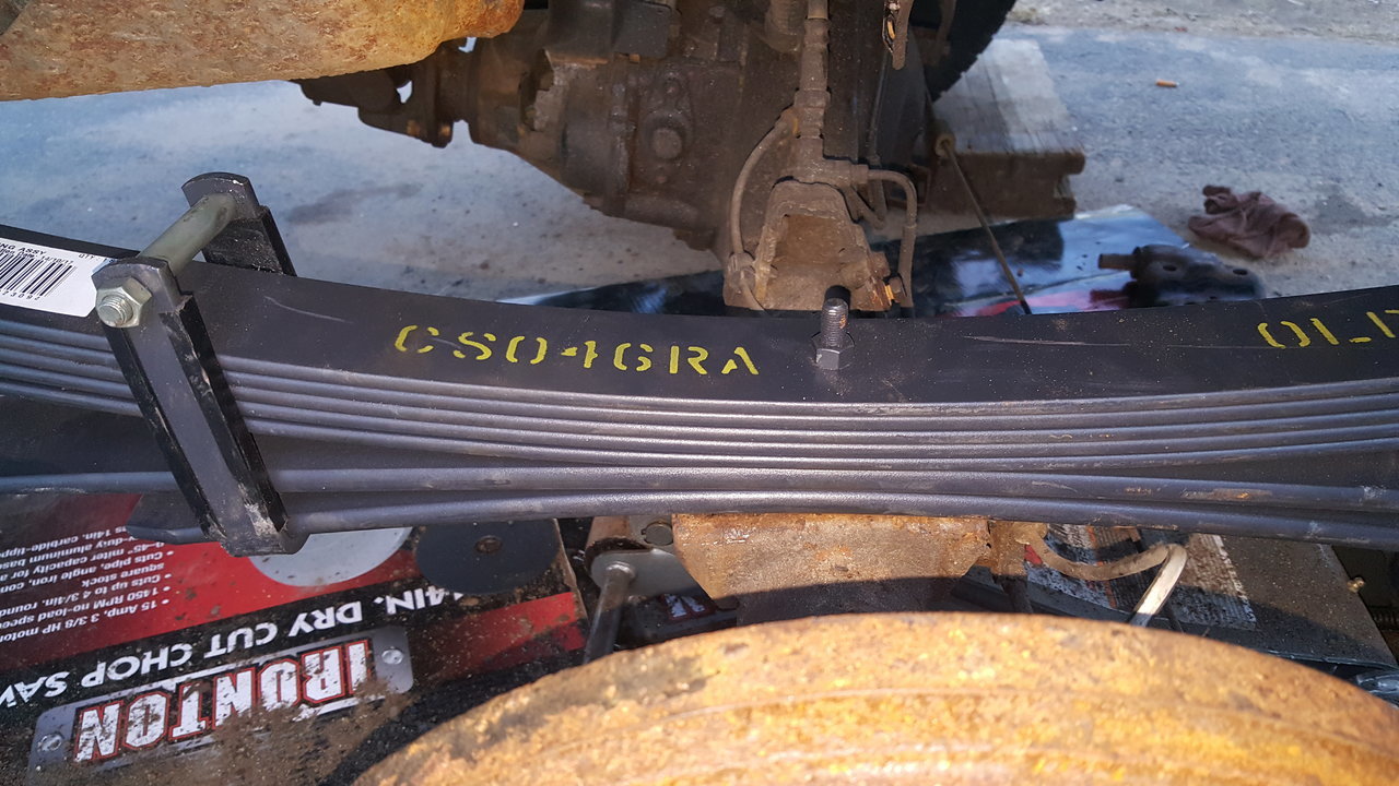

  15. Mar 18, 2018 at 3:45 PM
    Cid
    Cid ╭∩╮(◣ _ ◢)╭∩╮
    Nov 9, 2016
    #201947
    180
    Keith
    Waterbury CT
    2004 Taco 5spd SR5 TRD / 2018 HD FXBB
    ADS Coilover Front, OME Dakars with Nitro's Rear, Relentless Skids, BAMF Sliders, FN Five Star rims, 285/75r16 Falken Wildpeak, Aero Turbine 2525

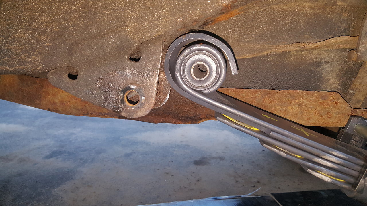

    I gave up for the day down to 30* but the front eye bolt is way off with the leaf center pin lined up. Am I going to be able to wrestle this son of a bitch into place? Any tricks?

    What yr is your tacoma?
  17. Mar 18, 2018 at 3:50 PM
    drr
    drr Primary Prognosticator
    Oct 17, 2013
    #114681
    2,775
    Dan
    Seattle-ish
    02 4WD Tacoma
    You'll just have to move the axle forward to get the spring hanger to line up, shouldn't be too hard if the axle is free to move forward/backward. This will push your wheel pretty far forward in the wheel well, I believe there was some discussion on this the other day. Pretty common with Dakars. You may need to get axle relocation plates to push the axle back 3/4" or so to center the wheel in the wheel well.

  18. Mar 18, 2018 at 3:55 PM
    Cid
    Cid ╭∩╮(◣ _ ◢)╭∩╮
    Nov 9, 2016
    #201947
    180
    Keith
    Waterbury CT
    Ok thanks I'll keep wrestling

    OH right, the shaft has a yoke that can either be extended or reduced in length..

    Put the front hanger bolt in first, then shift the axle to get it to line up with the centering pin.
