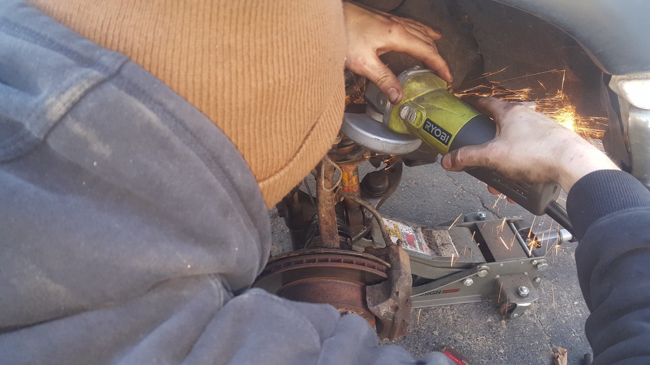

    Ok yea that's what we did to my buddy's 2nd gen but his wasn't off like this. I had to cut those bolts so I gotta grab some from the dealer tomorrow. Haven't begun cutting the other side apart yet would it be easier to have everything free or keep the other side bolted in til driver side is done. We did one at a time on the 2nd gen but like I said we didn't need to move this far.

    Remove both sides first. Then mount front then center axle then mount rear

    Ok thanks I'll cut the other side out

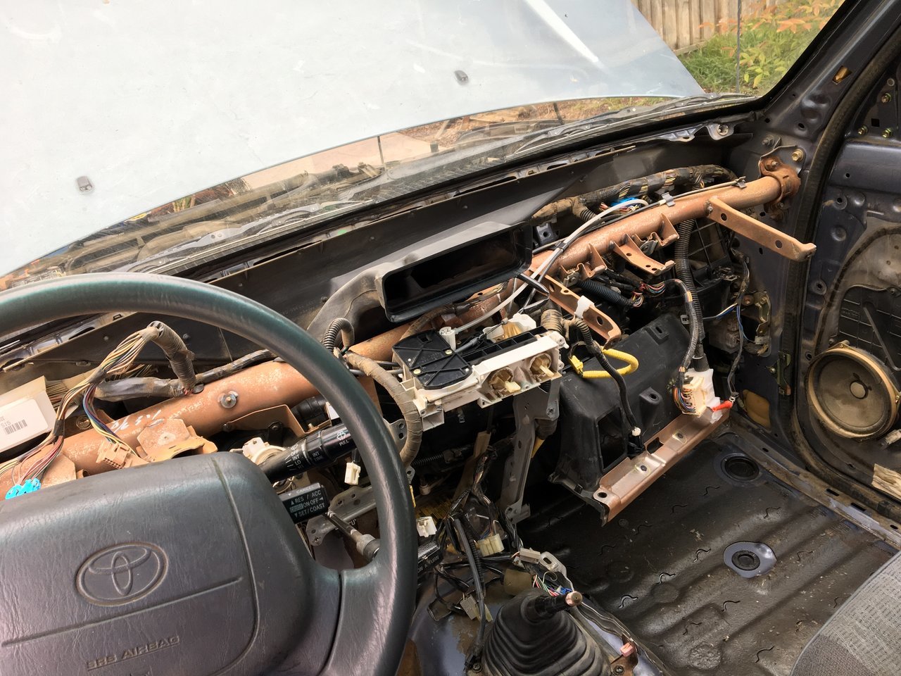

    AC Doesn't work. Climate control doesn't work - the temperature and blend/vent knobs are all jammed and the blower motor is dead.
    I tested the blower motor with 12v, nothing. But the harness does get 14v so a new motor should be all it needs. Hoping the AC compressor is good.

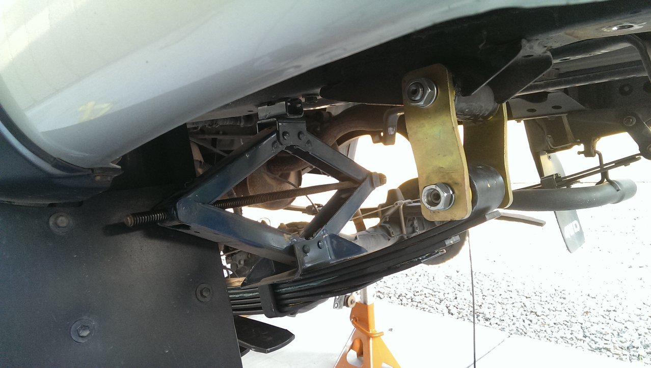

    I ended up putting the front bolt in the using a scissor jack to push down the pack to line it up... PribProb not the safest but it worked really well...

    That's the way I did mine as the rear shackle moves and the front hanger doesnt

    Shit that's great. If I can't get it with everything free I'm going to give that a shot
