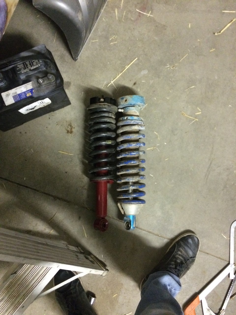

    JKO1998
    JKO1998 Well-Known Member
    Jun 2, 2015
    #156578
    52,955
    Utah
    What a sad time....
    Don’t abuse your Kings people.....

    What did you do to them?
    tony2018 likes this.
  8. Mar 22, 2018 at 9:28 AM
    JKO1998
    Jun 2, 2015
    #156578
    52,955
    Utah
    They need rebuilt, that’s about all haha.
    But they look like trash.

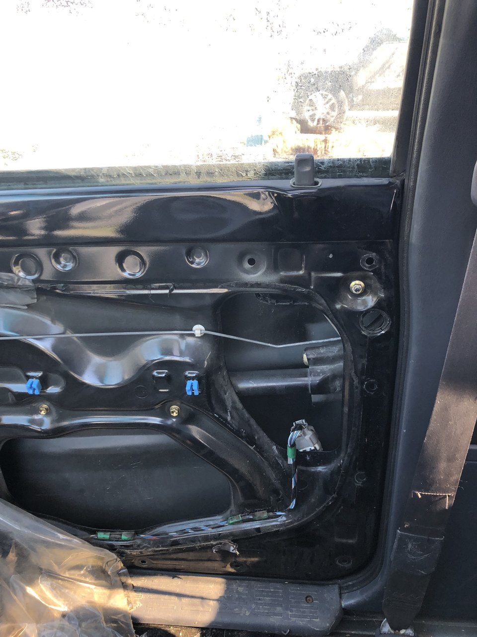

    Got the door open last night and this morning to take my dog to the vet and when I got home to let her out the door wouldn’t open... I have the panel off currently. Something with the locking system isn’t working because the locking knob thing won’t move much... Anyone have any ideas on how to get this thing opened up?image.jpg

    You should be able to pull on one of the rods and open it if I remember right

    I've taken these doors apart more times that I'd like to say. Pull on that long metal rod towards the engine and the door should open. If the metal rod has become detached or doesn't do anything, stick your hand in the door and pull on the metal latch the rod is connected to.

    Are you both talking about the door handle rod? If so that works fine but something is up with the lock.... like it won’t disengage or something.

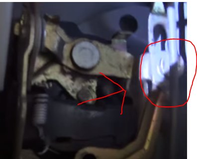

    Sounds like your door is stuck locked? I recently had this happen to me and this video help me out: https://www.youtube.com/watch?v=CcYaJKlhX5s
    I didn't take my seat out, but it was a pain in the ass to get the panel off with the door stuck shut. Shouldn't be your problem as your panel is already off, look at the video around minute mark 8:10. You can push up on the portion I circled in red (below) and that will unlock the door and you'll be able to use your handles again to open the door.
    My spring is broken like in this video, you may have the same issue. You will want to remove the window rubber guide to see the full locking mechanism, easy, two 12 mm bolts I think (maybe 10mm) then the guide will bend up and out of the way exposing the mechanism

    @Teke Do this, this is how I get doors open at the junkyard when the locking mechanism is broken.

    Is everything connected properly in the door handle? Those two metal rods have to clip/snap in place in the plastic retaining clips for the handle to function like it should.

    This is very unfortunate as the the safety bar thing in the door has screwed this all up for me. I might have to bust out the sawzall and cut the bar out...
