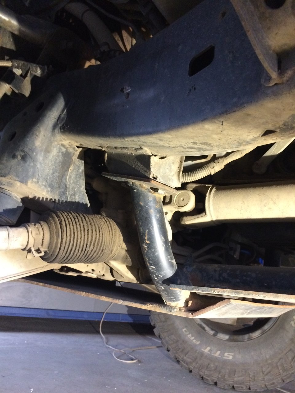

    Final check before I do a couple things - ADD is a useless system once you have manual hubs right? I have a j-shifter. I'm going to take out the whole system so someone can buy it for a 4x4 swap if they want it. I'm assuming the big cylinder in the driver's side wheel well with the vacuum line going to it is only used for it as well and can come out too, right?@BartMaster1234
    Second, what are these brackets for? My truck never had a sway bar since I bought it so I was thinking they were for that - either way I think I'll zip them off with the grinder while the engine's out since they keep getting in the way. Thanks!

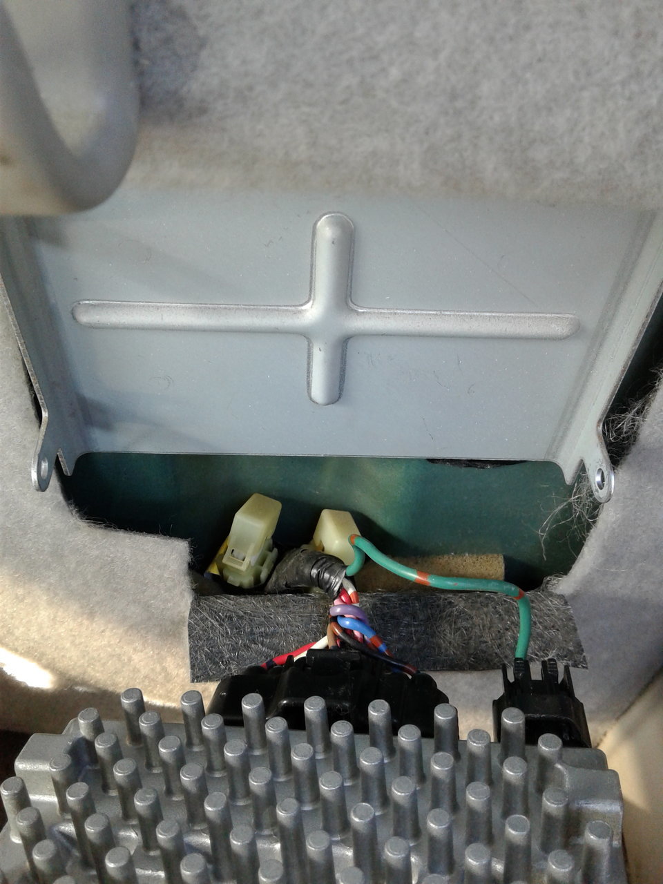

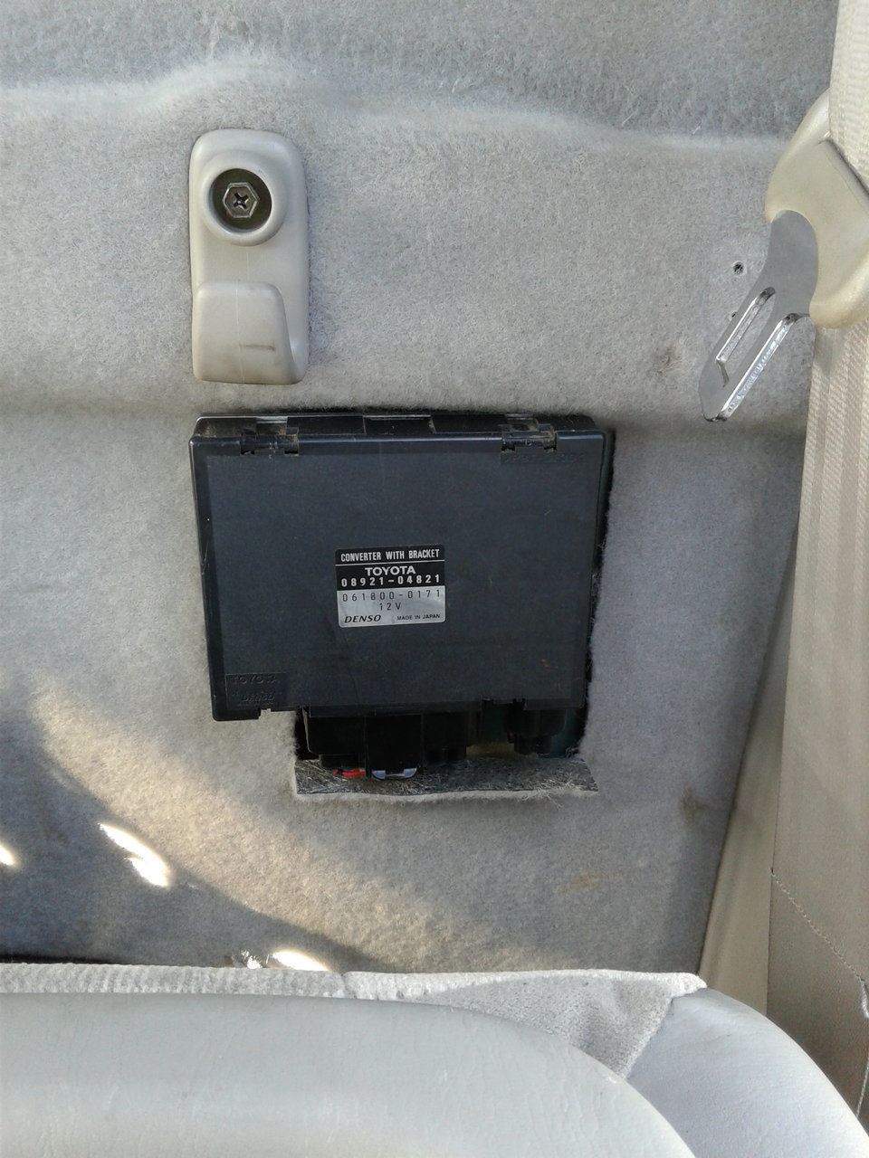

    This is for a factory-installed trailer hitch and wiring.
    There is a small black box 20180324_161445.jpg behind the driver's
    Remove the box from the back wall by removing the 4 phillips head screws. I used a ratchet with a phillips bit for the right side as there is not much room.20180324_165121.jpg
    Behind it is 2 inline fuse holders labeled brake and turn.20180324_161457.jpg

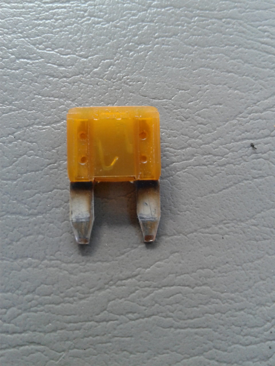

    I opened the brake fuseholder and found this.

    You could test it with 12v to see if it's still not working when receiving full power or do a voltage test to see if it's receiving full power.

    That mount is for the sway bar. You don’t need it #becausebadasssolokitbitches! But I use it to mount my skids.

    That's awesome. I may leave them and do that eventually. Thanks man!

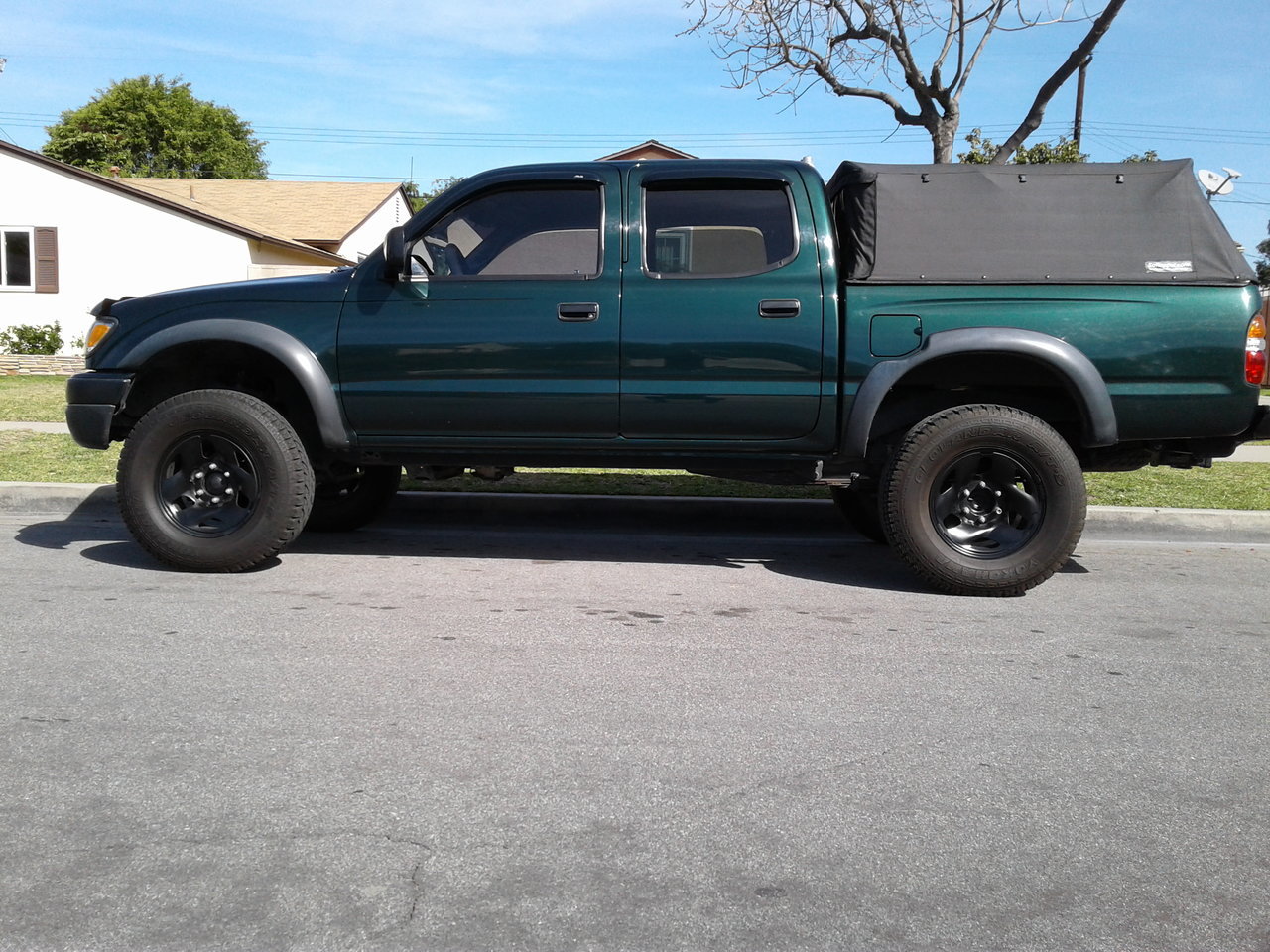

    Diff drop ordered. I got it figured out. My old suspension had sagged severely. (My leaf springs are practically upside down and my old coils appear to be progressives yet they aren't supposed to be). So I figured it sagged 1.25-1.5" over 15+ years of sitting with a camper shell on it (previous owner barely drove it, 46k on it when I got it last year) and I always thought it sat low compared to other tacomas. So in short, my 5100's brought it up to stock height plus maybe 1.75". I remeasured the lift, 3" not 4" like I said earlier. My UCA's appear to be at an acceptable angle so I'm not concerned anymore.

    Oh if you do. Don’t use round bent tube like me. Use square tube. Notch the angle and weld it. Add a gusset on the inside of the angle. Wish I would of done it like that. Would be way stronger.
    The problem with bent round tube is when you put weight on it. It bends back out. Not a hole lot just enough to piss you off when your trying to get the bolts in and out of that mount. Lesson learned and sharing wisdom.
