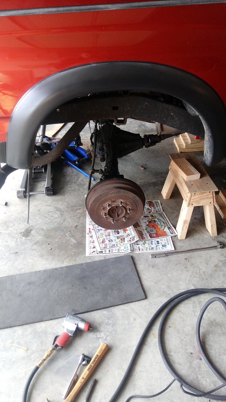

    To anyone wanting to replace their leaf springs, forget the sockets and wrenches. Buy a saw-zall and start snipping. I tried wrenching, then got one with a cobalt blade and went to town.:sawzall:0325181820.jpg

    A grinder and a cut off wheel works great also haha. I’ve done that to multiple u bolts

    Yup, clip the u bolts, leaf spring front bolt and in my case the tailpipe hanger cause of my ome exhaust bracket

    I used an angle grinder when I replaced my springs. There was no way those bolts were coming off with a wrench. Even if they did, I wasn't going to reuse them.
