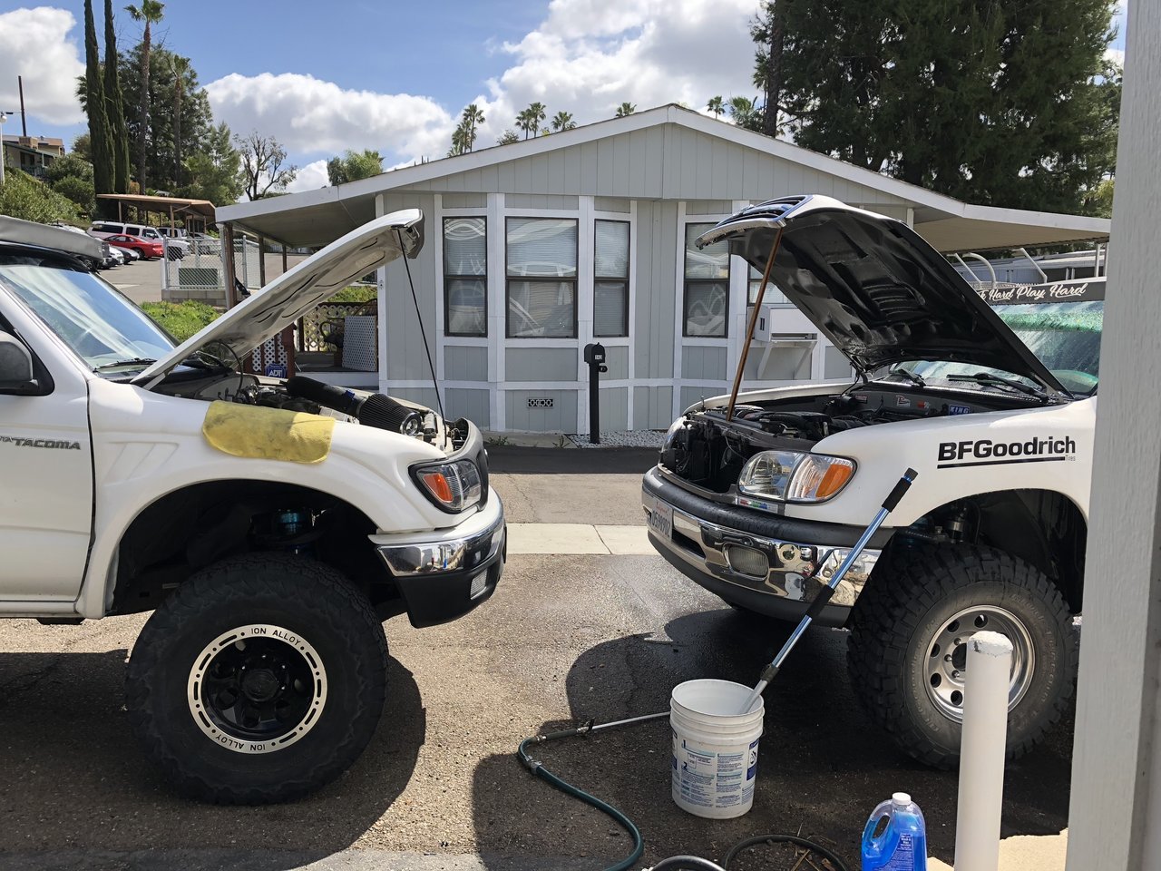

    8CBDD728-86B9-4C9C-942A-9FF4AF26D018.jpg Installed a Cold Air Intake on my truck. Gunna run it for a few days and see if I’m gunna buy it off a friend for $100
    No heat shield included.

    How do you keep your engine bay so clean?

    I literally just cleaned it about an hour before I installed the CAI and took this picture. It was thrashed from the desert yesterday.

    I wish my engine bay looked that clean I'll pay you to detail mine haha mine Is also trashed from desert trips. What did you use to clean it?

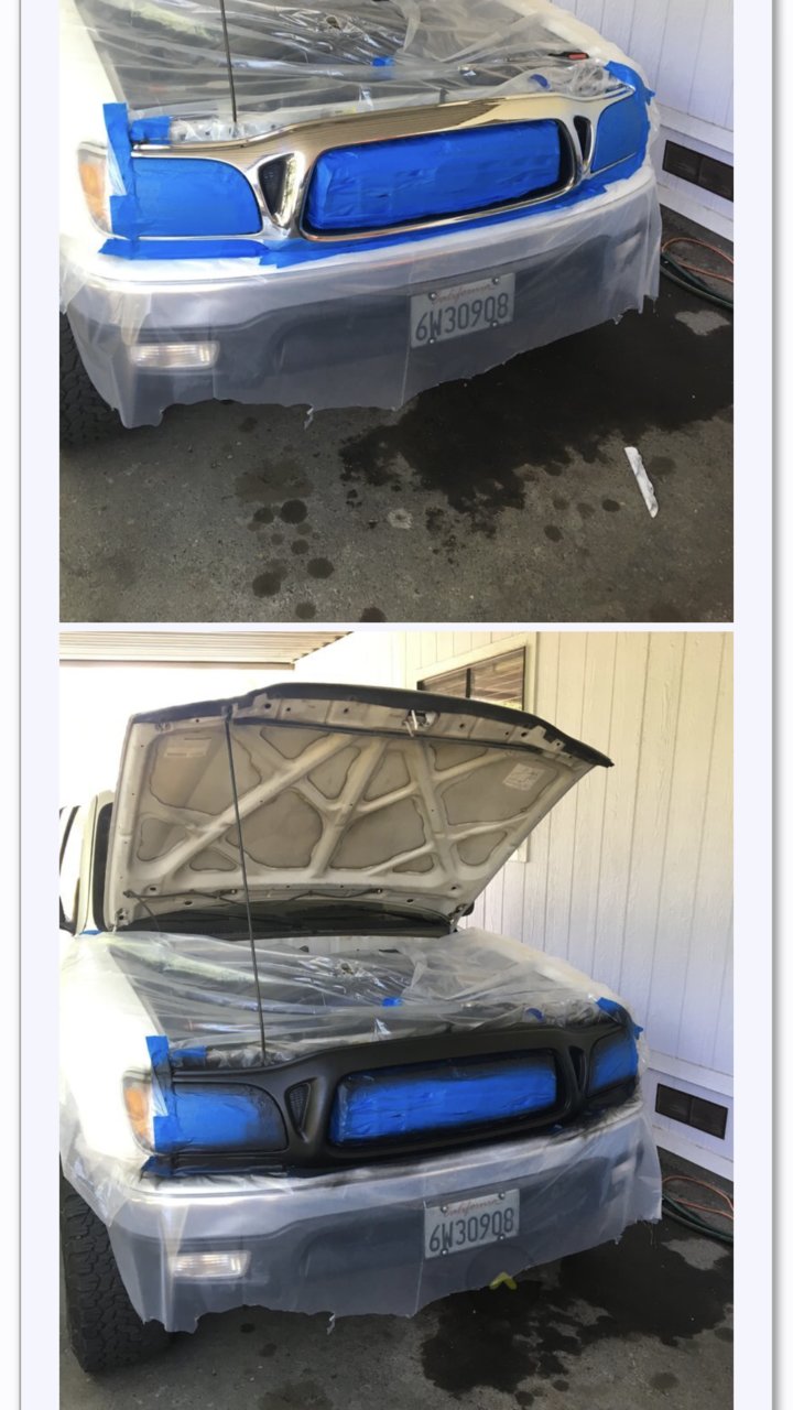

    Taped everything off.

    Hahaha. I recently just started to clean mine.
    Me and my buddy use diluted simple green and a power washer on a low setting to clean ours. We use a low setting to prevent blasting water into electrical components. We hit plaster city all day yesterday and had a cleaning party today. It was super windy and the dust was insane. Sand EVERYWHERE.

    Does simple green not affect belts and gaskets? That the main reason i haven't used a degreaser yet

    It seems like cleaning the engine bay is a topic that’s a bit controversial. Hence the reason why I waiting so long before I finally just did it. My buddy has been doing it for years on his first gen tundra using diluted simple green and a power washer with no ill effect so I jumped on board. But I honestly couldn’t tell you with any certainty what kind of effect it had on gaskets or belts. I would imagine us watering it down makes it not so chemically harsh on those areas.

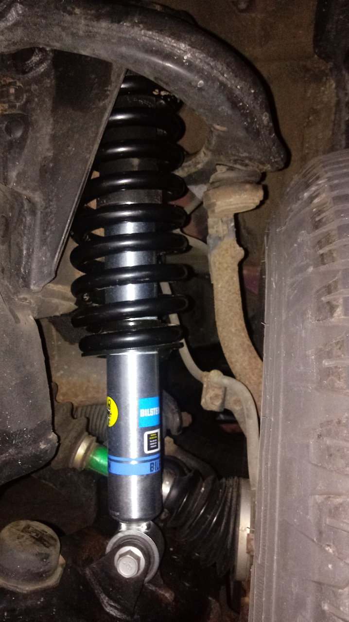

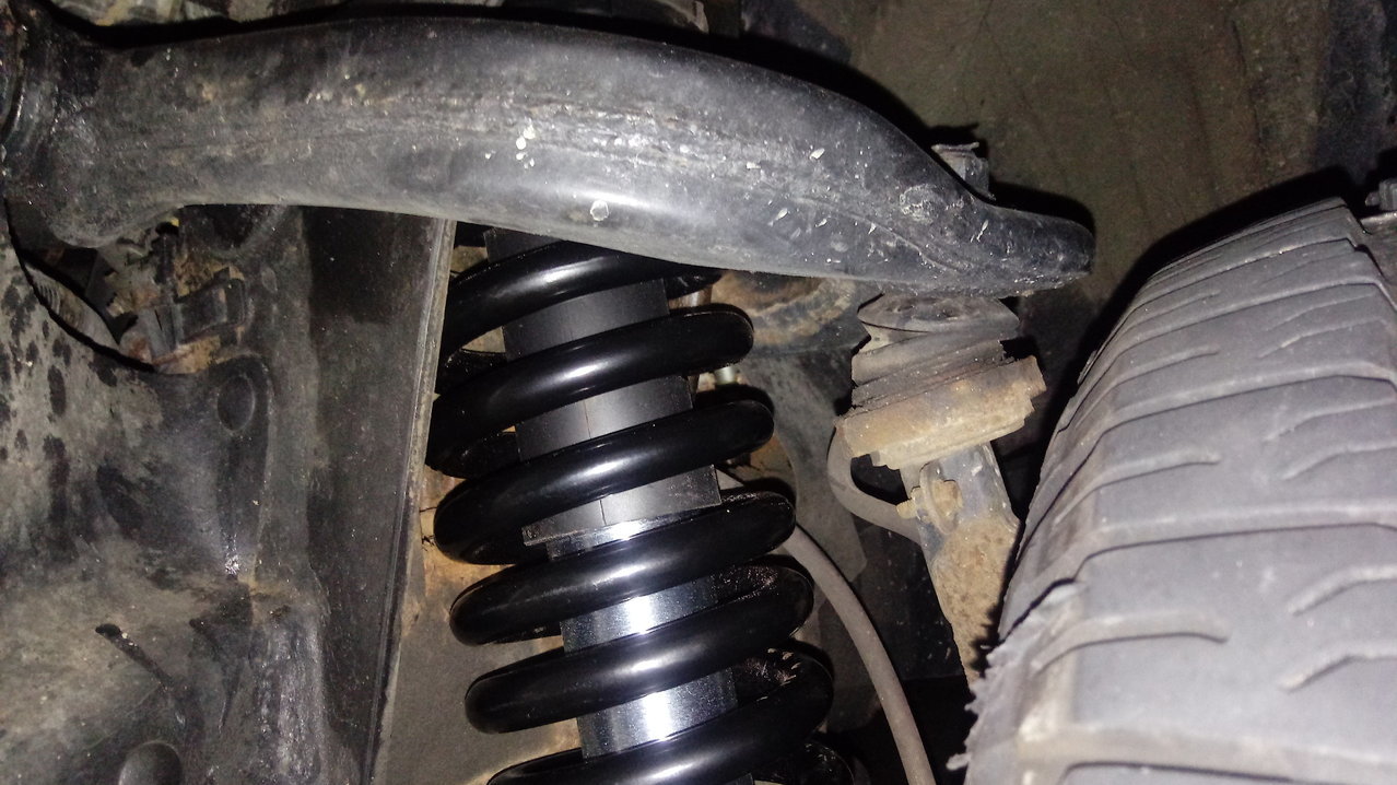

    Quick question, I was wondering if the angle of my upper control arm is acceptable or not. (Yeah I know about my CV boots, diff drop is on order)0325182040.jpg 0325182040a.jpg

    Diff drop isn't going to help those CVs. you need to lower your lift.
    UCA looks in pain as well.

    Great... I put 5100 at 1.3 with moog 81102 coils. I dont underatand how this happened. Spring seat isnt upside down either.

    not sure on the specs of that coil.
    but 5100s have 0'' and 1.5'' and 2.5'' settings.
    They are also brand new coils.
    I'd set them a 0 for now. let them settle a bit. Then try 1.5'' again later.
