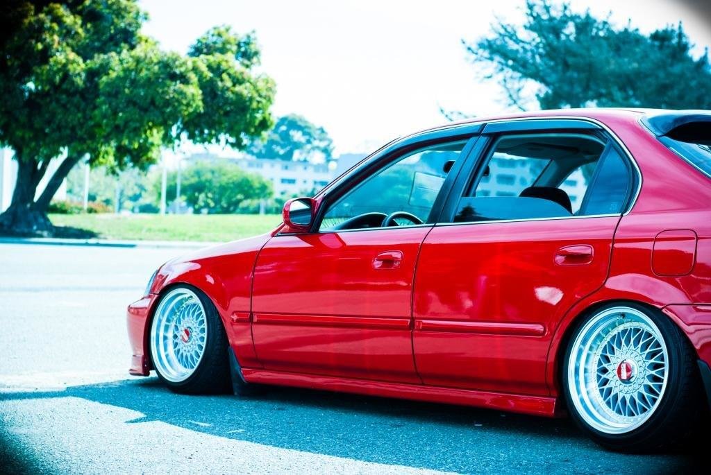

    I dumped so much money into my hondas, chrysler 300, caddi cts-v, and gsxr600. I wish i would have dumped it into a truck . 1 tons and 44s wouldnt be a dream. Do it now man, it aint as easy once you have kids

    Always wanted to ask someone who's done it.... what's the point man? They're FWD and have economy car suspension... like what's the motivation to bother?

    It wasnt for speed. Lol. Idk man, always enjoyed slammed cars. I mean slammed. One of many
