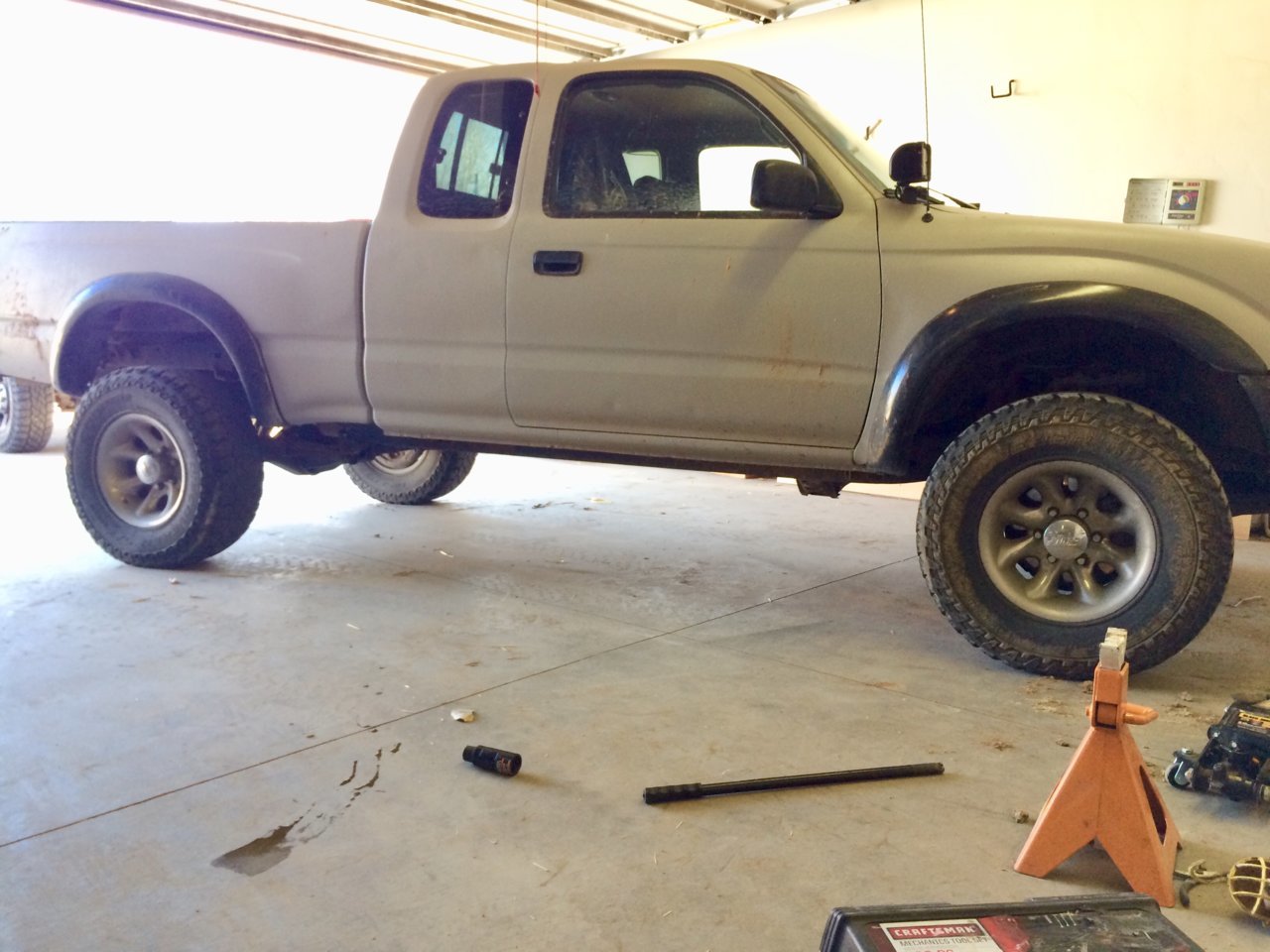

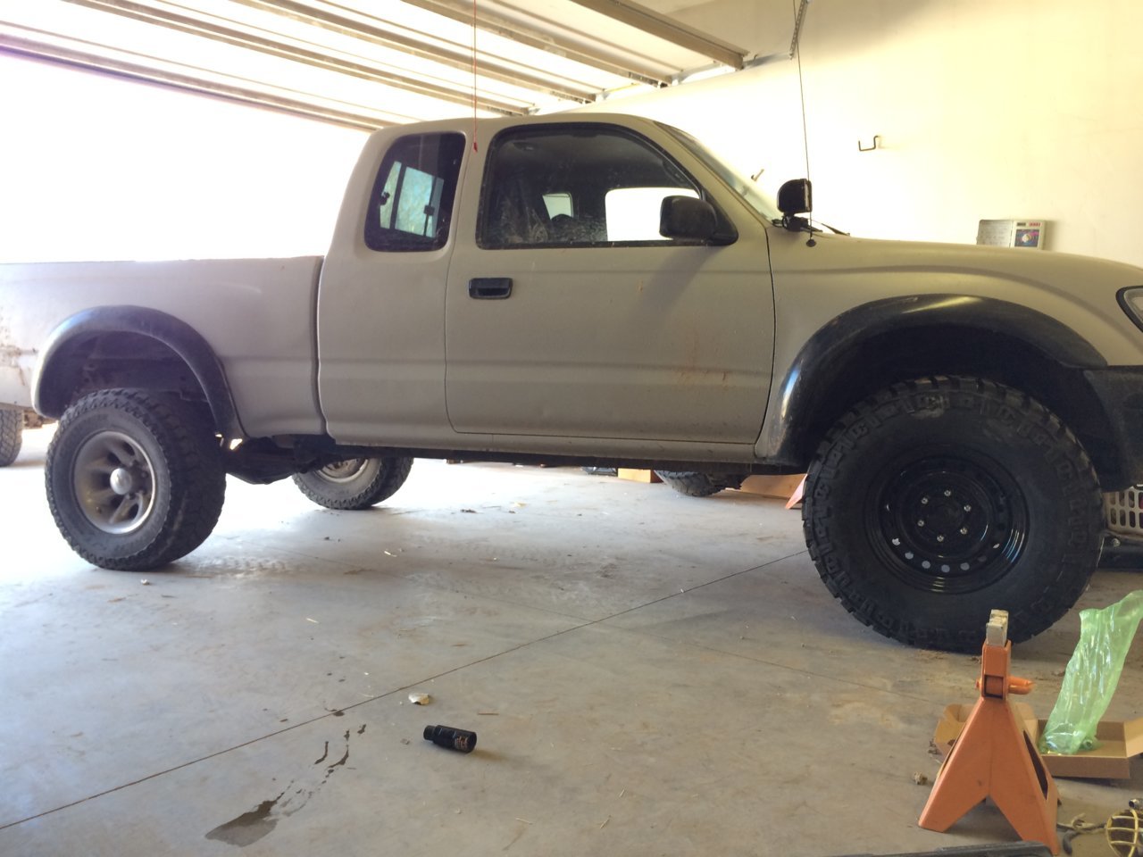

    Fabtech Fts205 is what it is I havnt measured or driven the truck yet, by it lookes to be more then 1.5 inches I have 5100 set at the top setting and the front was noticeable higher. So far with the aal the rear is noticeably higher, but I'm hoping that after few miles it will settle down and be about level

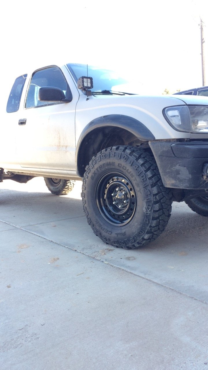

    I like those wheels. They look good.
