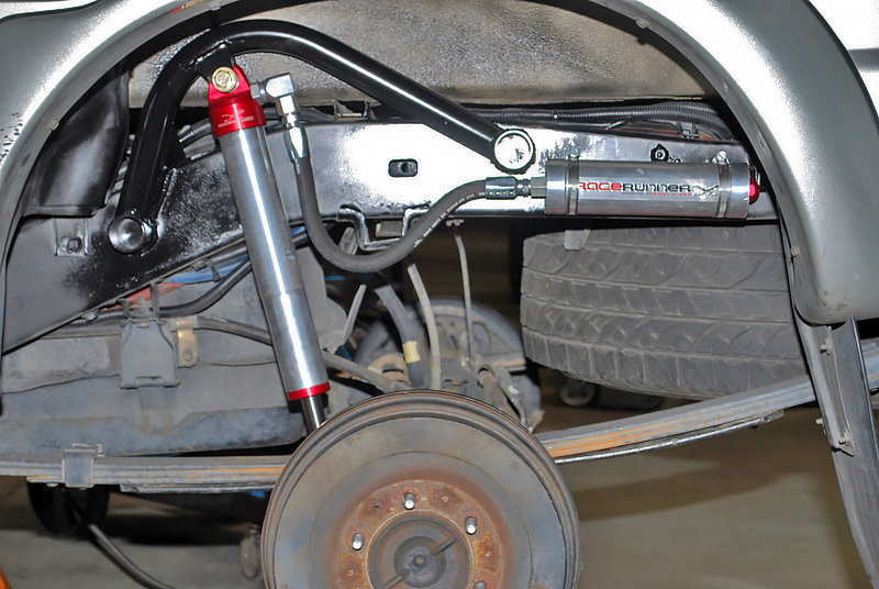

    I would just get the tabs separate to weld on yourself with the shock on hand. The only kit that comes with the uppers already setup is the total chaos kit which has specific specs for shocks to work.
    other wise its impossible for the fabricator to know what shocks your running and the exact configuration.
    On top of that, just get the solo kit if you want a kit like that. Not sure if that guys are cheaper or not but either way you won't be able to run a shock bigger than 10'' any ways as your leaf packs won't cycle more than that anyways.

    The 2nd image is a better design then the one in the 1st image. I wouldn't trust the bends that go into the frame. Those bends will give and flex more then the other one that is cut and welded to another tube that is welded to a frame. just my .02

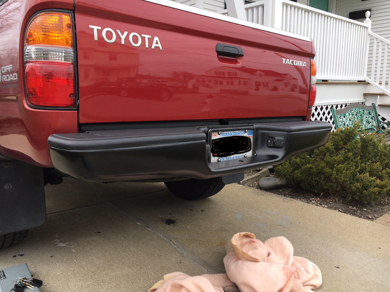

    One near rear bumper. A Grand Prix decided to drive under my chrome one a few years ago and cracked the chrome, it was starting to rust so a standard issue black off ebay for $79 was installed today.

    The solo kit is 300 his is 60 so a huge price difference. I was thinking solo but for the price idk. And I was thinking that just as I am now. I'm running 14in shocks if I ever change leafs then I'll have the shock for it, or if I got shackles wouldn't I get a little more travel?
    It also has supports that go to the top of the frame think that helps with the flex on the hoop. This is a better picturedorp_shock_hoops.jpg

    Cool. That will do.

    Does it matter which way the shock eyelet goes? Such as bolt going threw shock same direction as frame vs as if it were going threw the frame?

    not really. the SOA setup is the limited factor with the stock geometery. idk how your running 14s right now without seriously limiting your up travel.

    I have a bed cage. If anything I'm probably limiting down travel right now.

    okay..sooooo..if you have a bed cage..why are you wanting to do shock hoops?
