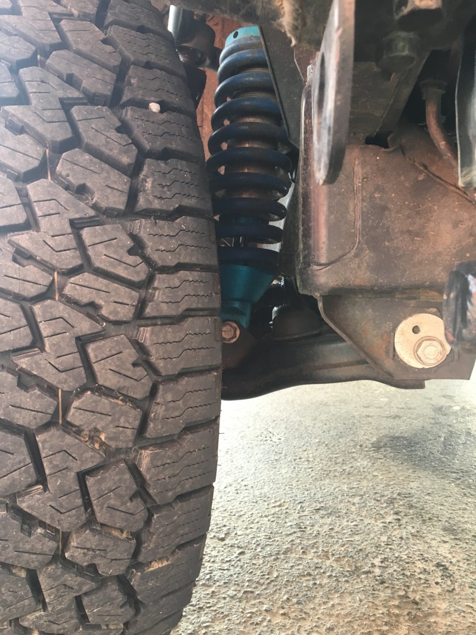

    This still sounds like you are running out of spring. Either that or valving.
    Which coils do you have on your kings? Are you heavy upfront? Full skids, bumper and winch?

    You'd want a very short bump. Like 1.5'' which im not sure you can get. They make shorties for 3rd gens now though
    Plus hydros on the LCAs are the least ideal way to run bumps. You bump the last like 3'' of travel which sucks. Not even ideal for LT setups. I don't think it would be an improvement in overall ride quality.
    I've seen this setup. Though it was a LC 200 though.

    No the ones some folks run are different.
    I am fairly certain the front bumps vs the rear are a different compound making one softer than the other..but I can't remember which ones are softer..

    Coils are 3.0-14-600’s
    Not crazy heavy in the front although the truck is kind of a tank.. no belly skids, tube bumper and winch with synthetic rope. I was still having this issue pre winch install..
