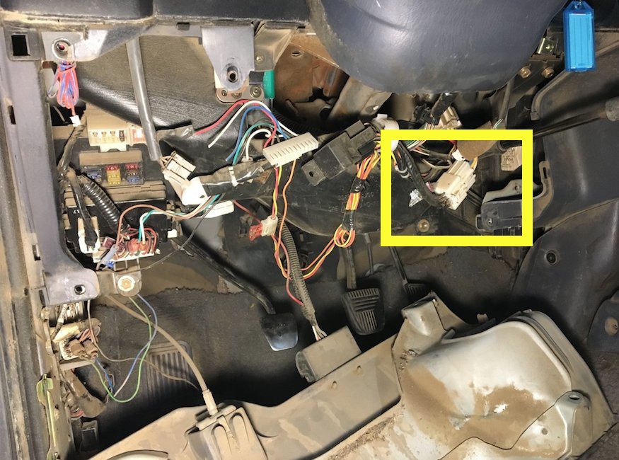

    Who knows a thing or two about ignition wiring?
    Upon taking out the rats nest of wiring out my 5-lug, I found a sort of jumper/coupler wiring harness that was connected in-line with what I believe is the ignition system wiring. I unplugged it from both sides and plugged the OEM harness back in. I was about to throw it away but I thought if it is for the ignition I could use it for my PreRunner to hook up my remote start system so I don't have to splice anything and unplug the system and return it to stock if I want to. Any ideas?
