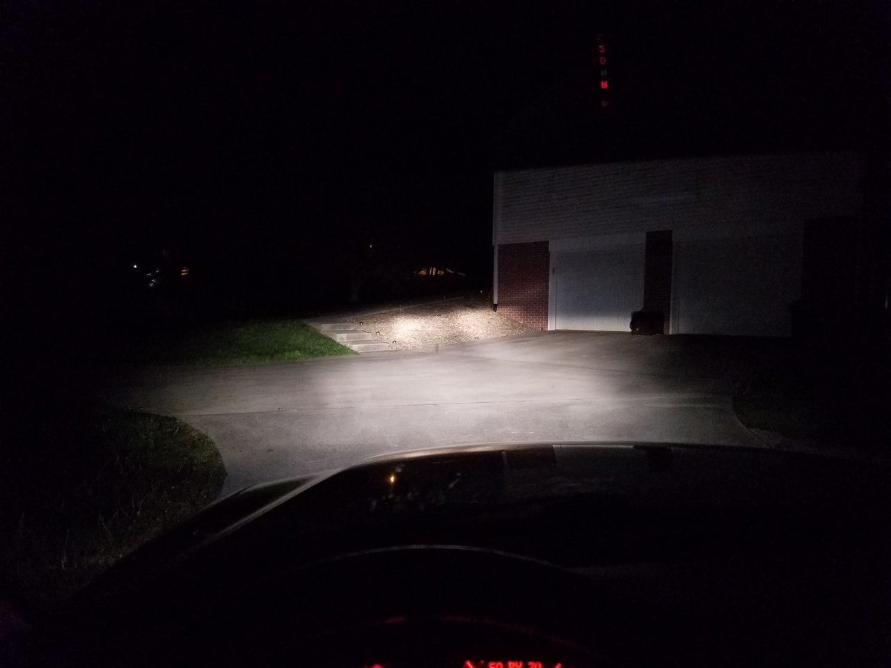

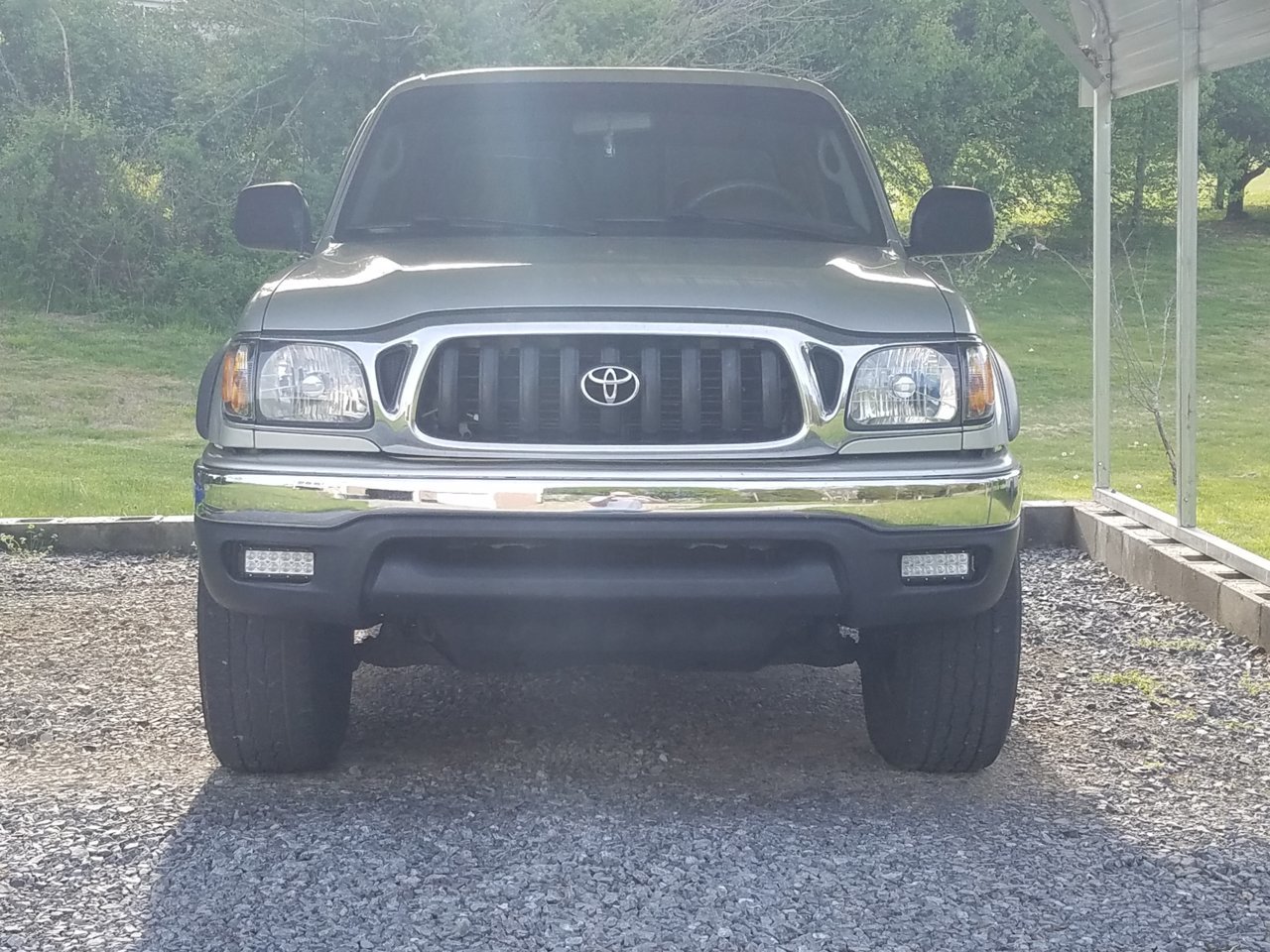

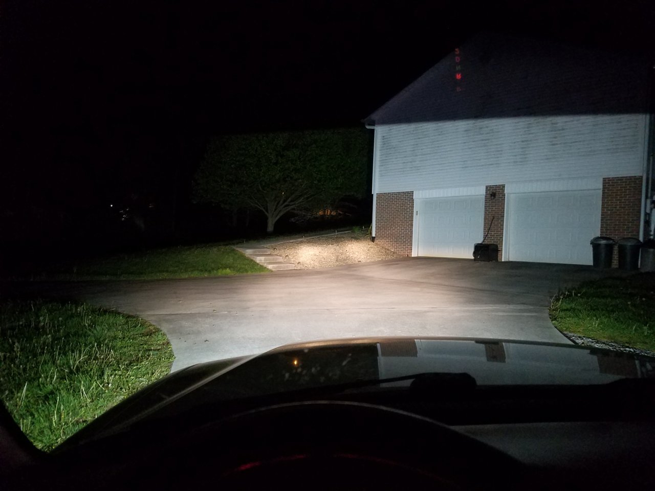

    I finished up installing 7" auxbeam flood led pod/bars in the stock turn signal holes in the lower valence. I had previously done the turn signal mod so I didn't have that to worry about.
  14. Apr 11, 2018 at 3:43 PM
    nzbrock
    nzbrock Well-Known Member
    Jan 6, 2013
    #94572
    3,253
    Noah
    San Marcos, TX
    99 TRD Prerunner 3RZ
    SAW 2.0 Coilovers Wheeler's 5 Leaf + 3 AAL Bilstein 5100s LCE long tube header Flowmaster Delta 50 Muffler FJ Trail Team Wheels 4Runner overhead sunglass console 4Runner leather seats All LED lights Red/Clear Tail Light Tundra Brakes HID Projector Retrofits 4Runner Auto Up/Down Windows Bullet Liner Cargo tie down system E-locker axle swap w/4.56 Gears ARE MX Cap Prinsu Toprac Custom heated turn signal/puddle light mirrors Volant Intake Tube
    Can you watch your fuel trims climb with a live reader? If so, I would pull vacuum hoses one by one and plug them and see if your trim changes. If your short term is that high you should see an obvious drop when you find the culprit. With numbers that high I would think you could hear the hissing from the leak.
  15. Apr 11, 2018 at 3:44 PM
    Tim7902
    Tim7902 Well-Known Member
    Sep 24, 2016
    #198129
    163
    Tim
    Maryville, TN
    2001 tacoma doublecab
    With headlights on only and then with the headlights and pods on. I've not had anybody flash me since I've installed them even though they look to throw out alot of light.

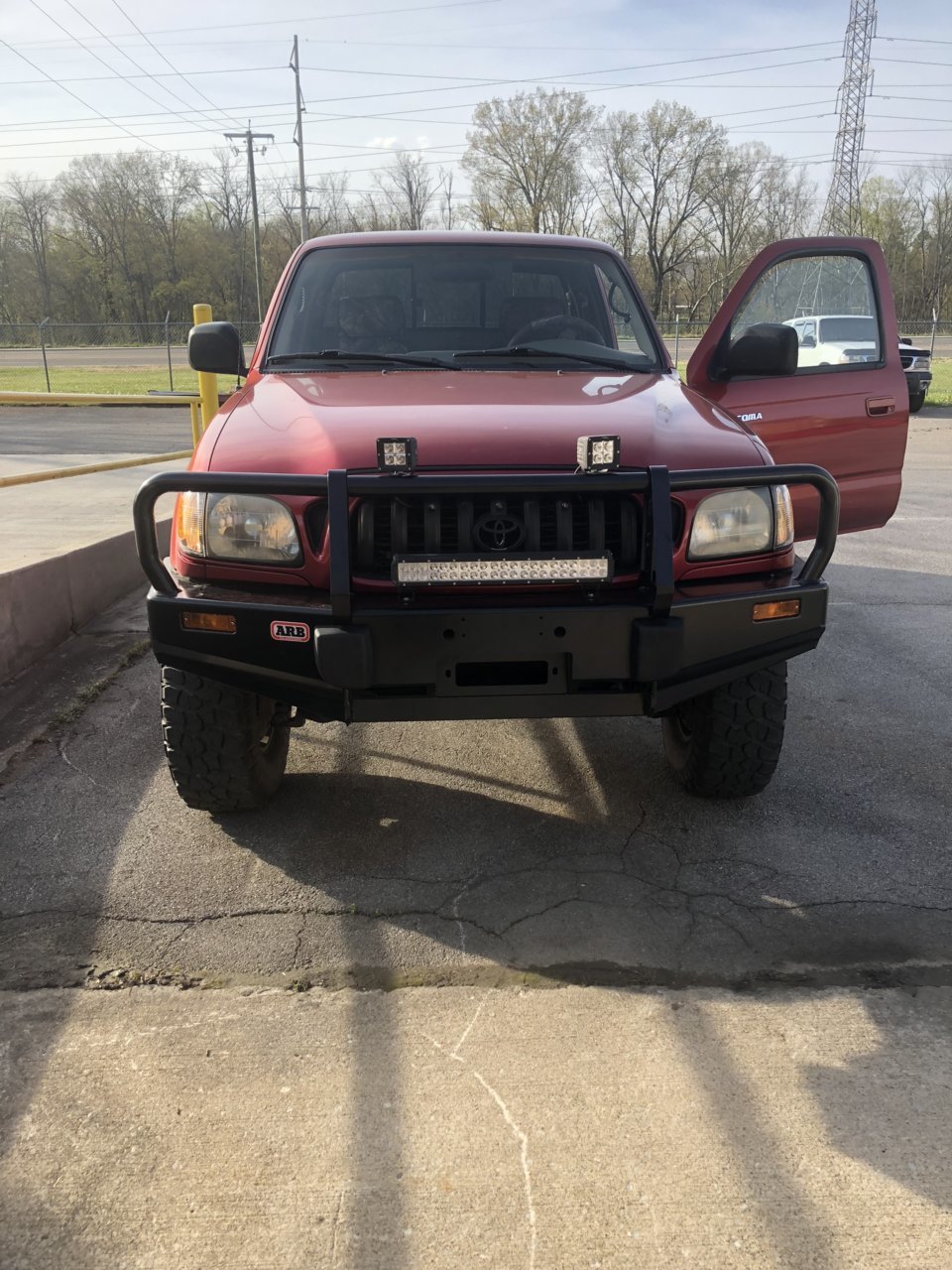

    Added a couple pods and a bar to my new ARB bumper. Have other ideas for lights on it but already had l these.BF48AFAF-E922-4667-A632-CC245E916629.jpg

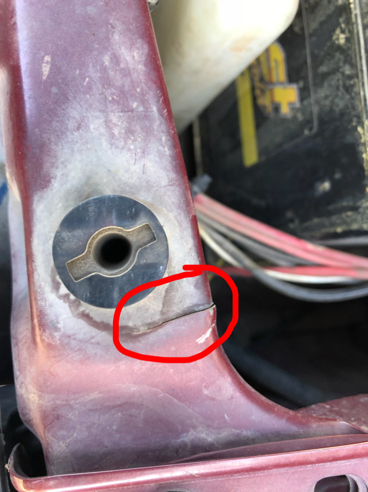

    Anybody have this happen to them on their upper radiator support. This crack was on the drivers side next to the rubber hood stopped. Common in first gens?
    I’ve only heard about upper radiator cracks in the 2nd gens. Should I butt weld grind then plate or just drill a hole at the end so the crack doesn’t continue? Or no biggie just leave it. It’s about 1/2” to 3/4” long
