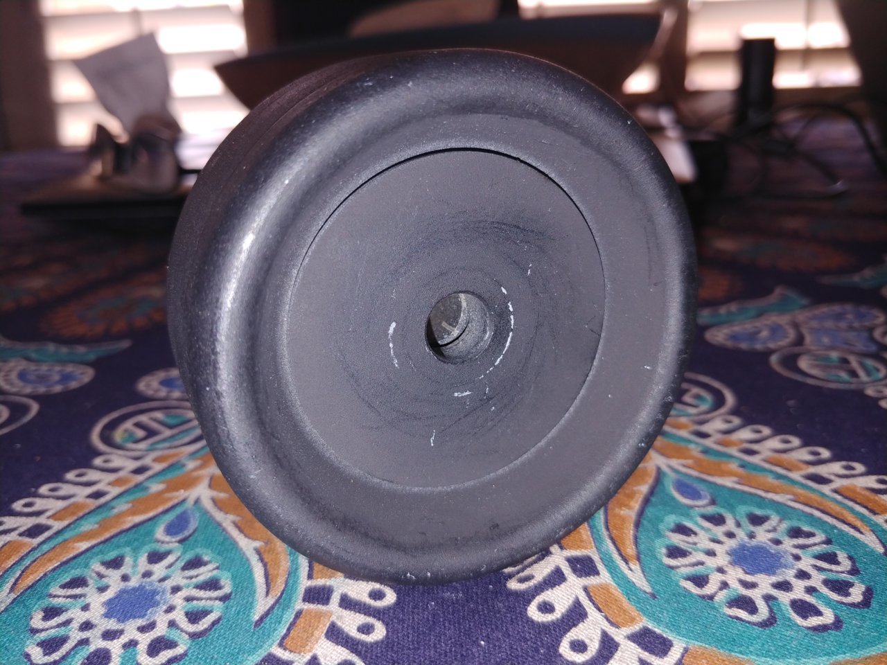

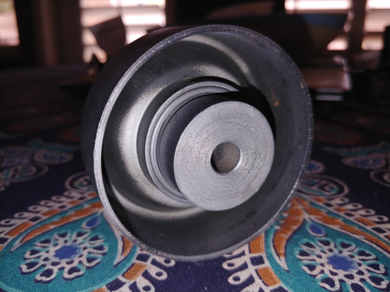

    Reserected from the dead.
    Haven't cought up on all responses yet, so dont hate on me if someone else responded.
    Can heat up the outer portion with a propane torch and hit the inner part with some key board duster air? Turn the can upside down and the contents will spray out super cold and will shrink the metal.
    Maybe this will help you get them apart.

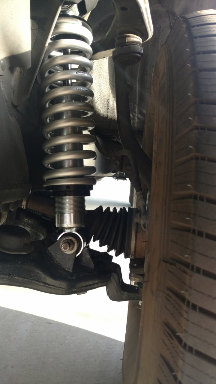

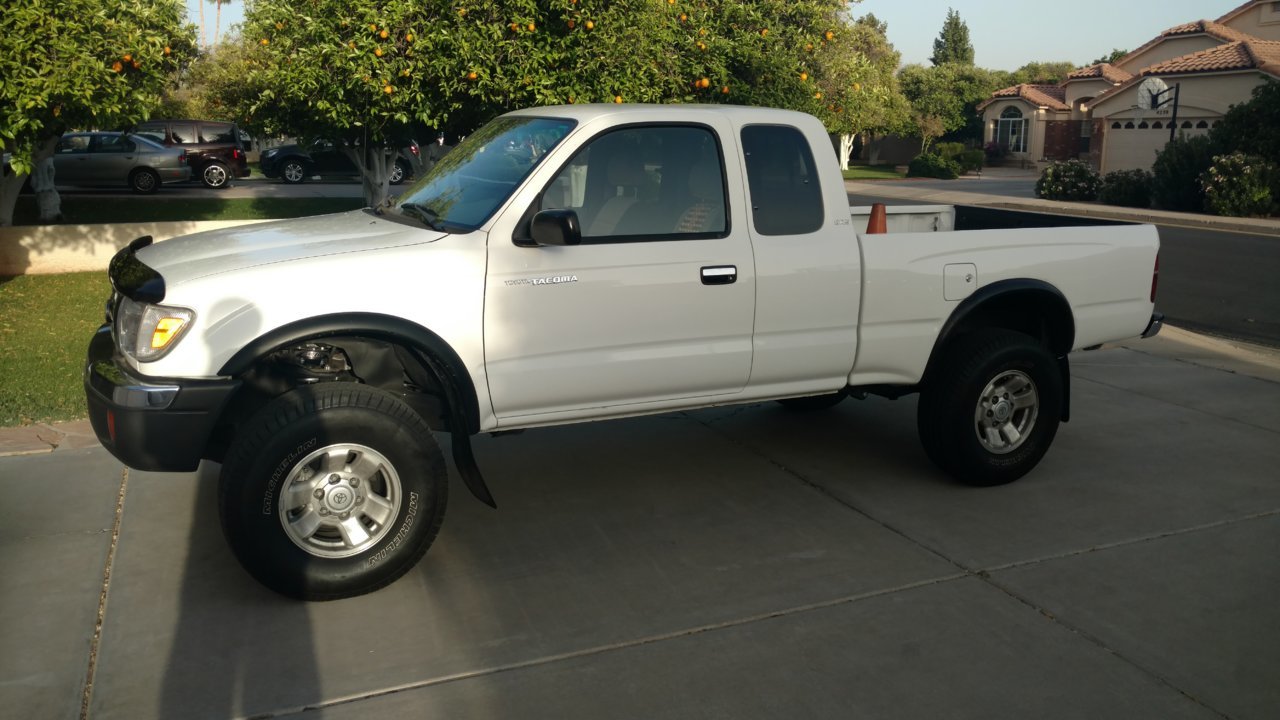

    I got my new springs installed today! Went with Deaver J59 leaf packs on the rear and Toytec Boss coilovers up front. I love the way the truck handles! No more body roll while cornering, just a solid, stable, confident ride. So much better than 19 year old tired suspension, should have done this 10 years ago. By my measure, I have about 2 inches of lift above the sagging old suspension, so probably 1.5" over stock height.
    How does this CV boot look to you all?

    Hahaha, well the fuzzies are still on these Michelins so I expect I have another 80,000 left on them. ;)

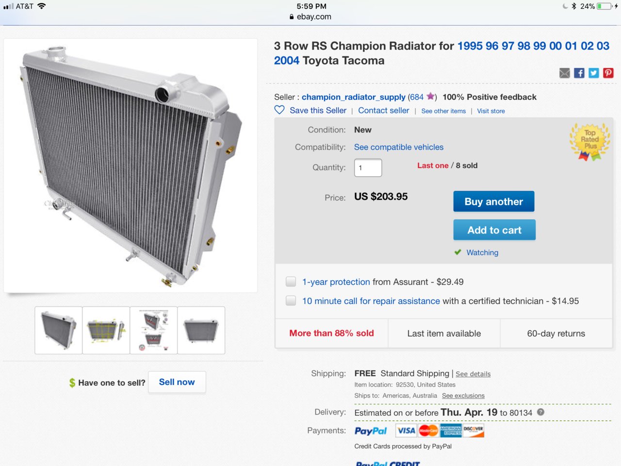

    It already looks like that from photos haha
    205 bucks shipped is what I just paid.
    It's a 3 core vs a 1 core. And is an all aluminum radiator. Really the only main issue with the stock one is the plastic top and bottom which can Crack due to age or lots of offroading. Don't have to worry about that with the champion one.
    Just stronger and more efficient.

    thats probably the cleanest first gen on tw.

    If you buy it off eBay from them the shipping is free, the website changes 35-45 for shipping.
    This is where I got mine and received it in 3days
