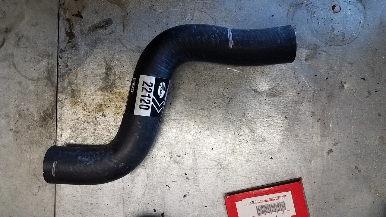

    The upper stock radiator hose works.
    You'll need an upper radiator hose off a 98 Dodge Neon (and trim it) for the lower hose.
    At least that's how I did it on my 6 cyl auto. (I basically trimmed it at the silver lines, here in the picture)

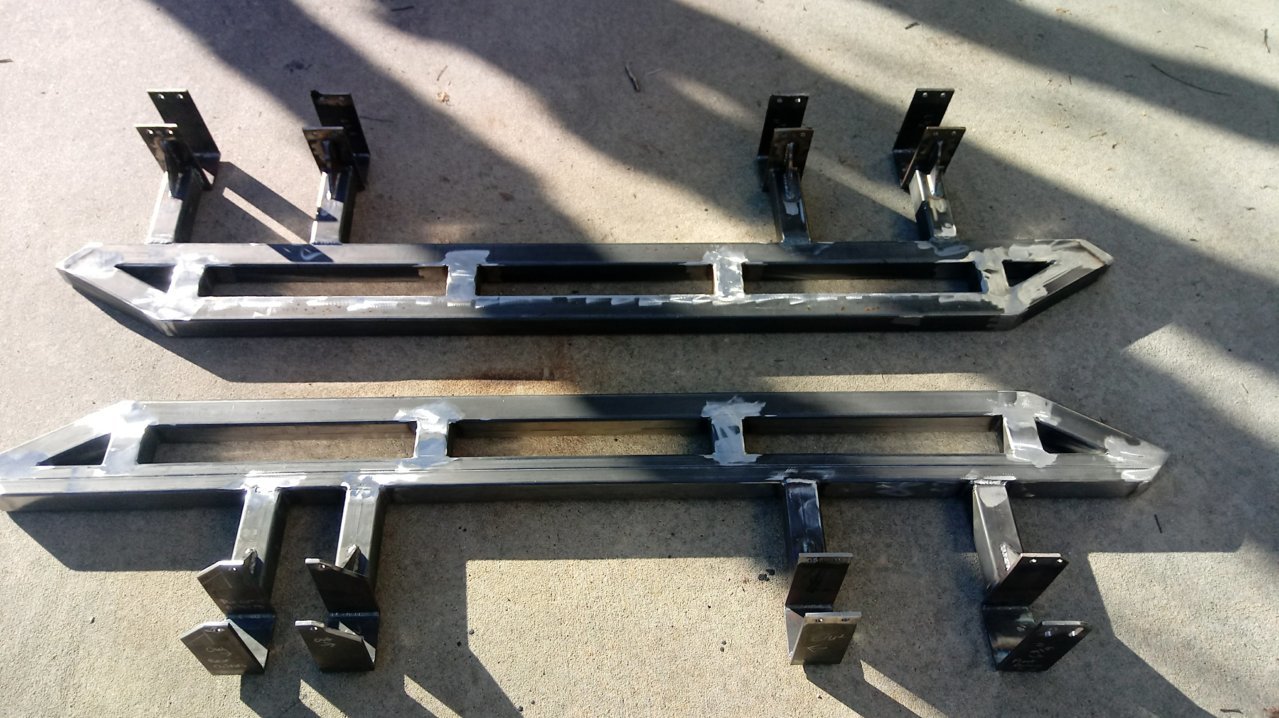

    Just curious... What size and thickness on the square stock?

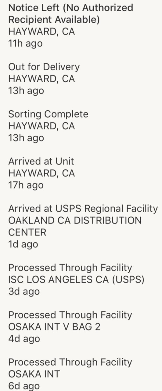

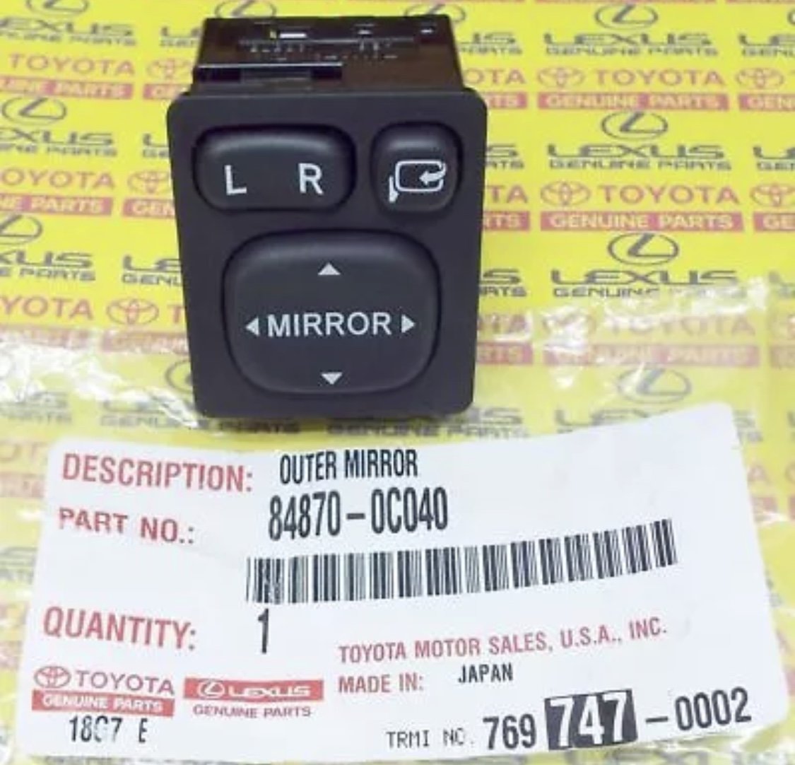

    I’m ready to install my heated 4Runner mirrors, just waiting on the JDM power folding mirror switch I ordered from Japan.
    I wish the power folding button would fold the mirrors, but they don’t. Instead they activate a timer relay to turn on the heating elements on the mirror glass.
    The switch is identical to the power mirror switch on about 90% of Toyota vehicles manufactured after 2001, in exception of the momentary button on the upper right that would usually power fold the mirrors on foreign Toyotas like the Hilux and Prado, and the Limited 2008+ Tundra domestically. Hard to find one here in the US so I had to go brand new JDM for this.
    Then I see the tracking and no one was around to accept it... :sadviolin:
    I could’ve installed a simple toggle switch but I’m extra and like going the extra mile to make everything clean.

    You need to find some mirrors from a Hilux Surf SSR-G, they are power folding.
