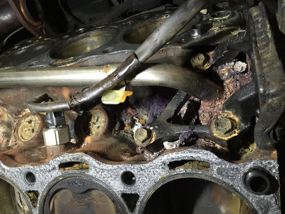

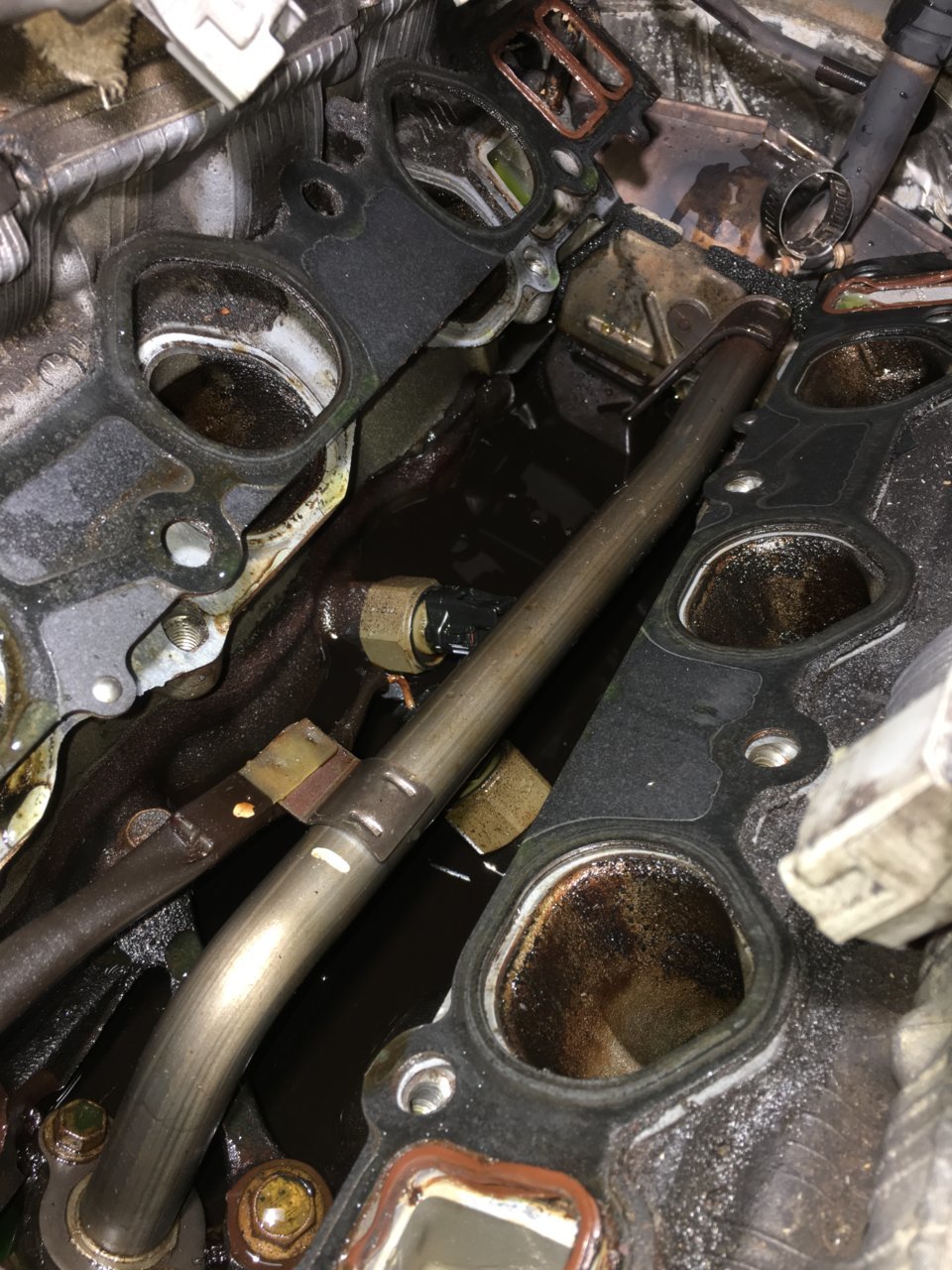

    Does anyone know how this would happen, since I bought the truck I've had this oil leak, and I replaced all the seals and stuff and still had the leak, I put UV dye in a couple days ago, followed the leak went up behind the trans, so today I pulled the transmission and followed it back to this divider under the intake manifold, so went into the engine bay and pulled the intake off, spilled a little coolant into the cylinders I think :annoyed:, but uncovered this mess :bananadead:.

    WOW yeah that is way bad.
    Kind of odd..should have lasted much longer than that. You beat on the rig a lot?
    is that oil or coolant?

    If that's oil its coming out from under head gasket from oil galley that feeds cylinder heads. I don't recall any oil galley plugs in that area. IMHO.

    The coolant pipe isn't uncommon to go bad there, but if thats oil, its most likely head gaskets.. i don't remember if there's any oil galley plugs in that area..

    It's pretty much all oil, the coolant that was in there was from when I pulled the intake out, So you guys thinking head gaskets :(

    That or a cracked block I guess.

    This isn't my truck but, what are these plugs for then?
    like by the knock sensors.

    the tube is a water pipe.
    The top freeze plugs..not sure. Never tore mine down that far. Clean yours up and check em out!

    the two sensors are the knock sensors. they pickup sound to detect pinging. don't go into the coolant or oil galleys.
