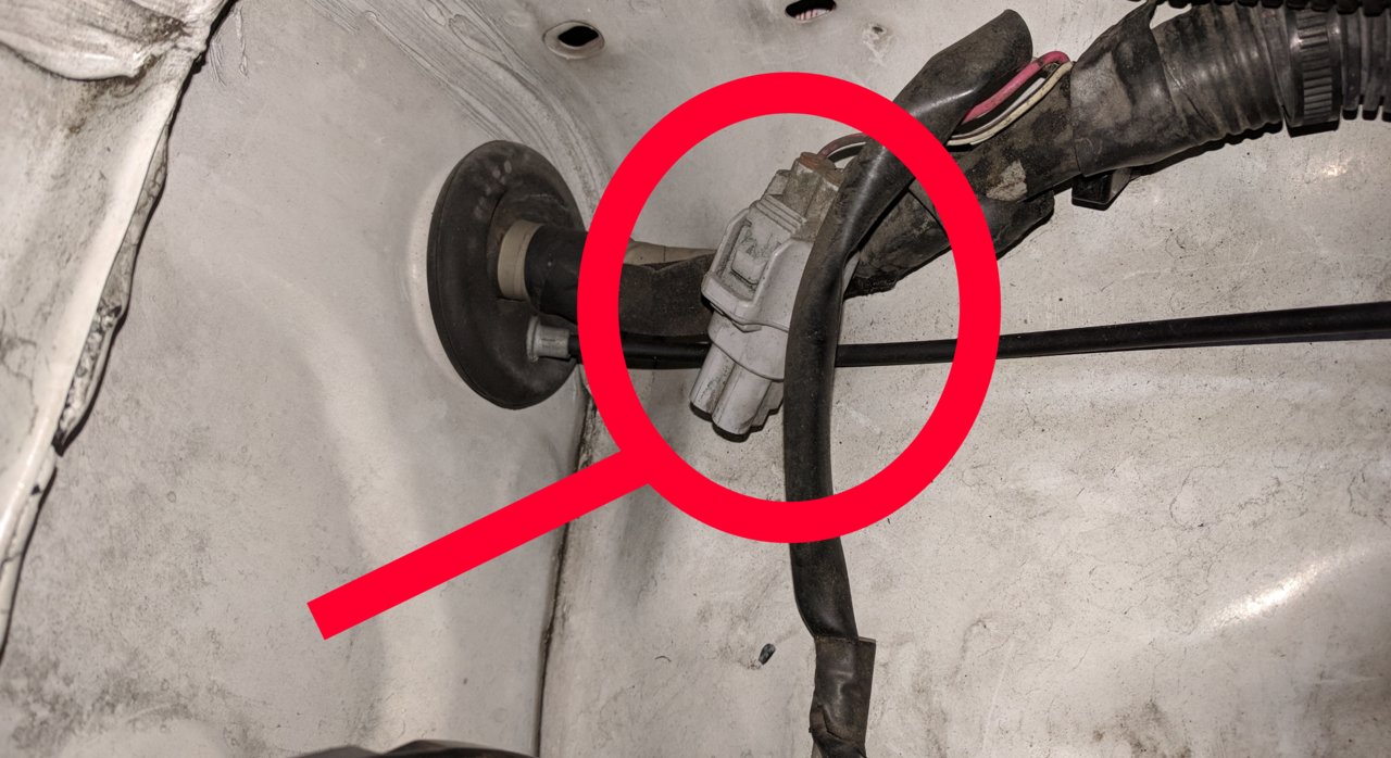

    Working on routing wiring through the firewall and just now noticed this unattached connector. It's plugged up so not used but does anyone know what it's for?? Thanks.

    Do you have ABS or Cruise Control? Tell me the wire colors and tracer colors and I can tell you what it's for.

    i have that wire too.. i look through the wiring diagrams and didn't find it (its there i just wasn't too worried about it). im assuming its something for abs though
