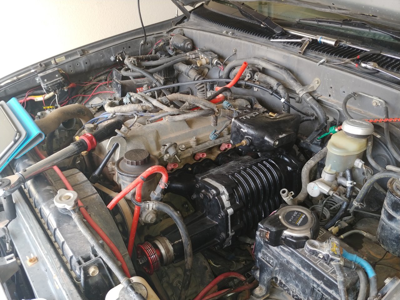

    Oh boy!! Sounds like the outer hub part swelled up. May have to pull the complete knuckle and press it out.

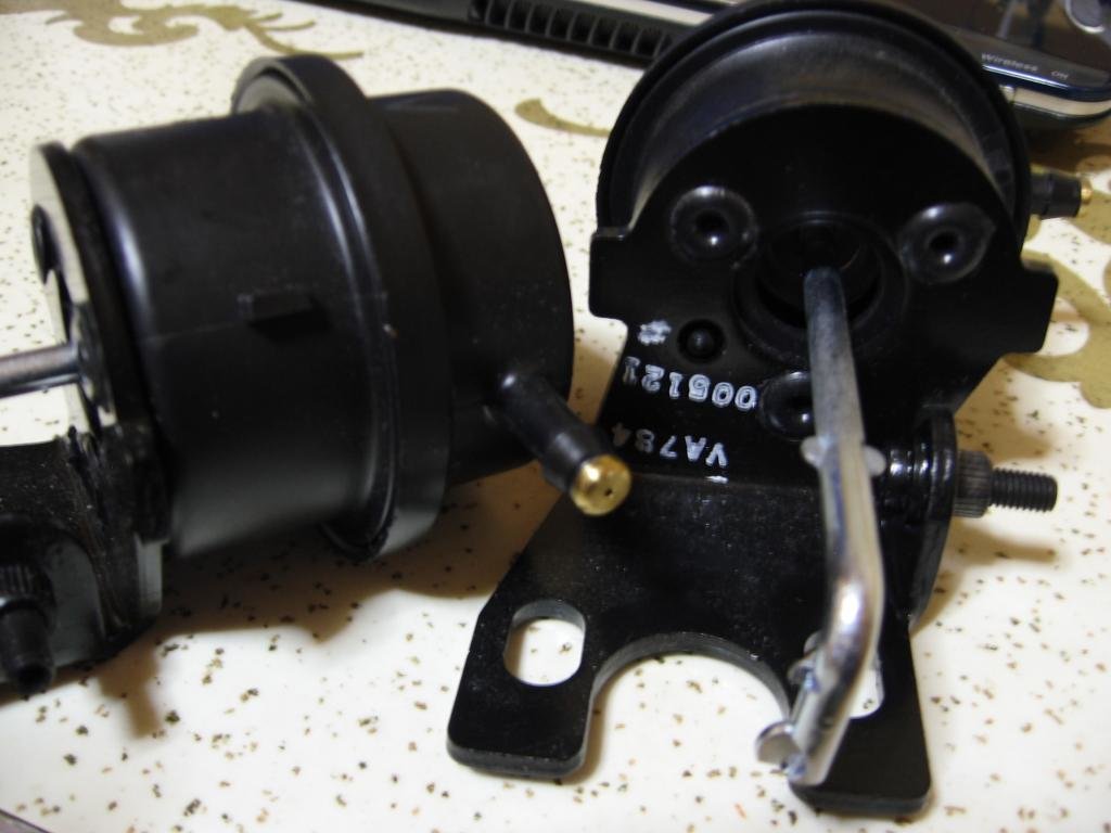

    yeah. Just a brass fitting. Will make the by pass valve open and close more suddenly vs smoothly.
    Kind of like an EBC vs a Manual one on a turbo setup.

    Yeah, hold the nipple and give the brass piece a little twist first to break off the glue that holds it in, then once it rotates you can pull it out. Be aware though that the boost will come on a bit earlier and with less throttle input so if you have fueling issues down low it may expose them.

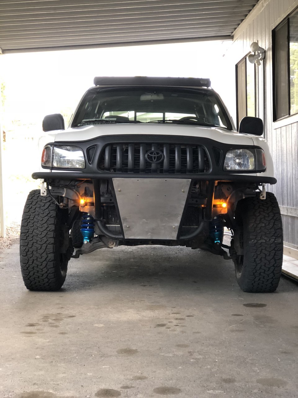

    Where you thinking about relocating the blinkers?

    My OEM LBJ with less then 20K on them and 28 months old are bad!!!!!!! Just checked them. Something ain't F'n right. Were did you get yours? Mine came from Camelback Toyota.

    Side lamps.

    Well I pulled the hose off and there was no brass fitting. I put on a new actuator not too long ago. When I just tap the throttle the thing moves almost instantly. Like if you blink you miss it.

    so....
    what were you complaining about earlier for? :p haha

    Is it in the hose, it has been known to come loose and get sucked into the hose a bit.

    Power. From idle-3.75 it seems marginal over stock. From 3.75-redline it's like hitting boost with a turbo. Ass end sits and the front lifts up.

    I don't remember seeing one on the new one, and I used a new hose. The other one was stretching a bit.

    Time for 1st Gen LBJ Recall Part Deux. I’m pretty sure he said his came from Camelback too...

    Hope not, I just replaced mine a couple months back through camelback. Will just have to keep checking em I guess

    Uhhh maybe I should check mine in the morning then... I put them on maybe 15k ago. They are also from Camelback. Hoping they are good as I can't afford to take that wallet hit lol

    I got mine from Camelback Toyota as well, I think in like December/January. I did them when I replaced my whole front end suspension. I'll have to check them out tomorrow and I'll lyk if there's any play. Will they replace if they're bad?

    @Blackdawg, I just learned something kind of interesting. The TRD installation manual (the actual TRD one not the one LCE doctored together out of old materials) shows a vacuum diagram where on 2RZs you boost reference the FPR. It doesn't show it on the 3RZ and it just occurred to me why. TRD only ever intended 4psi of boost and the stock 3RZ injectors can handle that no prob but the 2RZ has even smaller injectors than stock early 3RZ ones. So even Toyota recommends a boost reference when the boost goes up haha. I don't know why LCE removed that little tidbit (maybe to sell the extra injector kit they manufactured) but it is helpful to have an exact diagram for the whole system.

    You get a one year warranty, I should check mine I come up on a year in a few days
